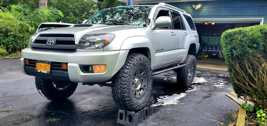

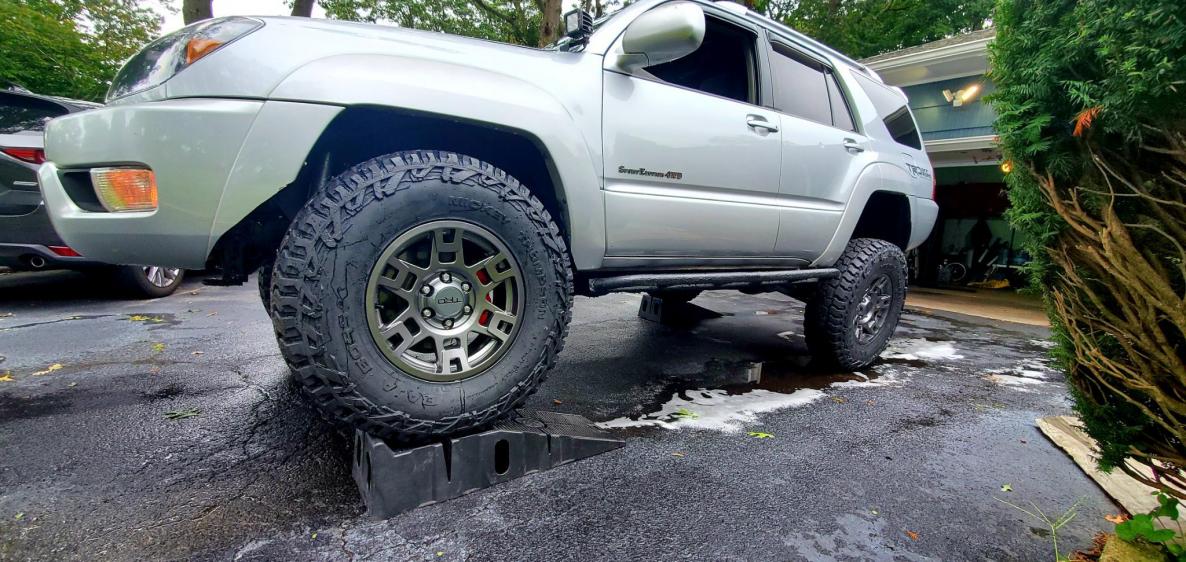

**35's on a 4th Gen - The Fitment Guide**

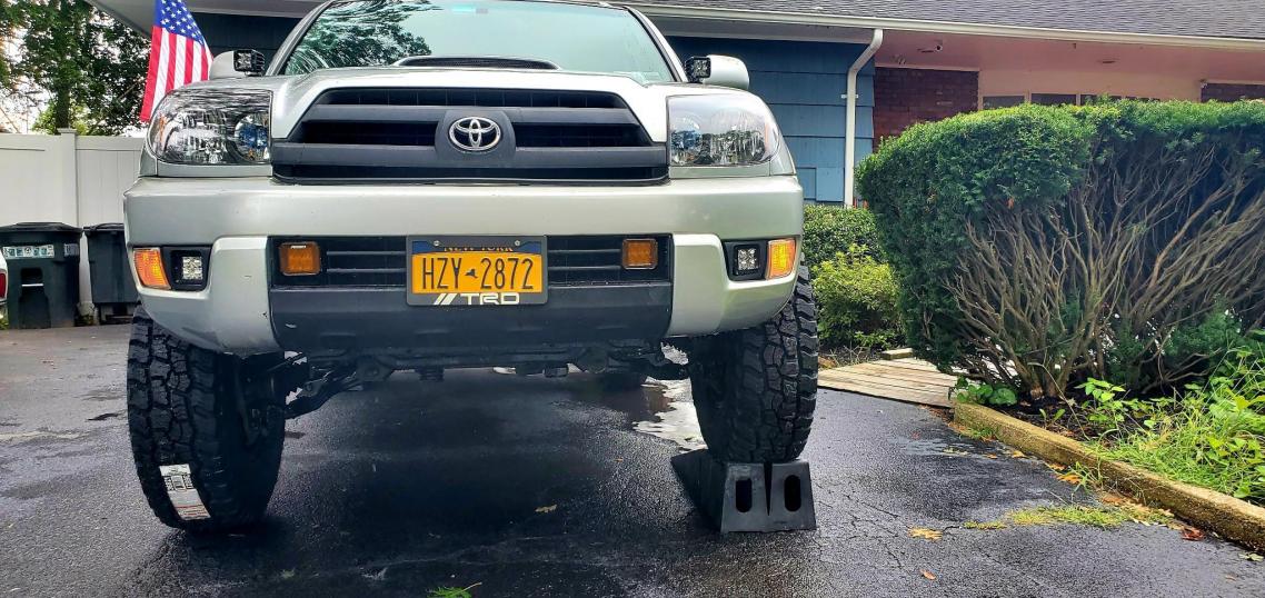

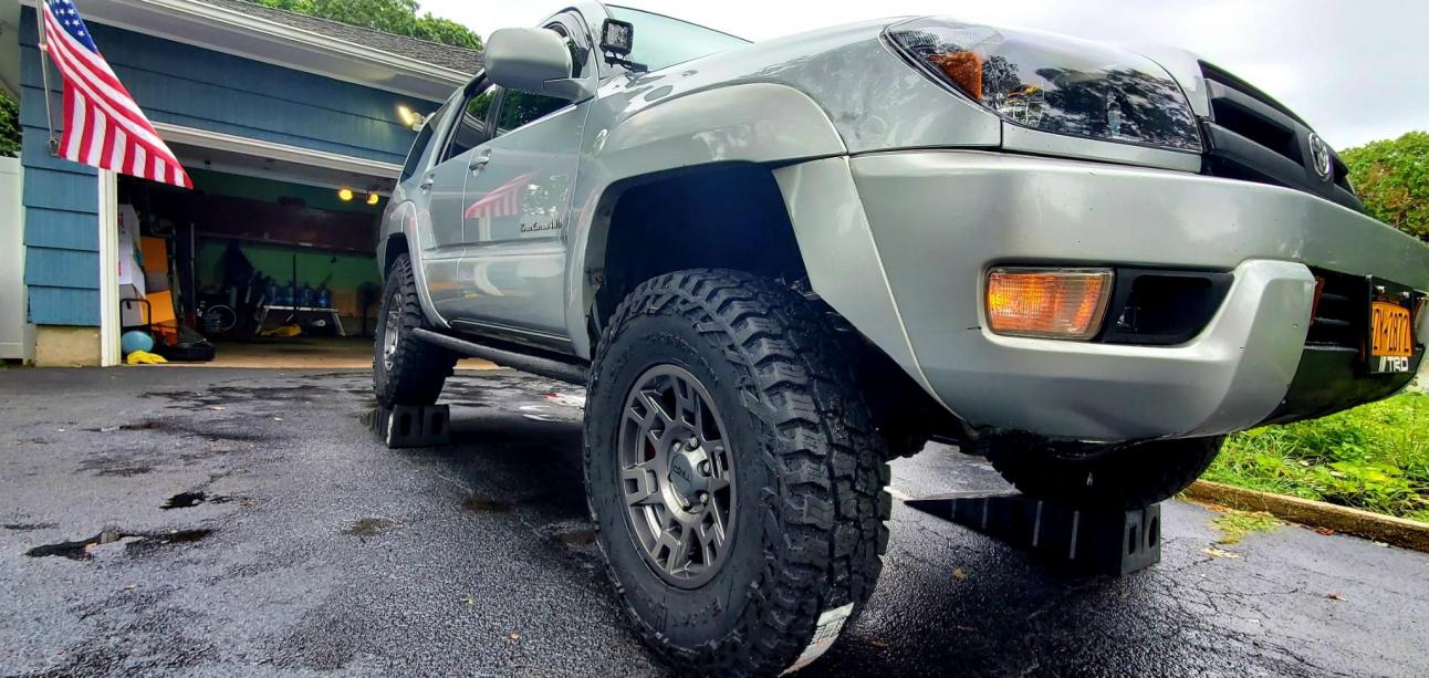

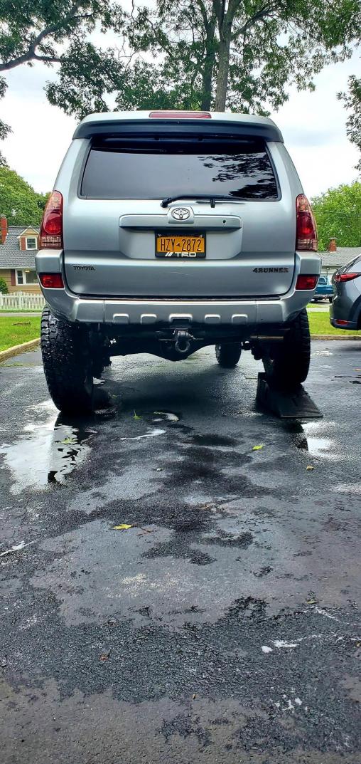

Well, .... This 4runner is now on 35's @162k
Thanks to everyone that contributed to this thread to help make this happen.
255/85R17 =35x10R17
Mickey Thompson Baja Boss AT's
Genuine TRD SEMA edition Gloss gunmetal wheels
  • Dobinson IMS w/ Rear Long Travel 3" Lift
  • C59-352 Front Coils
  • C59-701v Rear Coils
  • SPC UCAs
  • Yoko Geolander 35x12.5R17
  • PCK
  • No Sways
  • BMC (probably not aggressive enough)
  • lots of other trimming to rear of front wheel well
  • i still rub at full stuff on the rear, but not enough to really bother me
  • SPC UCAs
  • PCK
  • No Sways

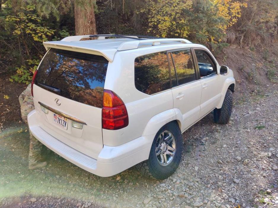

you get an appropriately sized bump stop extension unless you want your inner fender/door to be your limiting factor lol.
I made a custom 2" drop bracket from some rectangular tubing and mounted the factory bump stop to it. Mine also rubs similarly when fully on the bump stop but only enough to scuff the coastal offroad rear bumper and the inside of the door a little.

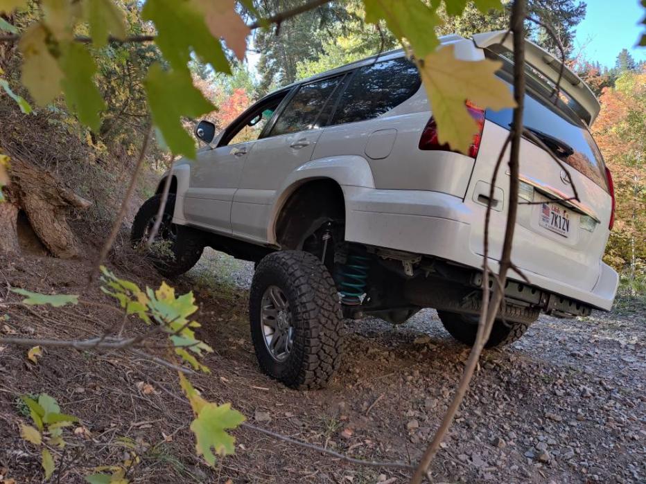

[MENTION=140396]TLar25[/MENTION] this is what mine extensions and up travel looks like.
Very nice, I'm thinking of getting the Apache off-road spacers, and eventually durobump's or timbren's for my GX.
This was probably not good for my shocks I'm sureIMG_20211001_115848.jpgIMG_20211001_115910.jpg
Sent from my KB2007 using Tapatalk

as another said, you get a bump stop extension. it still rubbed the tiniest bit on the rear, but it self-tubbed after a few days on the trail.
Did you cut off the bottom half of the bumper? Ive been debating this bc off road bumpers are so expensive
Yup, maybe a little more than half [emoji28] trimmed the front bumper as well. I've seen a few people trim the rear bumper on 4th gens as well, but it's not super common for some reason. Mine just got hit a few weeks ago so I'm running without the drivers side cap currently. Really makes it more obvious that I need to do some rust removal/treatment [emoji51]

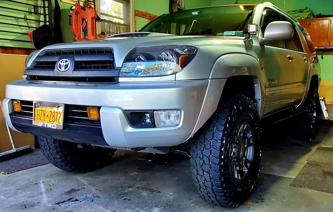

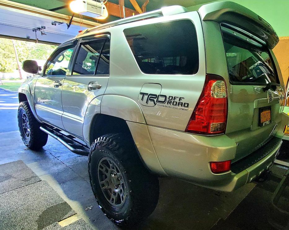

Well, my complete build list broken down by section is in my Build page on my signature here.
in short, it's a 3-inch lift, no body lift, front and rear bump stops, and lots of trimming. It drives down the road fine, dirt trail no problem... if I got into any rock crawling/extreme flexing situation there would certainly be rubbing.
A lot of the rubbing is on the rear side of the wheel well and body mounts even with trimming. What would help is SPC adjustable control arms that could push the entire wheel assembly forward and then adjust from there, however, I'm not sold on longevity or quality over JBA's. my own opinion from my own observations.
Outside of that specific scenario, these tires have so far been fantastic. Looking forward to some Winter wheeling in the next few weeks ill be doing up in maine.
