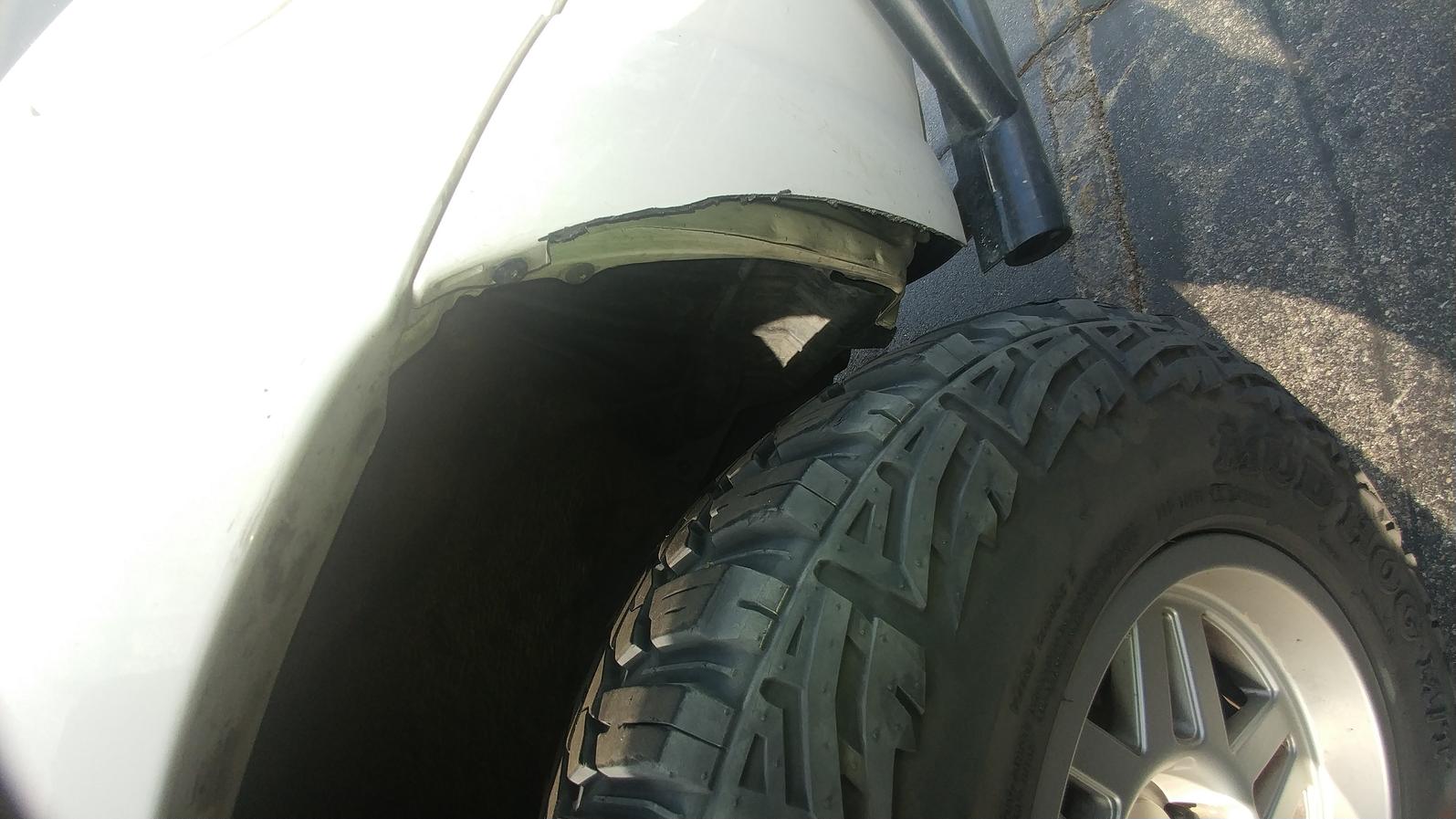

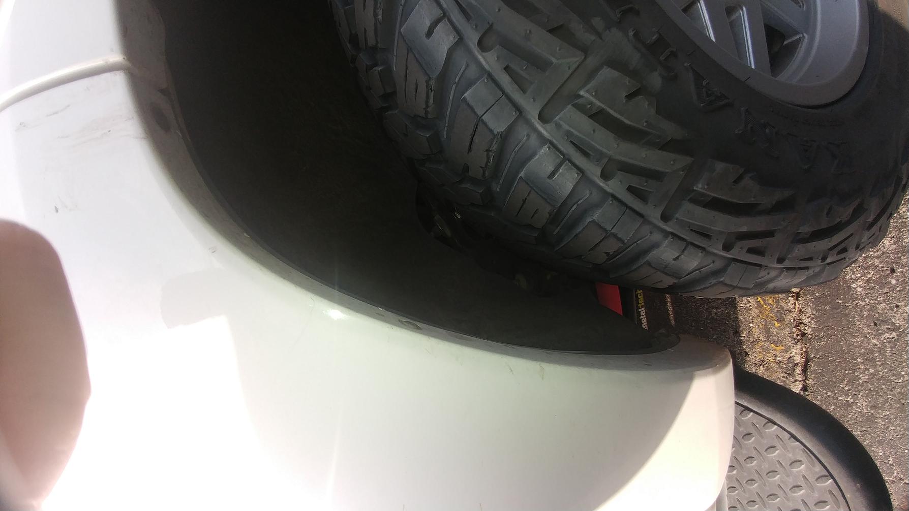

Tire Size & Make: 315/70/17 Cooper STMAXX
Wheels: Method Race Wheels - Standards - 17x8.5 0 offset
Bodylift: None
Approx. Suspension lift setting over stock: 3" over stock. King extended coilover w/resi up front. Rear is Metal Tech LT 2" rear springs with 10" King Bypasses with resi.
Aftermarket UCA's: Total Chaos UCA & LCAs
Caster correction: Currently at 4.8*
Bumpers: Custom tube bumper
Trimming: rear bumper plastic expansion cut with a body mount chop as well as a flattened pinch weld.
Bumpstop drop?: 1 3/4" rear bumpstop drop, as well as front. Both front and rear have Wheelers Off-Road "Super Bump" Bump Stops
Notes: I only rub on my corner of my body at the body mount chop corner when my alignment is off and/or below 4* caster. No rubbing in the rear.
Bodylift: None

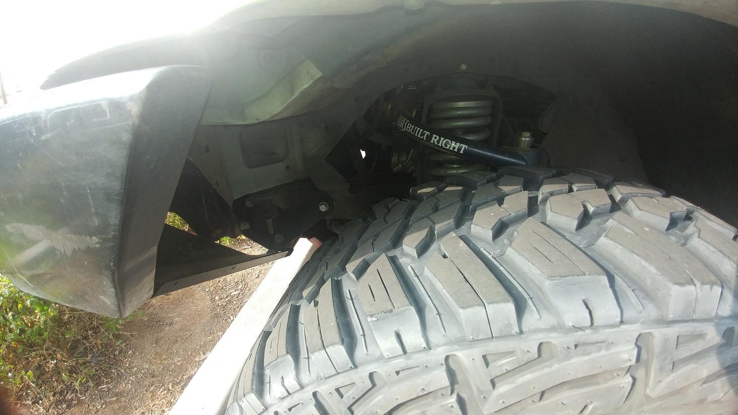

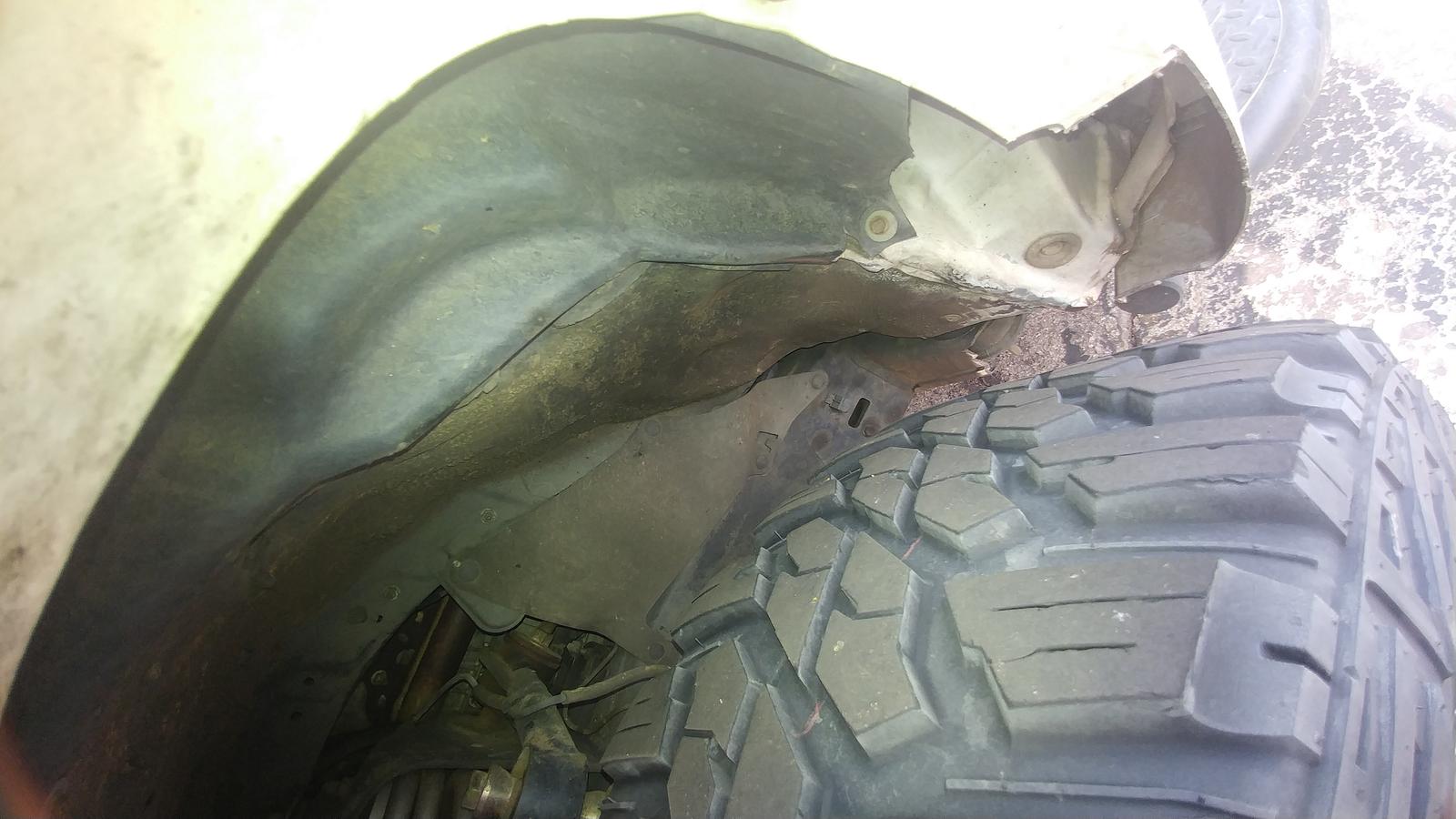

Tire Size: 35x12.50r17
Tire Make/Model: Toyo Open Country MT
Wheels: Stock OEM Wheels
Bodylift: Yes. Roger Brown 1.5"
Approx. Suspension lift setting over stock: I don't have numbers without my BL. But measurements from center of wheel to top of fender are:
Front: 26"
Rear: 25.75"
Aftermarket UCA's: Camburg UCA with Moog Ball Joints
Caster correction: Don't have numbers. Should have within 2 weeks
Bumpers: Front Perkins Bumper and Rear custom built bumper.
Trimming: Body Mount chop. Rear of Front Fenders. XREAS lines on frame
Bumpstop drop? Currently not running bump stop extenstions. Only have OEM
Notes: I rub very little at full lock on my frame. Aftermarket CV's seemed to not carry the 35's as well as OEM.

This look trimmed enough? Either way, seems like I've got my next project.
Thanks!
