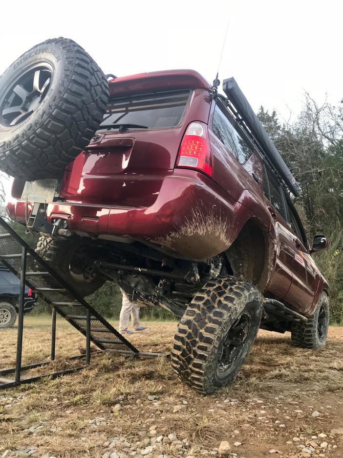

Very happy with the 35's
Logged a little over 4000 miles on them in the last week and finished off in Moab. Gonna do a little write up on that adventure. Here's a couple pics from Kane Creek
Might I add all by standers were JKU owners
