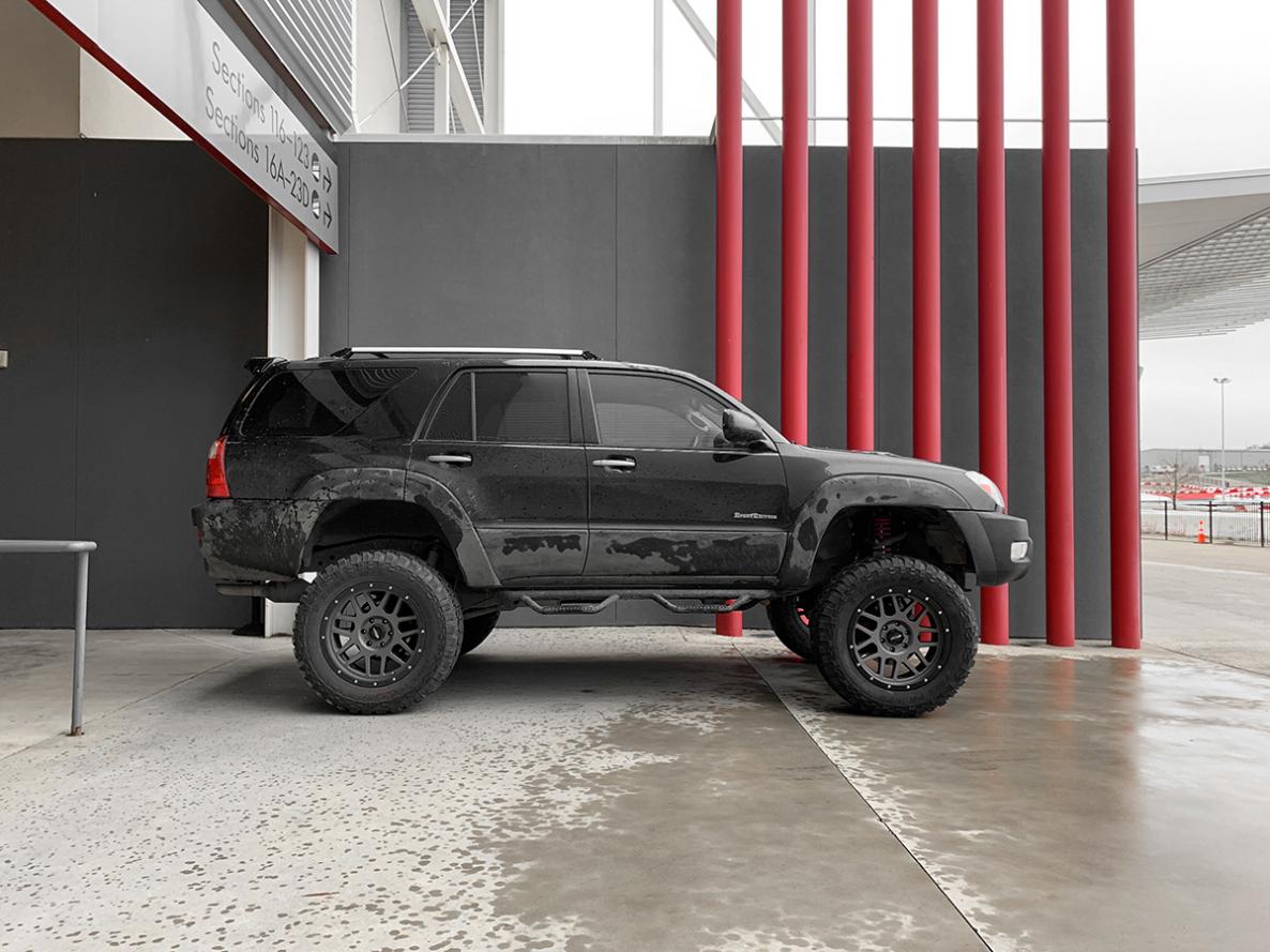

Alright I did it, I stuck some 35x12.50 nitto ridge grapplers on my 4runner. Did the body mount chop before I took it in and, big surprise, needs more chop.
But then there's the real problem. My wheels are grinding the hell out of my calipers. I have the right wheel specs but the way these wheels are made makes them very inconvenient on stock brakes.
I guess I could go to the parts store and grab some 5mm spacers and call it good, but I don't like that option very much. I know the problem will sort itself out in a few miles but it makes some God awful sounds when I hit the brake pedal. Just how much extra metal is in those callipers anyway?
Ill be giving rr-racing a call in the morning about a brake kit. Is anybody running the bigger brakes on steelies?
I thought someone else was using pro comps with their 35s but now I can't find that post.
Pro comp 97 series 17x9 4.25" backspace (4.5" is -12mm offset so I'm close to -19.) MAJOR PROBLEM these pro comps will destroy your front calipers, temporary solution is a 1/4" wheel spacer for the front two wheels. Hoping the big brake kit pushes the callipers out enough to remove the spacers.
3.2" front lift, 3.5" rear
SPC UCA'S
No body lift
Body mount chop in progress.
Pinch weld hammered flat
2" toytec bump stop drop (not installed yet, need bolts)
Rear sway bar delete
Front sway bar factory specs with relocate kit, no more rubbing issues

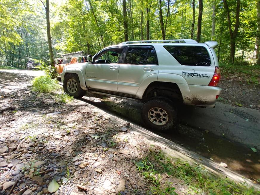

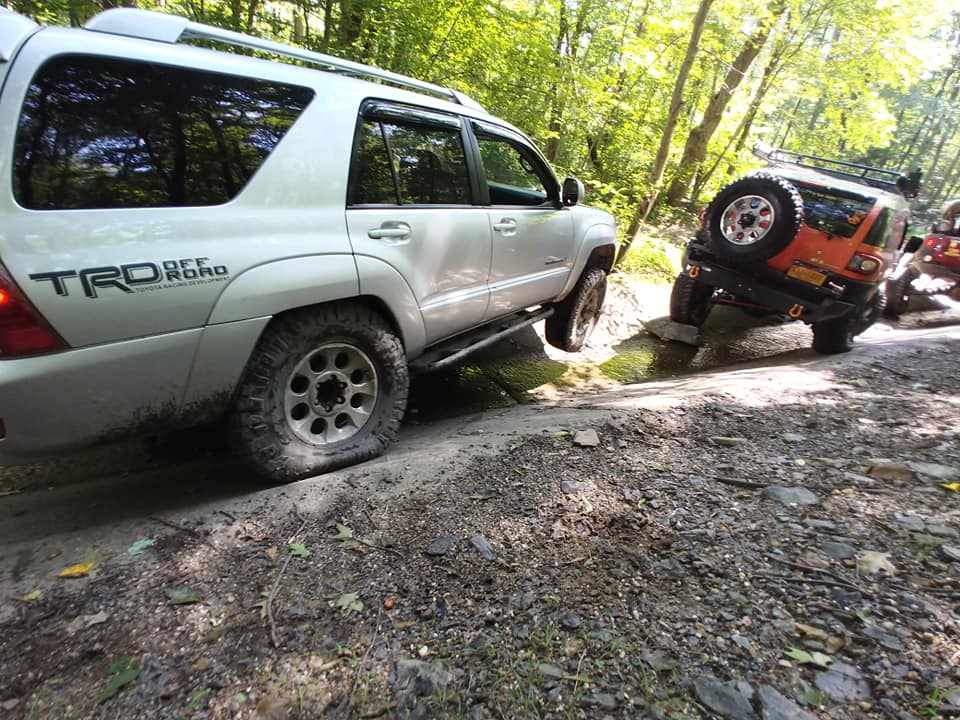

Just read this entire thread again because 35s are the new 33 and im starting to consider preparations to make the jump from 285/75/17 (34)s to 35 on a daily driven and also wheeled a few times a year. v8 4runner.
Dont have a BL, Still have oem gearing, I Have rear bump extensions, prepared do do more cutting. Will I regret this decision? lol
So frikin true. And 37's are the new 35's. My 35's are starting to look small to me.
I have an 05' V8, daily driven with 35's stock gears, no problems whatsoever. I do have a 1.5" BL so that made things easier cutting-wise. Still plenty of power, just don't use the cruise control, so the only real consideration is trimming/clearance IMO.
I just regeared to 4.88's and I'm still in my break-in period. But I touched half throttle from 10-30mph and it felt goooood. Almost seems like it shifts faster too. Once the diffs are broken in and I turn my sprint booster back on I expect warp speed. Honestly it was fine with stock gears, but I needed the lockers so might as well.
I appreciate the encouraging words, My wallet doesn't, But I do lol. Im willing to cut a decent amount to make it work. Ive already chopped a bunch to make what I have flex. I may do a body lift down the road but im not in a rush for it. Your new drive line setup is basically my inspiration if I can ever put aside enough truck parts money.
I think the biggest fear is that 35's is the tipping point for the stock drive line and im gonna be grenadeing my diffs. Im pretty careful and not hard on it when wheeling but thats an expensive risk to take for 1 inch of tire.
