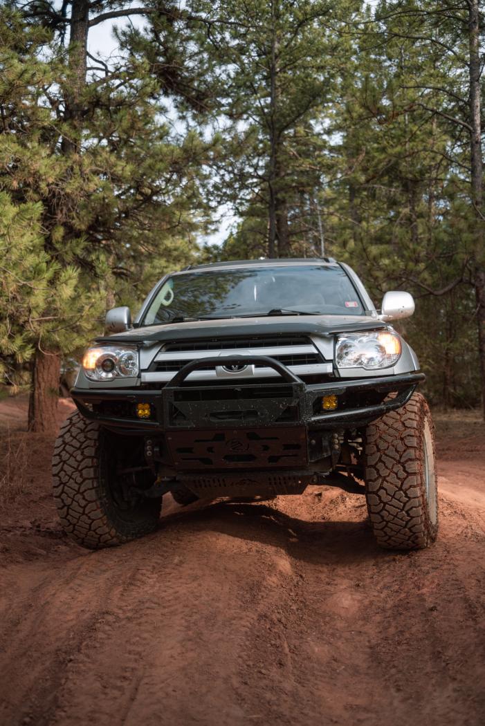

**35's on a 4th Gen - The Fitment Guide**
Tire Size: 35x12.5x17
Tire Make/Model: Kenda Klever R/t
Wheels: 17x8.5 et 0 1.25” spacer
Bodylift: no
Approx. Suspension lift setting over stock: 3” front probably 2-5-2.75” rear
Aftermarket UCA's: SPC uppers
Caster correction: 2.9 degrees
Bumpers: Lil b’s hybrid
Trimming: body mount, rear bumper, lower quarter
Bumpstop drop? Metaltech rear, Duro bumps front
Notes: Which i went 35” sooner, matches the 4.88’s. No rubbing anywhere except for the rear bumper at full stuff.
Biggest pain-point with running 35's on the 4th Gen? Clearance and gusset you’re spindles.
Running stock length Rockmen lowers links.

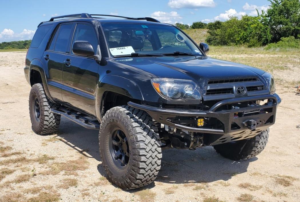

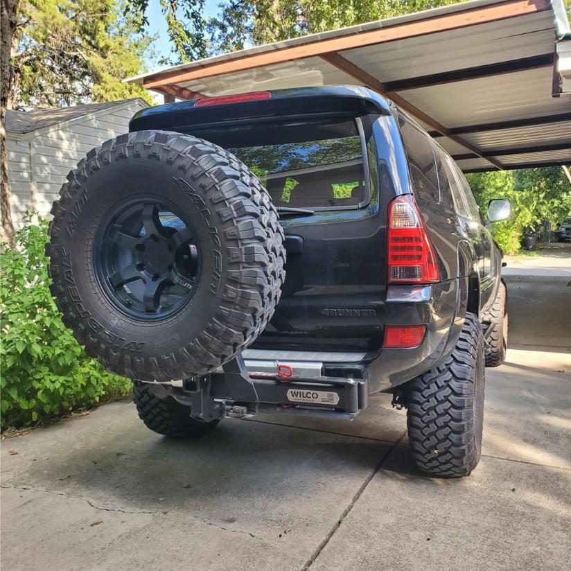

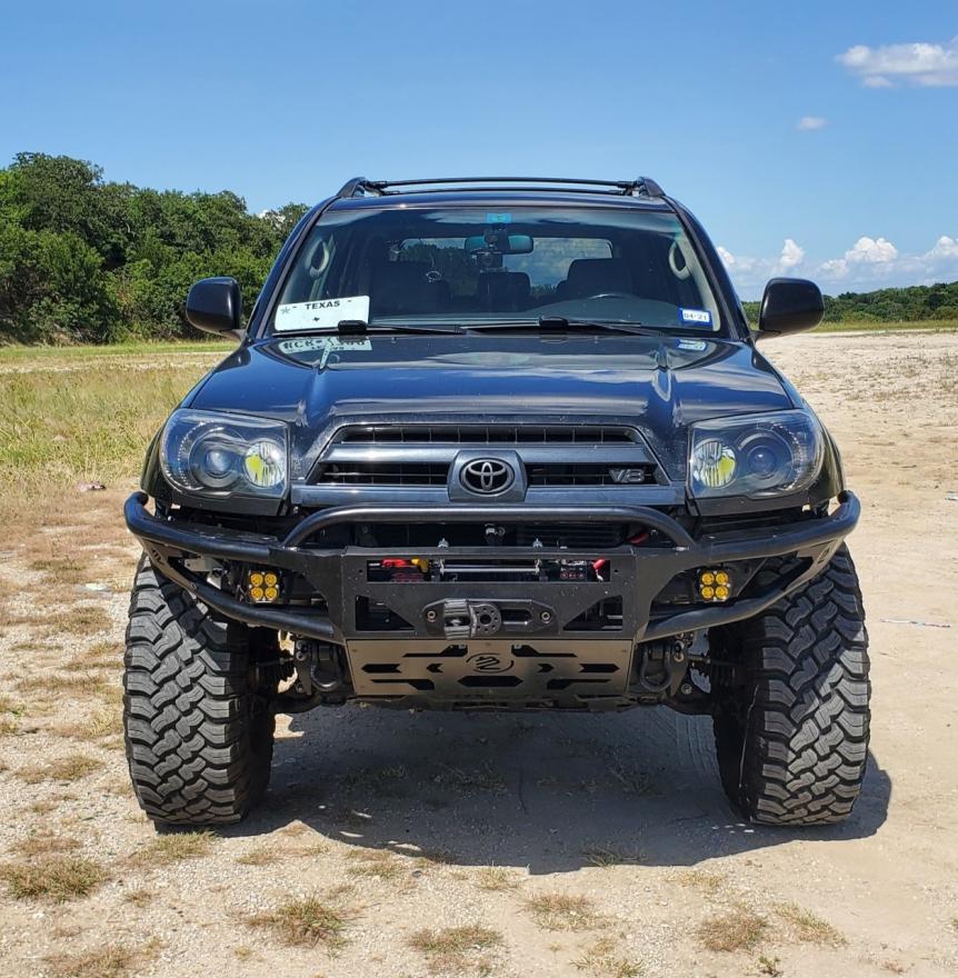

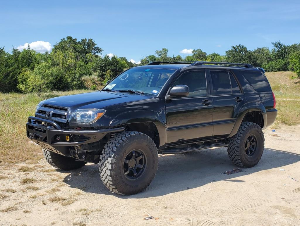

Tire Size: 315/75R16
Tire Make/Model: Falken Wildpeak M/T
Wheels: Motegi MR150 16X8 +0 4.5 backspacking
Bodylift: 1"
Approx. Suspension lift setting over stock: 3"
Aftermarket UCA's: SPC UCA
Caster correction: ~2.5 degrees
Bumpers: Lil B's Hybrid Front Bumper
Trimming: BMC, pinch welds, rear bumper
Bumpstop drop? 2" rear bump stops, stock front
Notes: V8 and stock gearing, Radflo 2.5 front coilovers and Dobinsons Long Travel in the rear, removed front sway bar
Does it still rub at full compression? Rubs fender flare at full compression, need to trim that.
Any issues? Tires rub frame at full lock and tire is extremely close to the UCA.
Anything you would do differently? Only thing different I would do differently is get lower offset wheels and higher rated front springs. Possibly re-gear later on.
Biggest pain-point with running 35's on the 4th Gen? Getting discount tire to correctly balance my tires after 3 different balances.
Are your links extended to push the axle further rearwards? Front Range Offroad Lower Link Kit and panhard bar
