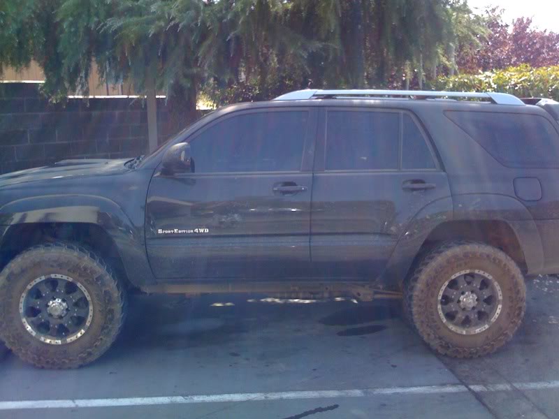

OME 3" (3.5" actual) plus a Roger Brown 1.5" body lift and UCA's. Trimming of the front body mounts and all fenders and hammering the pinch welds flat. It honestly sounds harder than it is... keep in mind that I had to cut my sliders in the photo below as well because they were too long.
