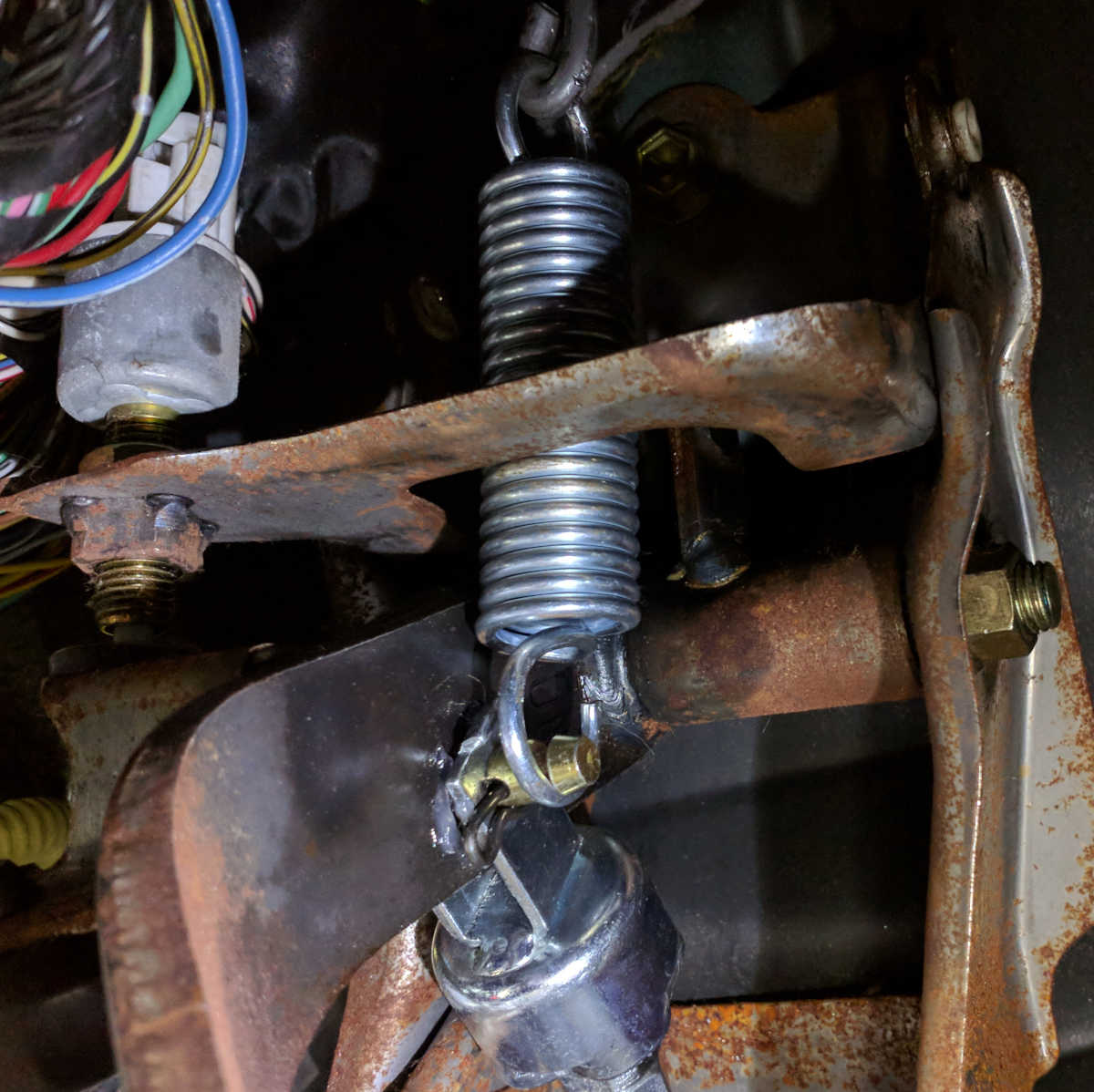

in terms of length, the spring i ended up with is about 3-1/2" long and about 3/8" coil diameter. i wish i had the PN but i do recall they had a couple available as kind of off-the-shelf all-purpose springs, and this one had the lower rating (as in pounds to pull). the ones i got from home despot were 40 lb, and that is way too much. if you get up under the dash with a good floody light, you can probably spot a body panel that has a convenient hole stamped in it. i used that, but its alignment with the pin on the pedal isn't ideal, which is why the strumming. it grazes another bit of body panel. you can measure the distance from that hole to the pin. the first springs (the HD ones) i got were shorter and stout, and i ended up making a linkage out of some round mild steel rod. the second (current) spring was a little longer, which is good, and i could shorten the linkage quite a bit.
if you go to napa or a hardware store to find a spring, one test of fitness for purpose is that you can hold it at the end and bend it somewhat with one finger. if it's too stiff to do that, it's too stiff for this use case. if it's really bendy and you can easily bend it 90°, that's too soft.
my wife drove the 4R today to work, or i'd have taken a photo of it for you. i can get you one later if you'd like.
here's the first spring i tried (home depot purchase), the one that was too stout.

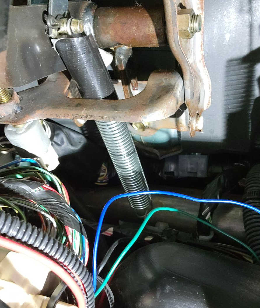

glad to help. here's the new spring in place. this entirely replaces the U-shaped torsion bar spring that's normally in there; follow other instructions for full removal of it. might add some fashionable duct tape like this to keep the strumming to a dull roar. you can see the difference in wire diameter compared to the first one. this is ~half of the first try. see what your local parts store has. this one was long enough that i could take out the hook i used for the other one. i had to remind myself all it has to do is pull the pedal back up to the up position.
