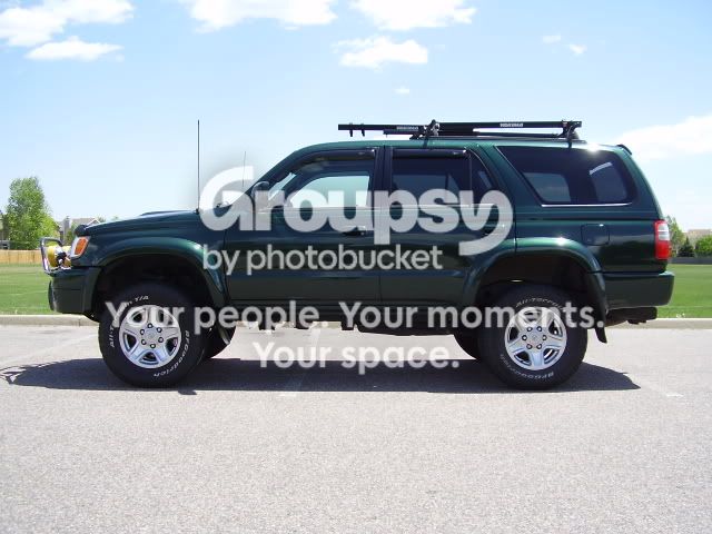

This is Tundra TRD front coils (~2.25") and OME 891 rear (~3"). Tires are BFG AT 265?70-16 (30.7")
P5120026.jpg~original

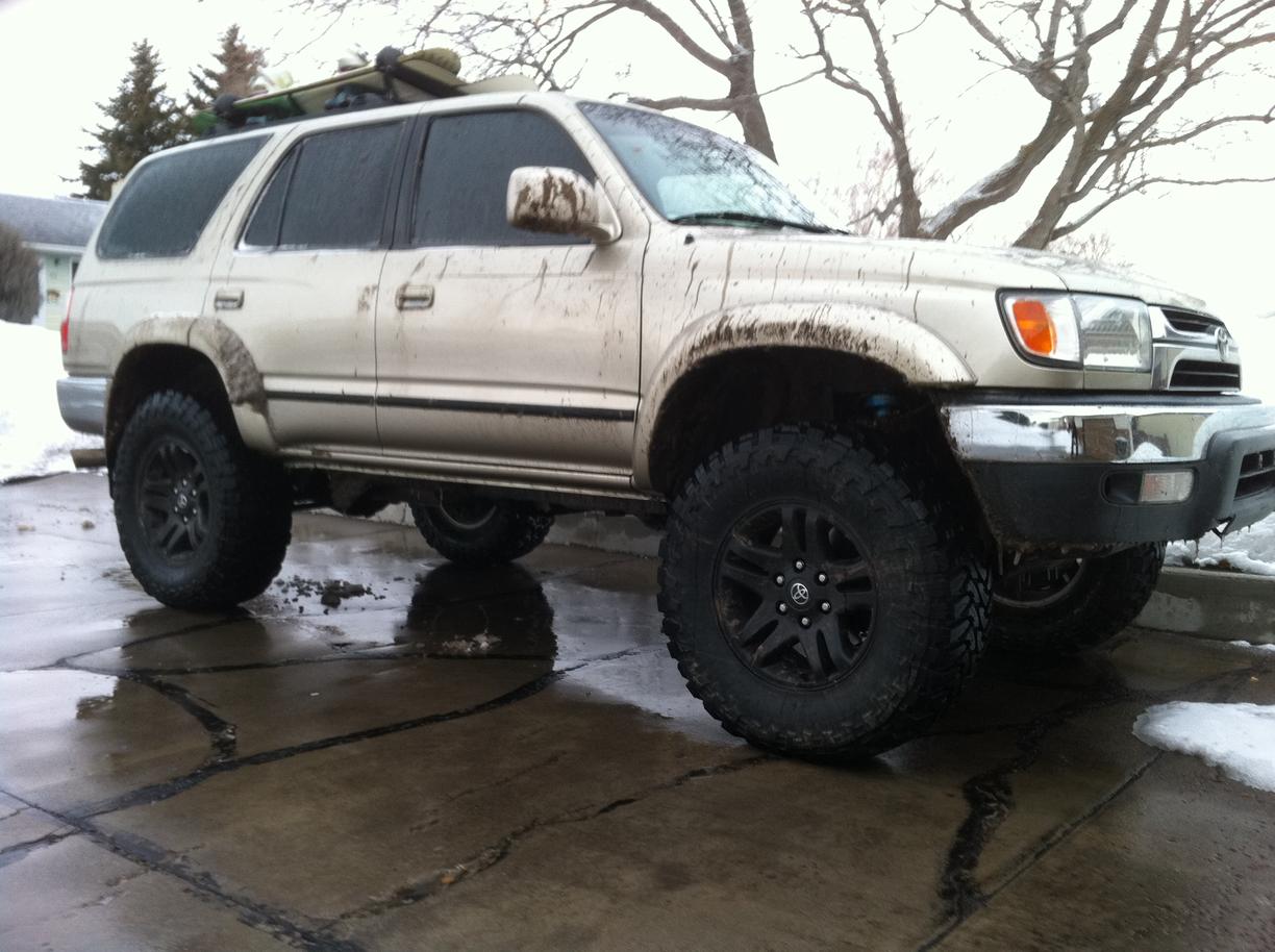

I'm running 295/70/17's with 3.5" lift in front and 4" in the rear, i rub BADLY in the rear any time i off road, and that is barely flexing, i would recommend 285's if your just doing a 3" lift, ill defiantly go smaller on my tires next time or ill add a 1.5-2" BL
