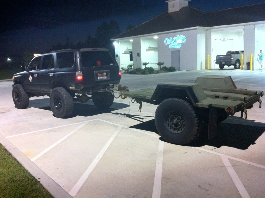

Stay away from the HMMWV tires. They're a ***** to balance. Went through two wheel bearings before I said f it and took them off.

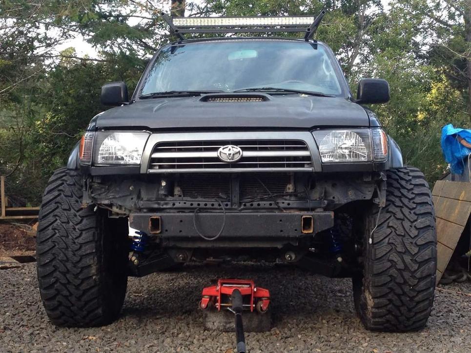

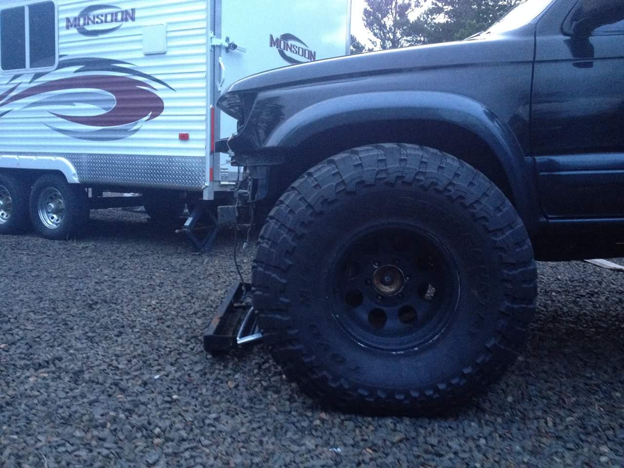

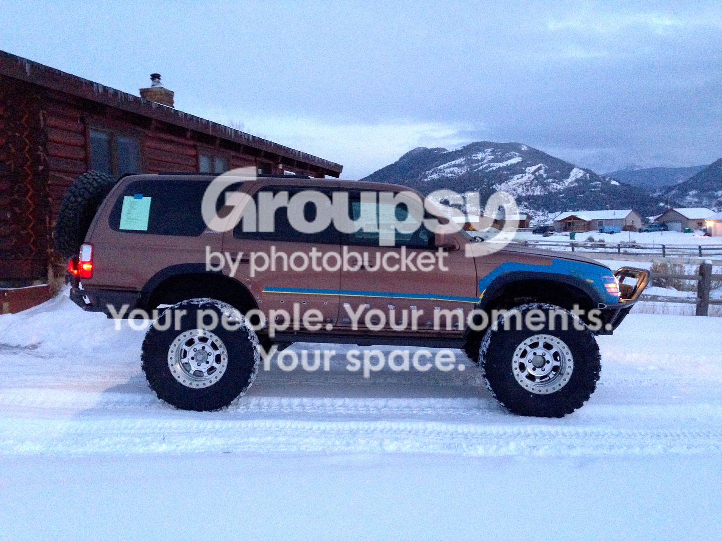

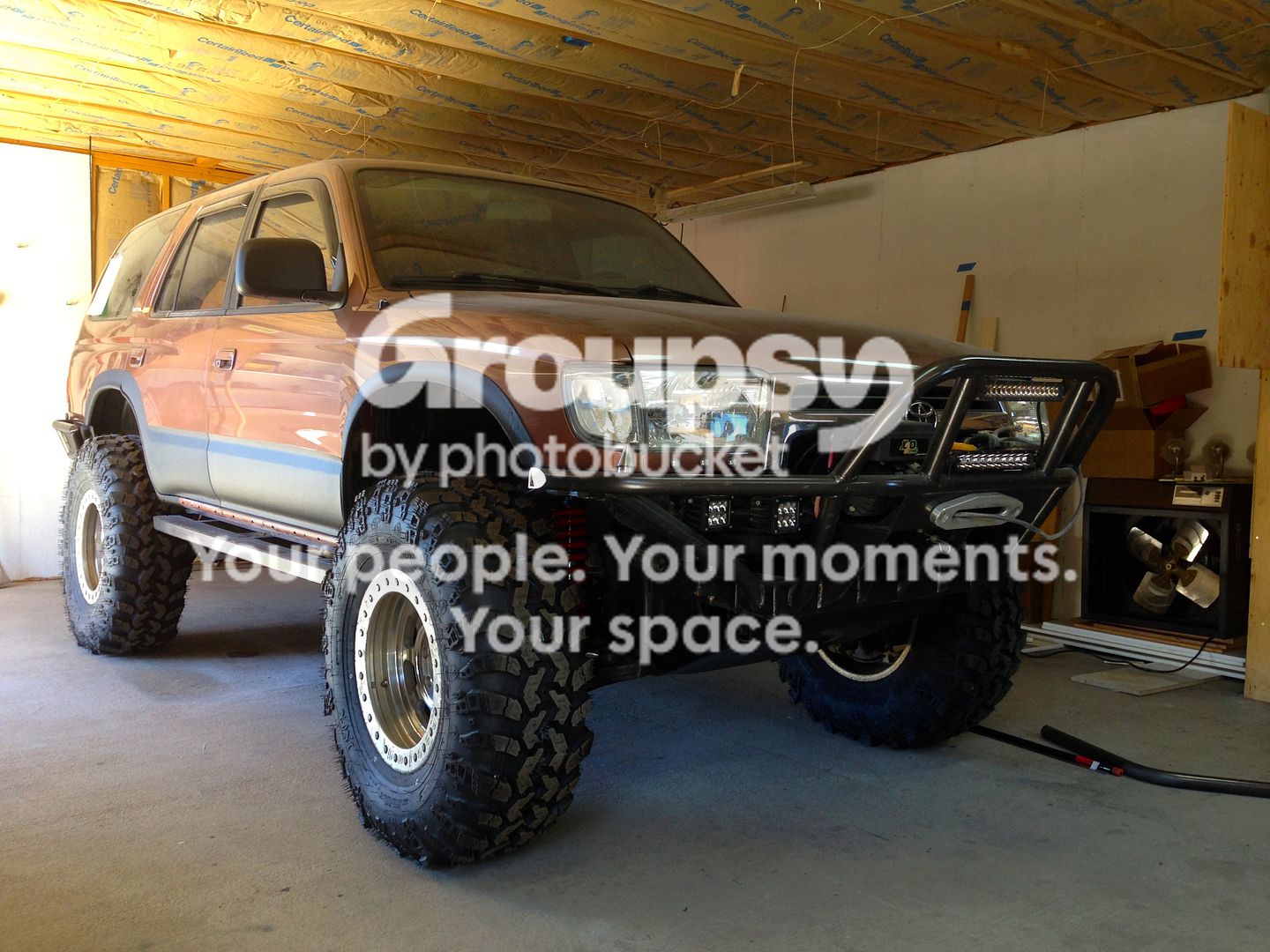

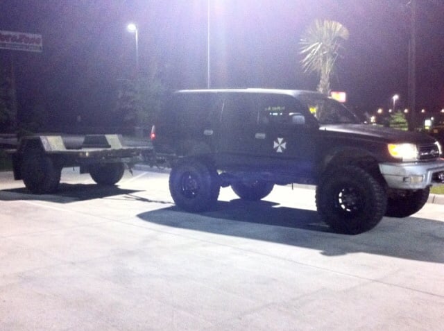

Here's the pics off fb.
And I wheel plenty, I have a pretty good start to a sas but the more I think about it I want to build a early bronco and the runner will be my expo/dd/weekend bug out rig. So I think the ifs is going to stay.

Well that can't be wheeled, Zero upward travel available. Shoot I don't know if you could even make a turn with that thing!
:rolleyes:
I doubt that it is at ride height, and who needs up travel? He'll I came from a rig with 2" of up travel because I didn't want to jack my truck sky high. Now I know it defeats the purpose of the usual use of long travel but if he limited the up travel and and kept the ride height low he would have tons of drop. Or is my thinking wrong?

It's not my truck? I said I wheel I didn't say the guy building that truck did. And honestly I would stick with a 35/37. Most the trails around here are build for rigs like that. However more and more jk's and jeeps in general on 40s and toyota on 40s are making the trails less desirable in the smaller tire packages..

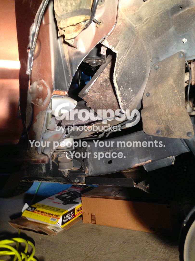

As far as making clearance I have the shop and some awesome friends who could help knock out a dirtco look.

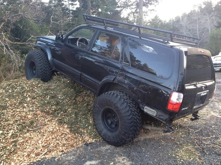

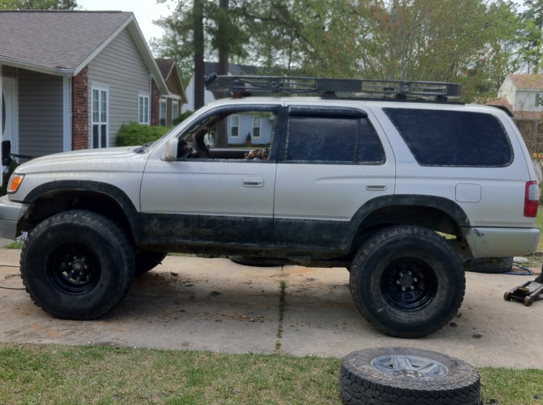

that runner is being built for snow and deep snow... that looks like one of those icelandic trucks. yeah guys around here are all going to 37"+ tires on their rigs, because they cant wheel. nost of the guys i run with have 35s and can get around just fine. only a couple of them have 37s, and we think they are just posing and talk a lot. i know what you mean buy people running 40s and tearing crap up and making trails hard, but thats just life. i ran 305s on my 4runner and never found those trails impassable, it just challenged my driving skills and i still made it up/through them. being locked front and rear helped tremendously, but it was still most of the time doable in open/open and a winch -dont be afraid to winch.
now if you are looking to build your runner into more of a overland/expo/bugout vehicle you might want head over to expedition portal and start looking around there. expo rigs are built with simplicity in mind. the more complex or intricate you make it the greater the chance of failure or harder you make it to fix. its so much better to be able to go down to any parts store and buy a replacement part then to have things custom made and special ordered to fit your one-off vehicle, as those probably wont be readily available. the less complex things are the less chance of breakdowns. i can tell you for a fact that a mildly build 4runner with a single locker will go 90% of places you want to go, and 100% that you need to go. beyond that, you need to be looking at a whole new type of vehicle.

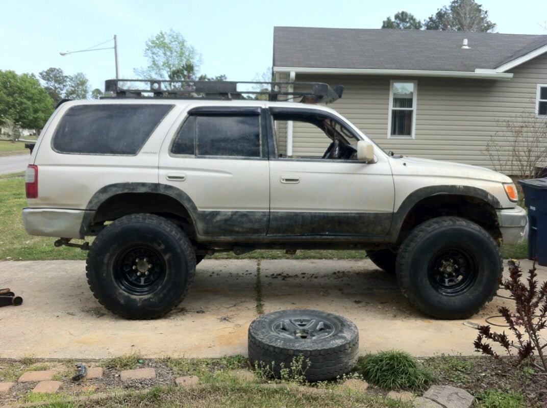

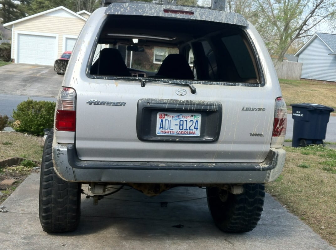

I'm in the process of putting 36" Irok's under my 4Runner that measure closer to a 37" tire…
Let me start by saying this is not a decision that you take lightly, it’s a lot of work and there is no going back. I will always be stuck running a 36” or 37”, anything smaller would just look stupid with the amount of body I have trimmed. There is no way that 4Runner on 38’s can go wheeling (even snow wheeling) the way it sets, he has a whole lot of cutting before it can leave the driveway. Hell, I even had to cut down my body mounts because the tires hit them. With a LT kit you might get away with cutting a little less of the firewall, but it’s still going to be a lot. The rear will have to be cut too, so say goodbye to your fender flairs and cladding.
As for the front drivetrain, bare minimum you’re going to need gears, an ARB locker to get rid of the weak spider gears, and aftermarket CV’s with stronger outer joints. I could write a novel on the subject, but I’ve covered most of the issue’s in my build thread (link below).
One more thing, the primary reason I went with these tires was for snow wheeling, not rocks. If your worried about running trails that the guy’s on 40’s have dug out you would be better to SAS and run 37”-40” tires. You can make a SAS rig handle great with the proper shock tuning and geometry.
BTW - I'm not trying to discourage you, I was just stating the facts. I've been wheeling my rig for a few years now, and I have have a pretty good idea what I can and can't do with it. This last round of work is based off of where I take the truck on a regular basis, and I understand that there will be weak points in the drivetrain. You can overcome every single problem, but it's going to cost you time and money.
My advice would be to look at where the 4Runner will be used 75% of the time, and your budget (both time and money), then build the 4Runner around that. I REALLY want long travel, but do I need it? After adding up all the parts there is a good chance I'll be stuck with mid-travel for quite a while.
