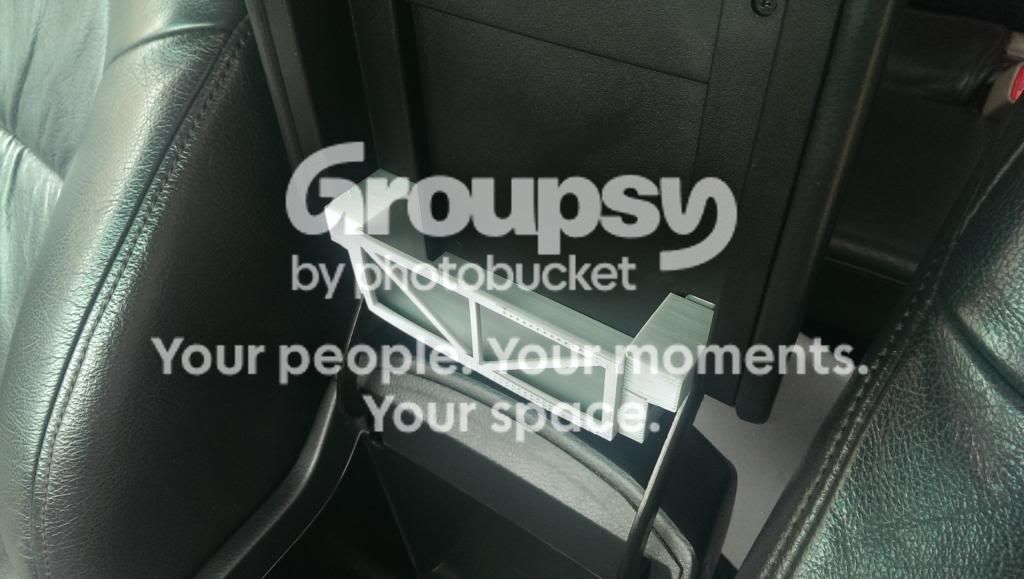

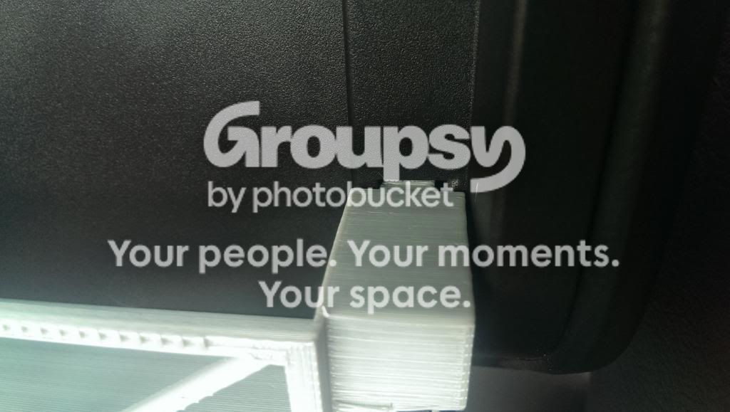

Hey [MENTION=100305]TiN[/MENTION], can you show a picture of your printout's fitted onto the rig? I wanna see how accurate you got the pieces to fit!
Sorry about the inactivity on this thread lately. My phone was stolen last month and I have been pretty preoccupied studying for finals. But, now that I'm back behind the wheel of an HTC One and this semester's finals are over, I can direct most of my attention to my Runner. First off, I'd like to show [MENTION=84223]JustSomeName[/MENTION] some fitment pictures of my most recent prototype.
IMAG0034_zps57ee6e84.jpg~original
IMAG0037_zps09f3cc3c.jpg~original
As you can see, my version fits in place just like the OEM holder does. The only issue at this point is that there is about a 1/32" gap above the top clips that prevent the tissue holder from staying in place as tightly as I want it to. Hopefully, I can just scoot the clips up that far in my design and it will click right into place.
Thanks for all of the ideas you guys are giving me! I'll try to keep this thread more up-to-date in the coming months.
Ladies in gentlemen, I think we just might have a winner! Looks to hold firmly enough to suspend a tissue box, but is also loose enough to remove without breaking anything.
