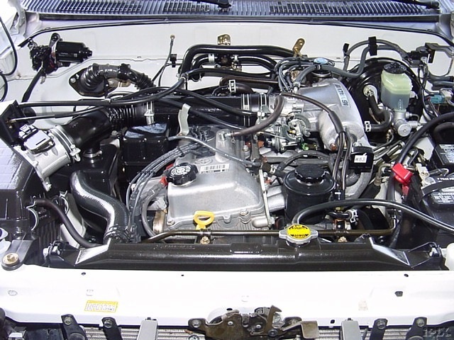

I had the chance to test drive a 4cyl. back in 2000 when I was looking for a vehicle. I test drove an automatic on 2 different occasions. I was fairly impressed with the smoothness and drivabilty. I realized after the second test, I would have a tough time passing a slow camper on a 2 lane highway. I know they are still making this engine and they are worth a look. I also like the idea that they have a timing chain.
once again, i fyou are looking to win races, then the 3rz is not for you. if you don't want to hear it on the highway, then the 3rz is not for you. i must admit though, with the 4.56 gear ratio, and the 5spd, i have had no problems passing people. it is more than sufficeint for my needs, and pat161's. tell you the truth, i love it. considerring they didn't really change anything between the 4 and 6 cyl 4runners, i would say that the 4cyl is overbuilt for itself. how many other trucks have 115,000 on original clutch? and it is not only me. pat161 had about the same on his 4 banger (3rz) tacoma. all i have done to mine is change the oil, plugs, wires, and put a k&n in it. not too bad for a 7 year old motor.
