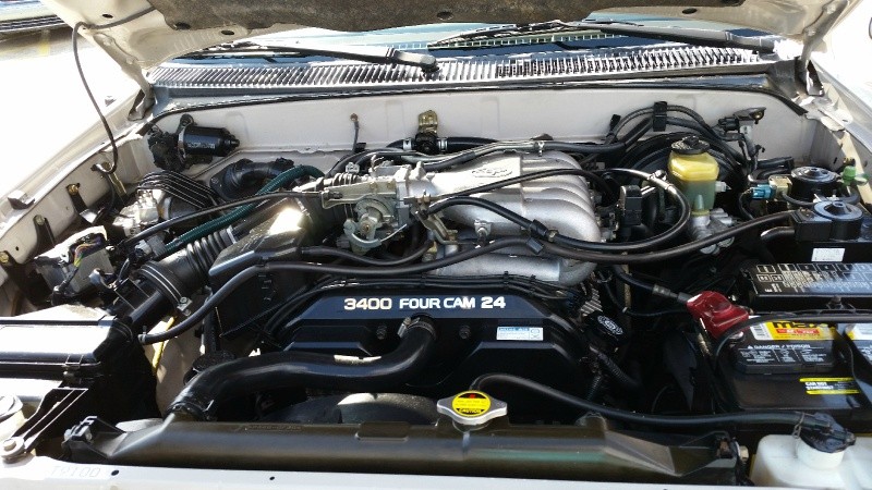

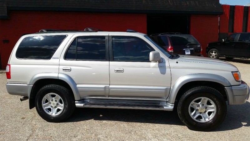

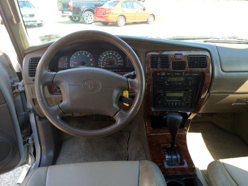

1999 Limited
I'm looking at this 1999 Limited at a dealer. Appears to be in VERY good cosmetic condition. It has 160,000 miles on it. They want $4900 for it.
Here's the description from the dealer site:
Just came in very nice & clean Limited 4Runner!
All Scheduled Maintenance.
Always garaged.
Custom wheels.
Fully loaded.
Ice cold A/C.
Looks & runs great.
Low mileage.
Must see.
Non-smoker.
Perfect first car.
Performance tires.
Power everything.
Runs & drives great.
Well maintained.
Very clean interior.
Upgraded sound system.
Got the Carfax and it shows it has had 3 owners and one minor accident. I can't tell much about scheduled maintenance and have no idea about transmission/radiator, etc.
Can someone take a look at the details and the Carfax and let me know if I should pursue this and what questions I should ask? I'm a total stranger to this and would appreciate some help! This is a great forum!
