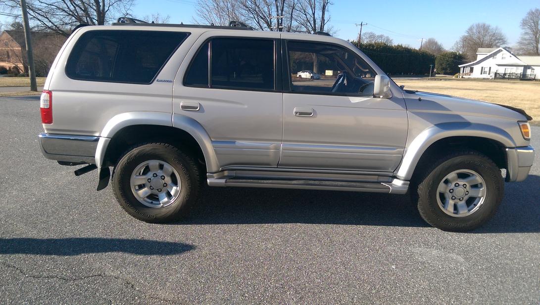

Can someone take a look at the details and the Carfax and let me know if I should pursue this and what questions I should ask? I'm a total stranger to this and would appreciate some help! This is a great forum!
Look pretty clean! Make sure to check the climate control until thoroughly. They're notorious for being a brit buggy. Also, I'm not sure the market in your area, but seems a little high for a 2wd. I'm sure there's a little wiggle room.

1997 toyota 4runner limited 4x4 with third row leather seat A/C 4X4 V6
I'd have them at least send you pics of the engine bay. Garage kept or not, I find it hard to believe that a Jersey car has no rust.

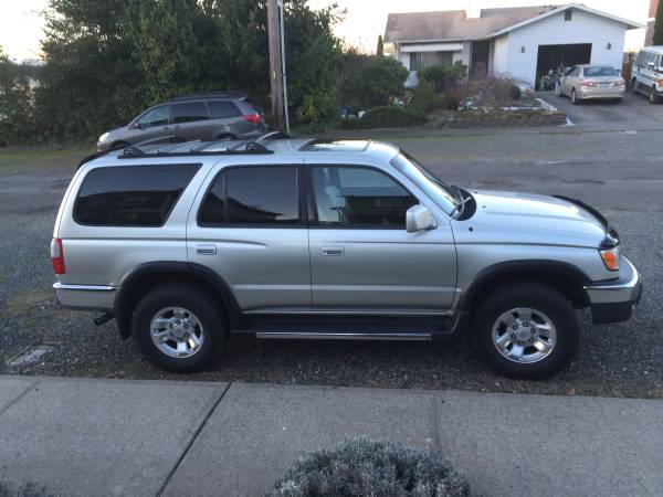

I'm seriously considering a 2000 sr5 4x4 with 199k. All the belts have been replaced in the last 3000 miles and it is very clean otherwise. He is asking 6000 obo. If I offer 5200 am I getting a good deal?
2000 Toyota 4Runner
This is pretty much par for the pricing in my area it seems.

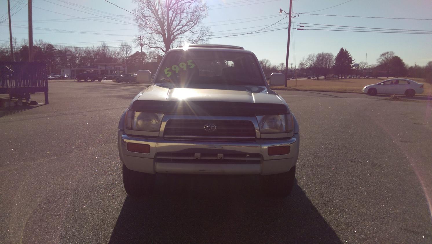

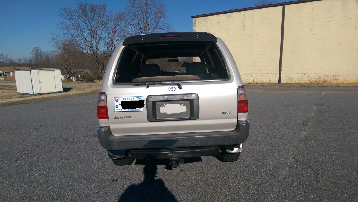

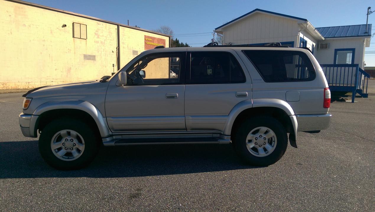

Hi guys and gals, i'm new here. I've been looking around for a 4Runner for a little while. I finally found one to go look at, and I did just that today. It's a 1997 limited. ODO is 180k. AutoCheck (aka Carfax) is completely clean. I asked for service records from the dealer and he said he didnt have any. They are asking $5995
First thing I do when I show up is check out the body, interior, and engine bay. All very clean, minus some surface rust on the undercarriage, definitely nothing major. There is a sticker in the engine bay stating timing belt was replaced at 93k. The clock above the stereo deck doesn't work, which i read was a common problem. I checked all the piping to and from the radiator, no signs of rot. Went to crank it up and it didn't start, just clicked at a machine gun pace. The dealer brought out the mobile jump start unit and it fired right up. Took it for a spin and put it through its paces, drove around for about 15 minutes, mix of city, highway. Pulled over and checked the tranny fluid, clean and full. Started to test out the 4x4. Tried out 4Lo and it worked fine. Switched to 4Hi and worked fine. Took a little back and forth to get it back out of 4x4, but it worked. Everything else works fine, A/C, heat, sunroof, all windows including rear, oil was fine, etc, etc...
The only thing I am kind of weary of is the lack of service records in the dealers possesion. Will I have to replace the timing belt, since apparently the last time it was replaced was 93k? Do you guys think the reason it didn't fire up is the battery, or possibly alternator issue? Any insight into this would be great.
