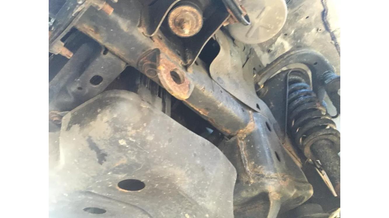

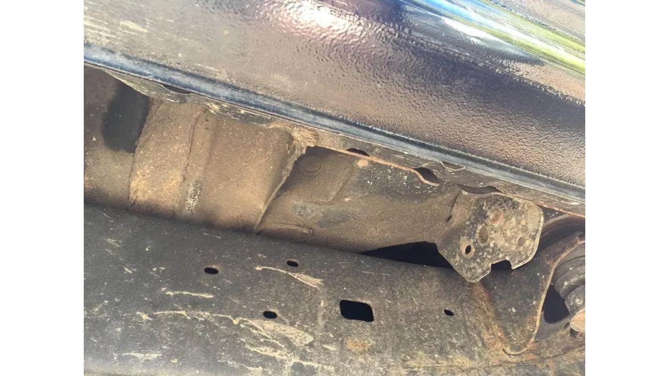

I'm beginning a rust treatment this weekend and most of it seems like surface rust. Comments from people here indicate as much after I posted pictures. I have not checked inside the frame holes yet though.
Here's an image. Does this count as "rest of the underside rusting away"?
That doesn't look bad at all. Many here go the POR 15 route which I haven't tried but read online that it has to be done perfectly or it doesn't work properly. Seems like a lot of work. My preference is to just scrape off the scale with a grinder and spray on some Rust Cure Formula 3000 oily spray which seems to get good reviews online. Maybe do that once or twice a year. You could also spray it inside the frame through the holes and aim it at any rust spots although it looks like you won't have much inside. Look at the whole frame, some people find lots of rust hiding beside the gas tank.
Here are some pictures of the underbody. It mostly looks like surface rust to me

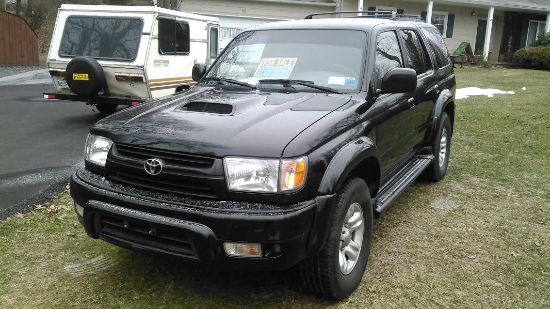

Hi I own a 97 now and looking at a 2001 sr5 I don’t know if 4wd is working properly or not? I did my research and understand he differences . But going into each drive{ 4WD, lock diff}< , it seems to work except there is a lag when you get blinking lights in the display it takes a few seconds before it actually engages. In addition you can hear it when it engages Is this normal?
2 now when you try to go out from 4wd to 2wd , 4wdl or unlock the differential it continues to blink no matter what you do : stop, go backwards, step on brake. The display continues to blink till you put car in park
Does this sound normal or is something wrong???
Ps my mechanic has a customer selling a nice 2004 and there s a 99 limited available. Is something wrong w this 2001 or is what I descried normal. Maye I should consider the other two? But I liked this 2001 just unsure if working properly?

It is normal for it to take a few seconds to engage/disengage and it should be audible. Sometimes you have to shift through park,neutral,reverse, or drive for it to pop in/out.

It is normal for it to take a few seconds to awd feature i wont engage/disengage and it should be audible. Sometimes you have to shift through park,neutral,reverse, or drive for it to pop mode in/out.
Thanks so its normal for 2001 4wd system to act this way. I’m used go going between 2 &4wd on the fly with my 97. Maybe with this mullti mode it won’t be necessary to change so often. .the idea of having a awd mode interested me. I’ve been happy with the 97 but shift often between 2 &4 wd in winter
I didn’t mind the lag getting into each drive wih the 2001 . but the flashing light when I try to get out or make a change on the fly is a little disconcerting.. I had to put it into park to get the display normal again.. also when trying to get out 4wd and the display flashes. what drive is it i then? is it okay to dive ?
. I want to look at a 99 limited and see if that system with its multi mode transfer case is any better with going in and out w/o stopping? Otherwise ill stick with the old school transfer case like in my 97.
