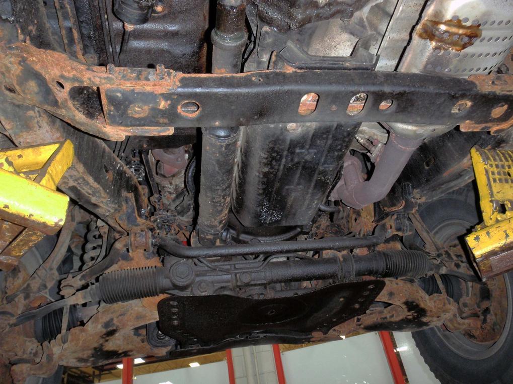

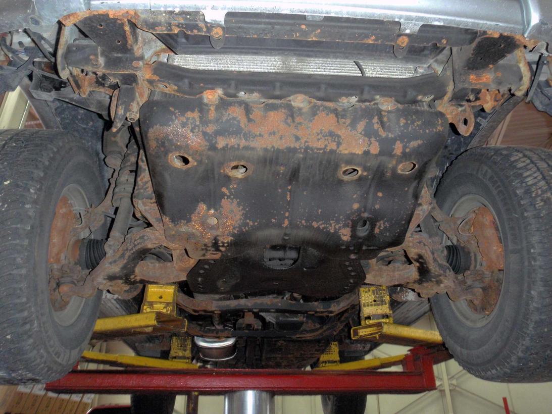

The copious amounts of oil gunk around the steering rack would worry me a bit. Take a look at how badly the valve covers might be leaking (and hopefully it's not a rear main seal). And whoever lubed the driveshaft really pumped the hell out of the grease gun, lol.

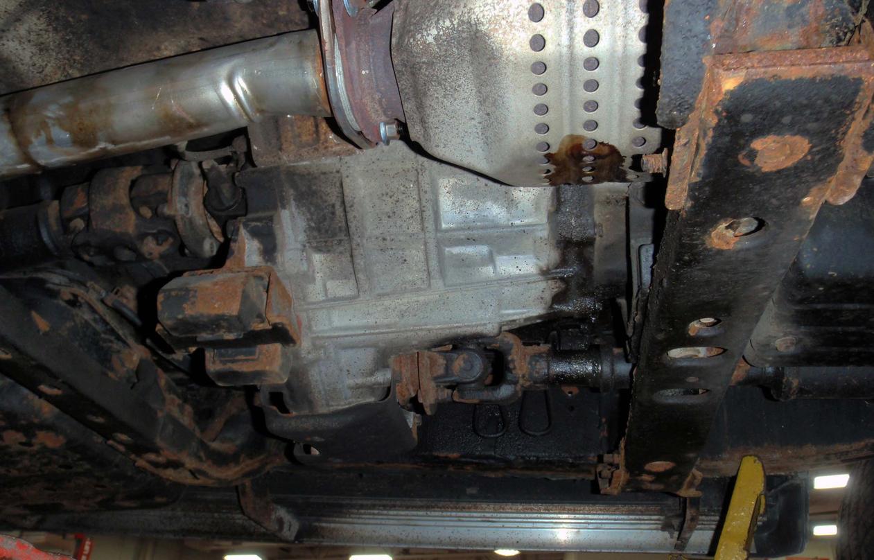

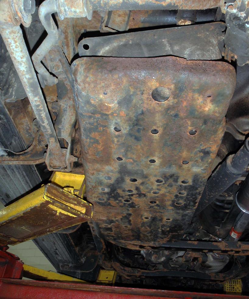

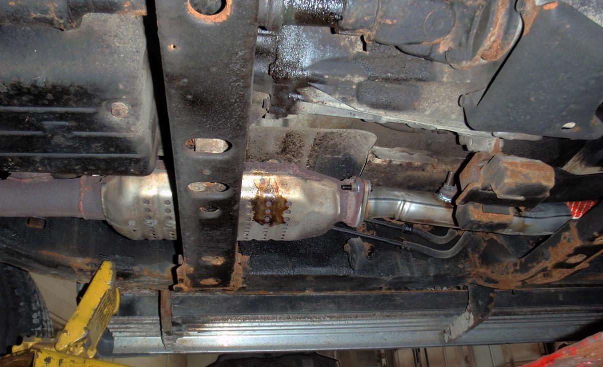

I dunno... I would also ask for way better pics of the rear portion of the frame, especially around the rear LCA mounts. The spot between the frame and gas tank is especially hard to inspect, but also one of the first places to rot through.
Here's what my steering rack area looks like:
Parts of the frame:
I always cringe when I see pictures of rust on people's frames. I don't know which areas are a no go for rust, but I do know that some of them are more important to look out for than others.
