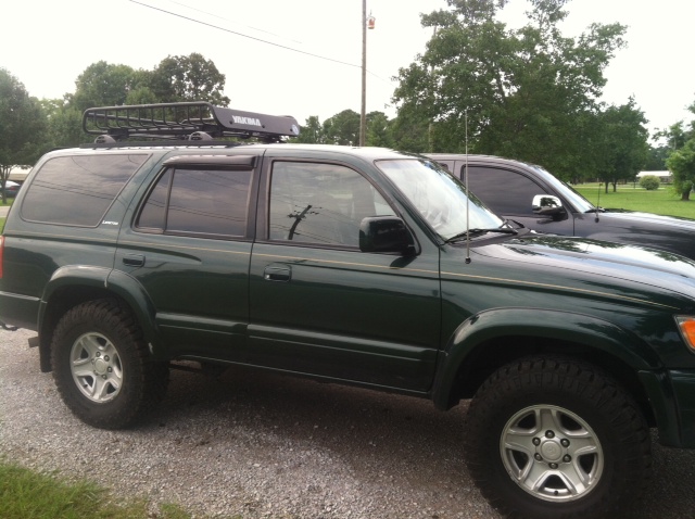

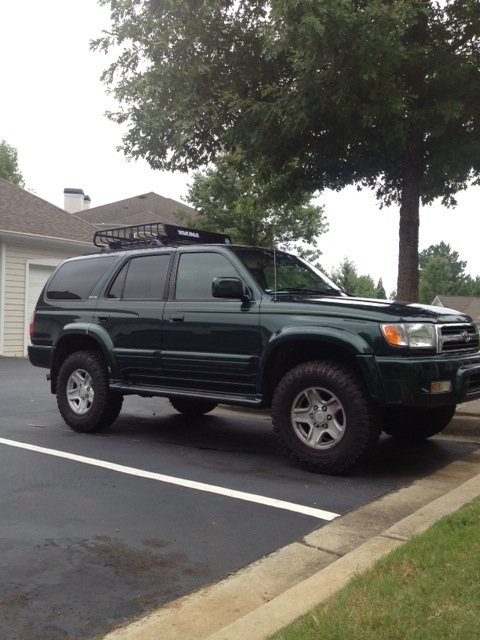

Here is a before after of my Tundra TRD front coil with stock Bilstein shock and the OME 890 in the rear. The photo does not show a whole lot of lift because of the running boards and the angle...But the OME gave me a full 2" over the 99 coil and tundra front gave me a full 1 1/2". The ride in the rear is fantastic and the coil is real long so when the truck articulates it does not let the coil unseat at all...
Before - Stock
After - Tundra / OME 890

center of hub to fender specs
many posts were deleted for some reason but to repost the info for those who were asking, the front of truck does not have the adjustable bilstein 5100's that will give me about an inch more lift up front. It has the stock bilstein tundra shocks. So, after that I assume a more level, lifted ride. Right now, the front and back are as follows.
Center of hub to fender.
Front - 22.00"
Back - 23 7/8"
