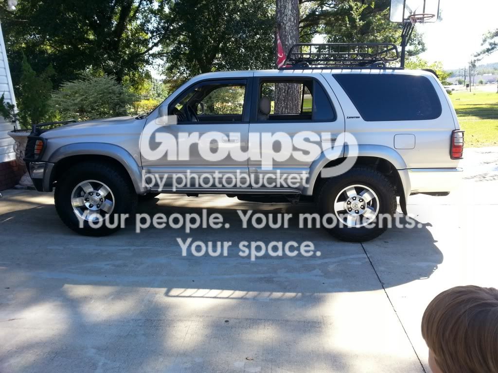

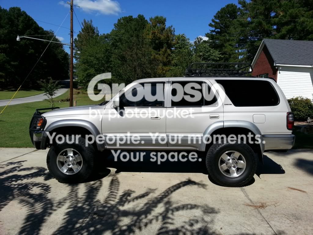

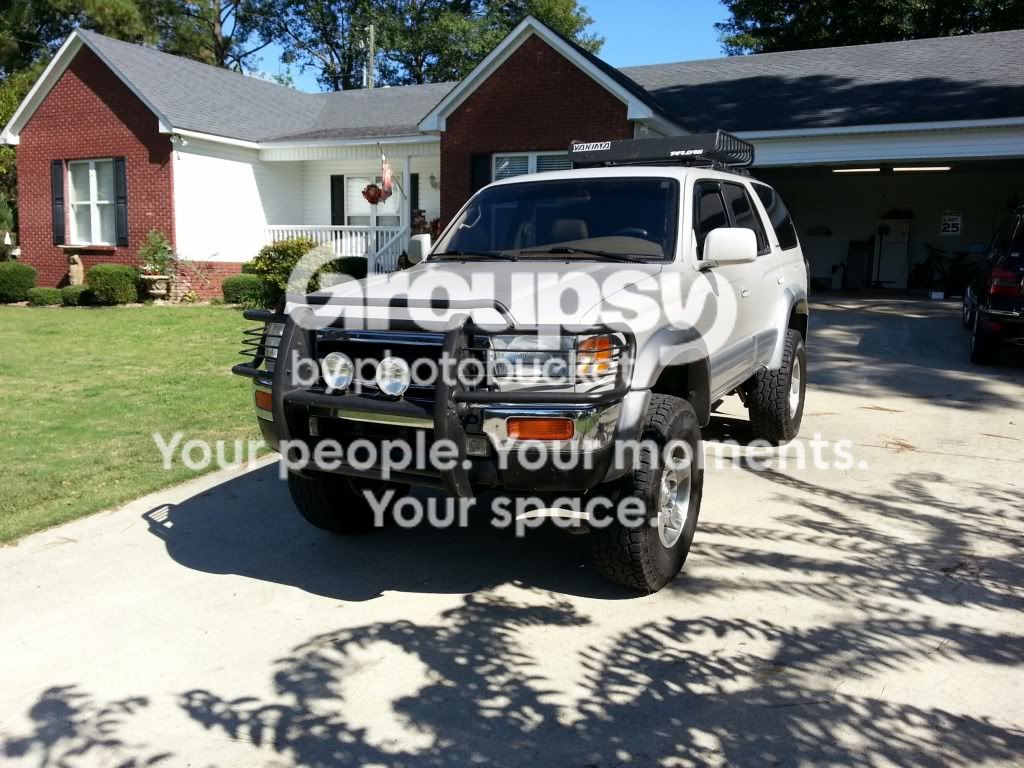

Installed yesterday. I have put 130 miles on it so far and love it.
Toytec 3" springs in front with Tundra 5100s on second notch. OME 890 springs in rear with Rough Country N2.0 shocks. Rough Country shocks were already on it so I decided to give them a try. I ended up with 4" in the front and 4 1/2" in the back. The amount of lift looks pretty high because I had 200,000 on my factory springs 2wd springs. Before numbers were 19 1/2 front 19 back. Now I'm at 23 1/2 front and 23 3/4 back. The ride is great. It is not harsh at all. Remember that I'm comparing this to completely worn out 200,000 mile springs and shocks that were on it. The back feels a little softer than the front so I will probably put Tundra 5100s on the back pretty soon. I also installed Spidertrax 1.25" spacers to set the wheels out a little.
My previous 4Runner had 99 Talls with Tacoma 5100s set on the second notch and I didn't like the ride. It was way to soft. The Tundra 5100s are the way to go.
Before
After
Before
After
