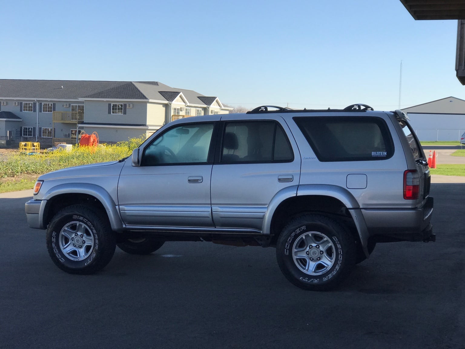

I know that I have the 5100 891 rear combo and it's about 3" lift and I have tundra front struts with the TRD springs and that's a little lower but I like the raked look.

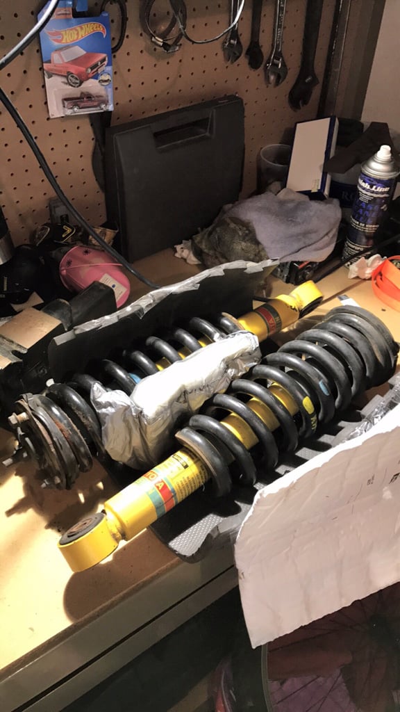

Tundra Stock TRD 4600 Billy's with coils on 3rd gen.
I have searched the forum a decent amount, and have yet to find a solid answer so I apologize if I missed something or piss someone off. I ordered some stock 4600 bil. Shocks with coils assembled off of a 2002 TRD access cab. Unfortunately, they wouldn't sell just the coils from the truck, and I am wondering if I could get 1.5-2 inches of lift from this assembly on the front of my 2000 SR5 4runner. I have seen mixed answers on this and a lot of variations. If I stick with 4600's would I still need the Tundra coil isolator a for the assembly? Thanks!
When you say Tundra front struts, do you mean the stock 4600's or the 5100 adjustables? Looking good either way!
The actual stock 4600s. I figured if I didn't like the ride I'd just get some 5100s. Which I might be doing since it isn't perfect. It's really only noticeable when you're going 25-30mph over bumps. Slightly firmer up front, but I'll be putting front and rear bumpers on sooner or later so it should be ok. We shall see...
