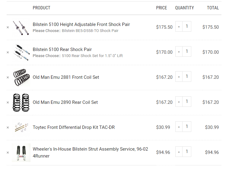

First post. Thanks for creating this amazing resource for lifting the 3rd gens. I am not new to lifting vehicles (I own a 2015 tacoma on icon coilovers), but the 4runners I am.
We are looking at a 2" lift to avoid having to get UCA's and panhard bars, as well as keeping good road manners as it is a daily driver. Before I pull the trigger, does this setup look right?

Looks about right to me

You don't have to replace your UCA's with over 2" of lift. It all depends on if you can get your camber corrected for alignment (to my understanding, by no way a mechanical engineer, only Electrical(and only claim because I hold a electrical License) :P). I have the Toytec Ultimate Boss with superflex coils and I have it set at 3" of lift. I was able to get my alignment with-in specs and haven't experience any un-even tire wear over the last 15k miles. I thought about getting UCA's and when I swap my suspension in 2018 I will go to new UCA's. Just my personal experience and knowledge :)

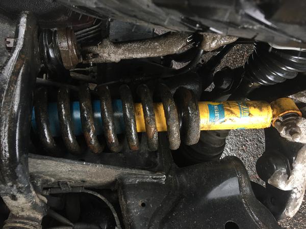

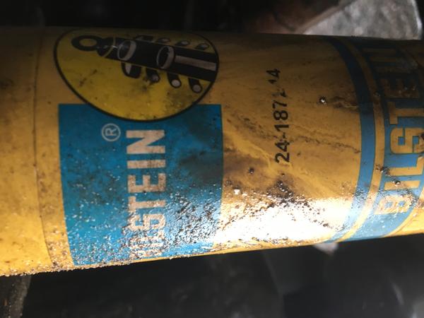

I recently picked up a '97 4runner with what I thought was stock suspension and a sagging rear. Now that I measure I'm getting 22" hub to fender on the front, 20" rear driver, and 21" rear passenger. There are Bilstein 4600's for a 4runnerall around and no markings on the front or rear springs.They look very similar to OME 881's but if anyone can confirm that would be great.
When I replaced my stock suspension last Spring, none of my Springs had markings (they may have been worn off over the years). The rear DS spring should be taller and my replacement OME906's were marked. Overall, I gained about 1.5" rear (I had a .5-.75"sag) Can't remember the stripe colour, and I don't think the fronts were marked. I replaced my front springs with OME880's and gained 1/2". I ended up with .5" +rake DS and .25" +rake PS, with an overall .5-1" lift roughly.
Your numbers look very much stock. I don't think you have OME front Springs, my OME's had flattened Spring ends. It appears the PO just replaced
the shocks, 4600 are the stock replacements, they are designed with travel for stock Springs--- if you had 881's which would, I believe provide a 2" lift, I would expect to see 5100 Billies, they are designed for greater travel.
