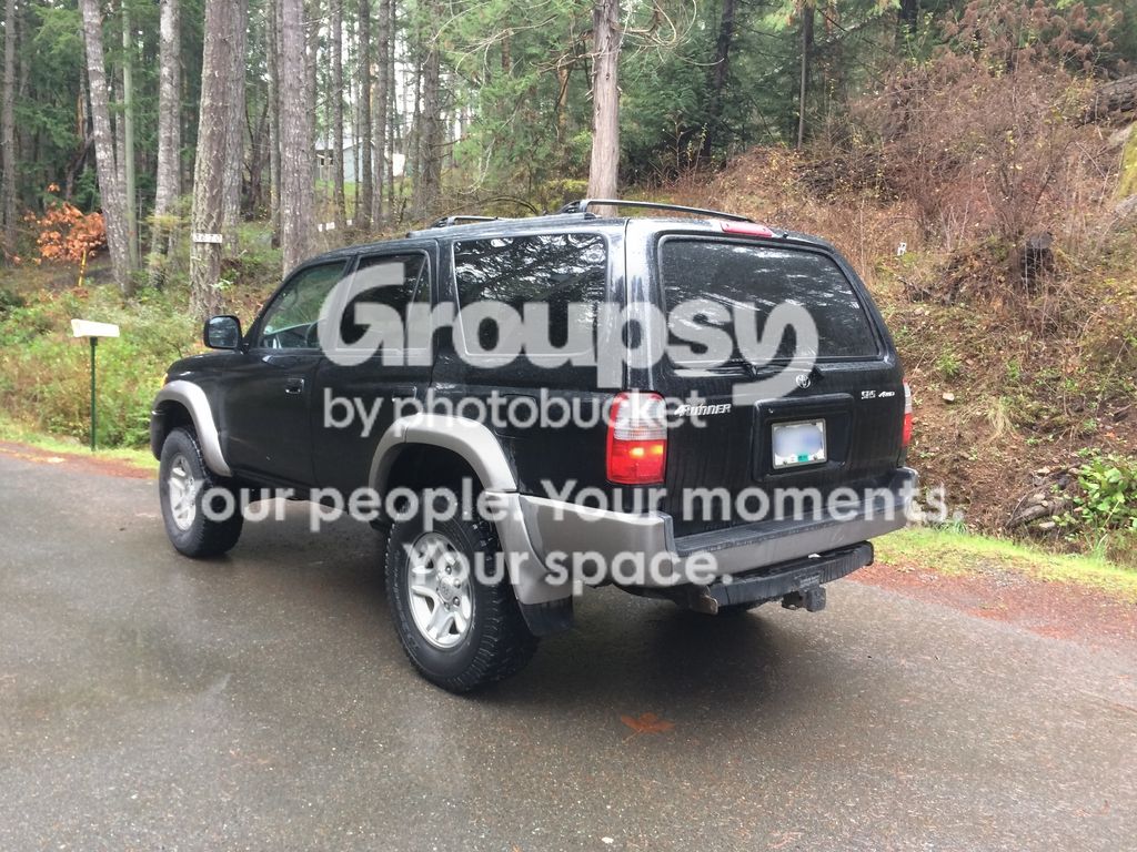

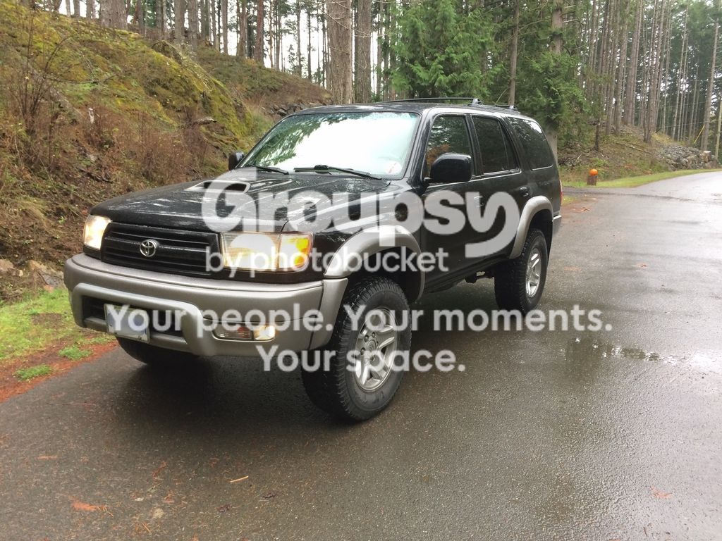

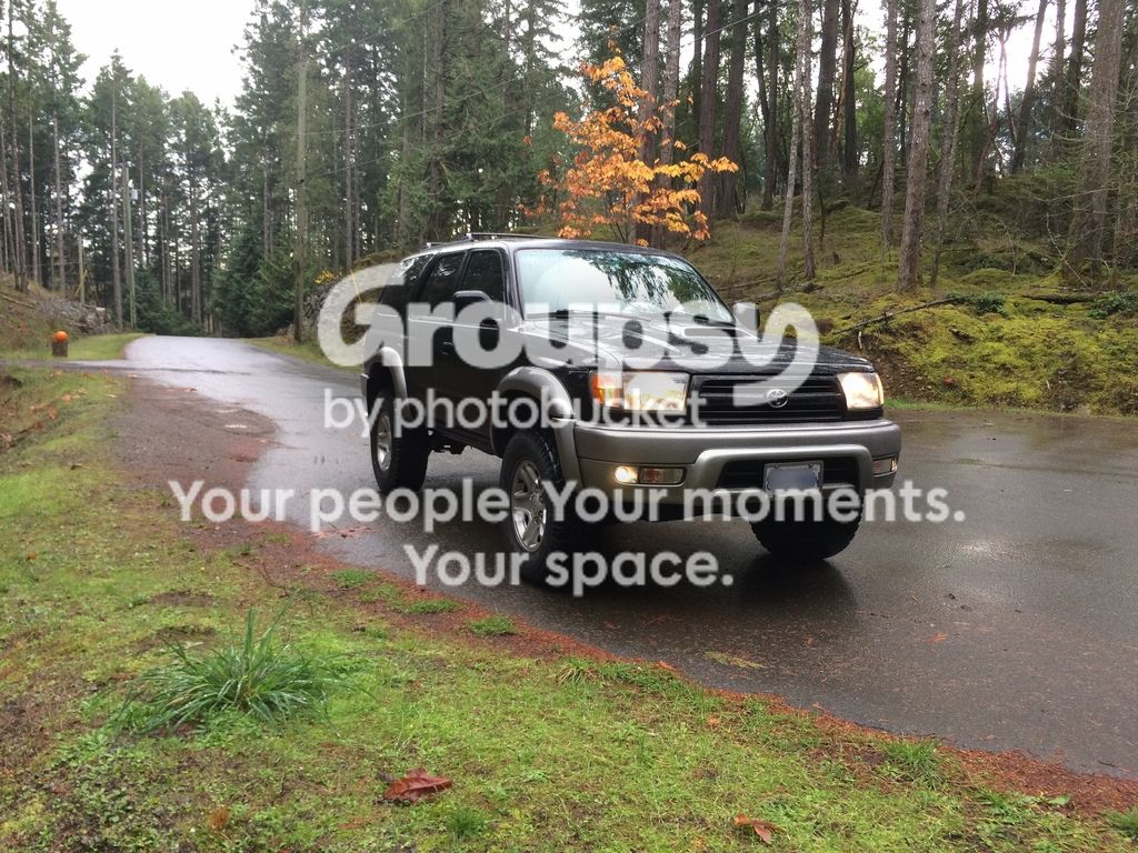

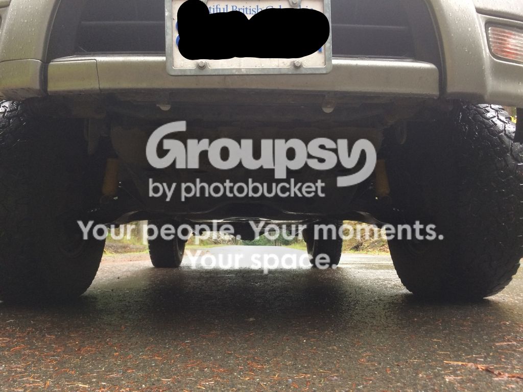

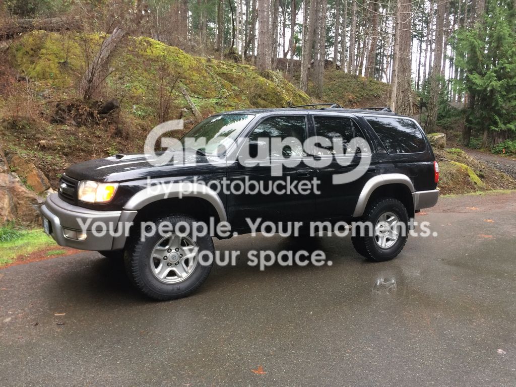

Just installed my OME lift... went with the 881/906 combo plus I put in some 10mm spacers in the rear as I wasnt sure if the 906's would be tall enough to have it sit right. I prefer the rear to sit half an inch higher than the front, giving it an aggressive stance without obvious forward rake. I went with the usual 90004 shocks in the front but decided to go with the newer 60073 soft shocks in the rear as Ive hear many complaints about the 906/60028 combo being too stiff.
I have to say for me, it sits perfectly, and the ride is amazing. Feels so much more planted than with the stock suspension. The rear end doesnt bounce around like an old Cadillac now. Definitely firm and responsive but not rough, still absorbs the small bumps. It seems to corner about the same as before, given the suspension is tighter, but the truck sits higher up. I havent measured the difference in height yet but, being a 2000, it had the lowrider springs on it so the difference is pretty noticable for me. Ill post some pics for anyone who is wondering about this lift. Id definitely recommend the 60073 softer shocks with the 906's. I wouldnt want it any more stiff but it is perfect the way it is now, mind you I dont carry a lot of weight around in the back. Tires are 265/75R16 FYI.

And just to give anyone an idea of the angle of the control arms

If anyone has any questions ask away. I know when I was deciding on the lift I had a zillion questions and had a hard time pulling the trigger.

That looks perfect. I think this will be the lift I go with when I decide to lift mine. May do the 5100s instead for shocks since I think they're slightly less expensive.
Looks awesome man! Looking forward to some measurements. When you do, please include center of hub to bottom of fender.
Also what made you choose 881 over 880?

Sorry I still havent gotten around to measuring. Its just been pouring rain here on the west coast. Ill get on it sometime this week.
As for the springs, I figured it was more worth the money to get an extra half inch of lift. The 881 spring rate is the same as the 880 so the ride wouldnt differ. Basically came down to a bit more lift. I know the 906's are 2" so I just bought the 10mm rear spacers incase the rear needed a bit more height to get the stance right, and it did. If I was just going to go with the 880's Id just go with the 906, with 881 Id recommend the rear spacers. Having said that I have no idea how/if the springs will settle, and obviously every vehicle differs slightly. I have to say, to me, I really notice the difference, particularly when I stand next to the truck or sit in it. But overall it really isnt that much lift. I swear the 880's will barely be any lift at all. Depends what you want. Hope that helps!
