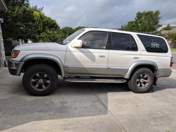

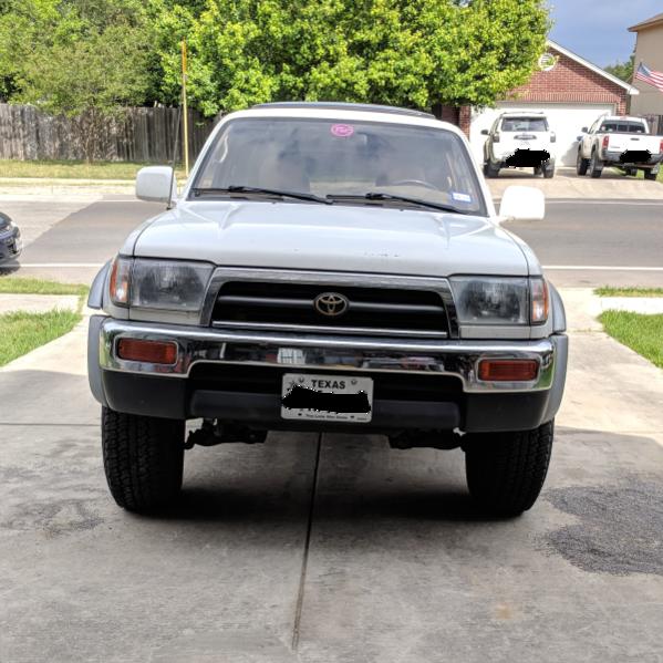

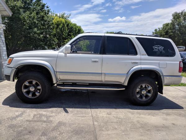

My wife's 97 Limited 2WD with 230k. I just installed:
From BilsteinLifts.com (free shipping):
(1) OME Front 1.5-3" Lift Coils for 1995-2004 Tacoma & 1996-2002 4Runner (880) @ $179.99
(1) OME 2" Lift Rear 2906 Coils for 1996-2002 Toyota 4Runner @ $179.99
from RockAuto ($10 shipping):
(2) KYB KG9025 Strut @ $34.79 ea
(2) KYB KG54317 Shock Absorber @ $20.79 ea
total: $481.14
Plus I recently did tied rod ends, rack bushings, sway bar links/bushings, brakes.
Had it aligned today and just took it for a test drive downtown. Wow what a difference! Smooth ride even on crappy downtown San Antonio roads. Wife said it handled great on the highway. I'm happy. :dancin:
Now it just needs a good wash and wax. I think the rims are chrome under all the grime.

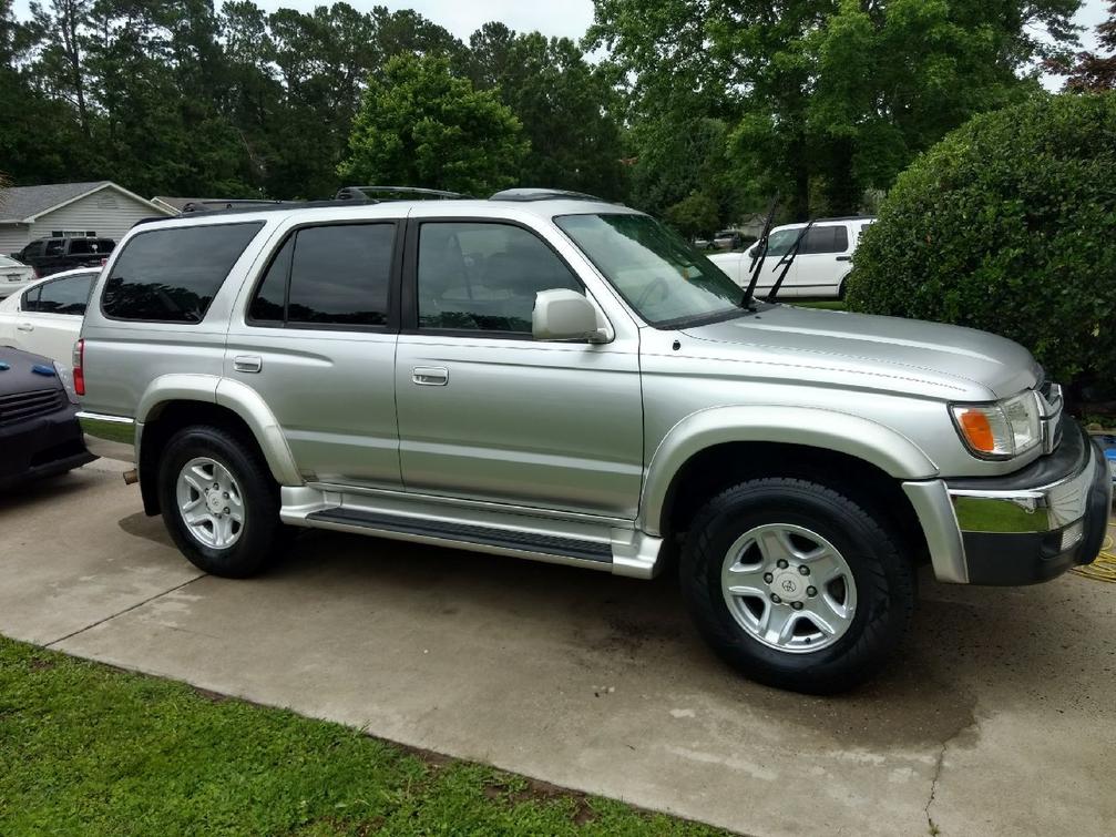

I recently picked up an 01 SR5 Auto with 95,333 miles.
Has many of the upgrades I would have wanted, leather, moonroof, flares, power everything.... etc.
It is a 2wd that will likely NEVER see any off road (as a 2wd). I found a GREAT deal on a set of NEW 285/75/16 BFG KO2's which I plan to mount to either the stock rims or to a set of new wheels when/if purchased. Stock being 7" I think a set of 16x9s would compliment the ties a lot better.
I've looked and looked at the various suspension lifts and it's a little confusing and overwhelming, which is why I'm posing the question in this post...
I am looking for a lift that will not ride like a 2 cart wagon but will allow proper fitment and clearance of the 285s. This will be my main daily driver once it's all finished and I understand that with basically 33s the MPG will drop. Not worried about that. I want a CLEAN, LEVEL, LIFTED 4R that rides comfortably and allows me to run the 285s.
Wondering if I should look at a complete setup from ToyTec or consider Bilstiens all the way around. I know I want the shocks/struts and springs ALL replaced because the rear are already shot, which is why I want to go ahead and do the lift at the same time.
Can someone who has 3rd Gen 2wd help me out as to what you did? The search string returns so many posts that it still just gets the water muddy. Tires will be here this week and I'd like to move forward with the lift within the next two weeks. Oh, and the timing belt/water pump is being replaced Tuesday so that's out of the way.
I certainly appreciate any responses ya'll may have. Looks like a LOT of knowledgeable folks in here! Hopefully the attached pic comes out right.
My advice to you is lose the running boards, get a 1.5 - 2” mild lift, and only go with 265x75x16 which is essentially at 31.5” tire. If I had a 2WD I would definitely not go with 33s. 33s hmmmm worse gas mileage, less power, more wear and tear on the truck.
Siince you may only need mild 2” lift there are lots of ways of doing it.
Did you by chance search for “mild lift” and did you use the Sticky, not the forum search. I agree there is a lot of info.
BTW welcome to the forum. That looks like a really nice truck.
I agree with Brian, what a good looking truck!!!!!
Def. drop those running boards..that's a free lift right there and you'll never believe the difference it makes. I really stressed about pulling mine but once I did, I loved it.
The good thing about doing less of a lift is a better ride! I'd def. read that first page of this thread very carefully and see what suits your needs.
