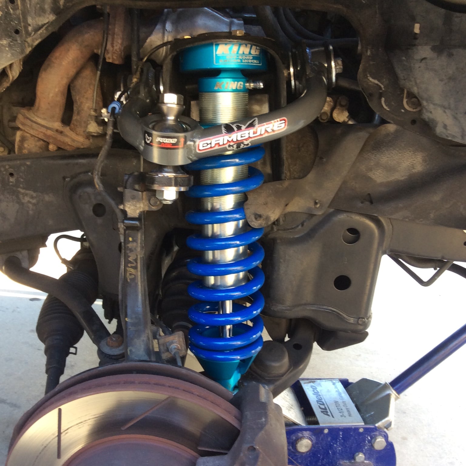

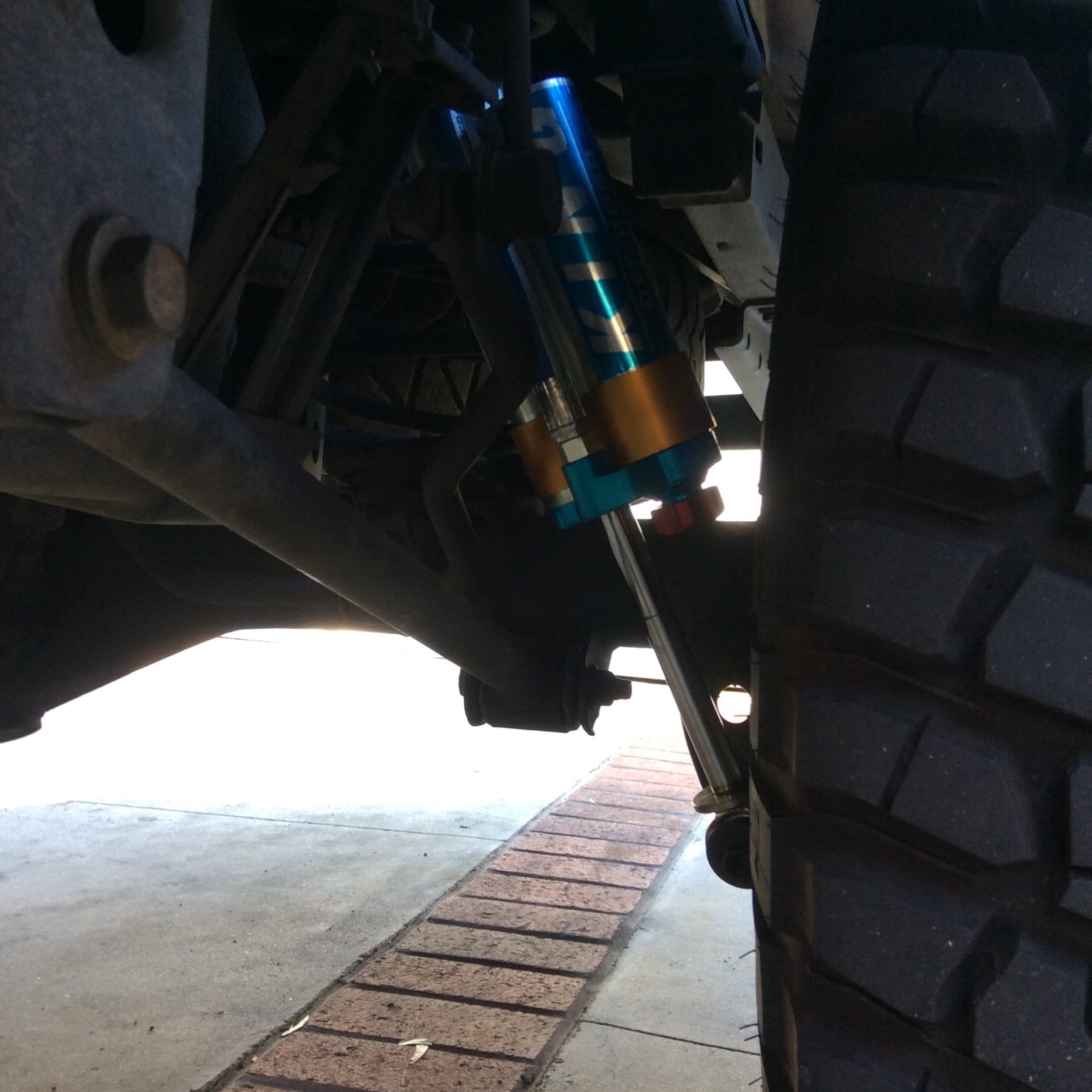

I installed King 2.5" coil overs with Camburg uni ball upper arms on the front and the King rears with the compression adjusters paired with LC80 coils and couldn't be happier
Since your running lc coil rear, what lenght kings you runnung? 4runner will bottom out. Lc kings?

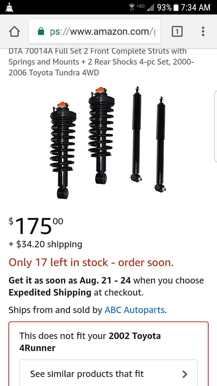

Will these work on my '02 sr5? I have the original suspension and it needs to be replaced REALLY bad. I have a set of LC springs already from mt old rig. Also will this lift the front end or will i need to get spacers? If so will the onse for the 96-02 4runner spacers work or do i need to get the tundra ones. This is my first go around wwith IFS suspension

Probably not, I believe the top hat is different. When you use the Tundra struts, you swap the top hat to the one for the 4Runner.
