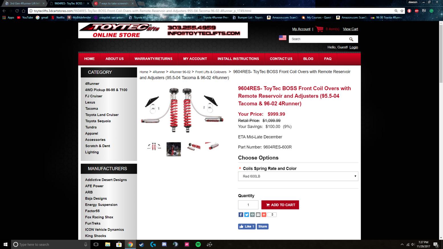

Anyone have experience with this kit? Would like to see how they compare to icon's or kings!

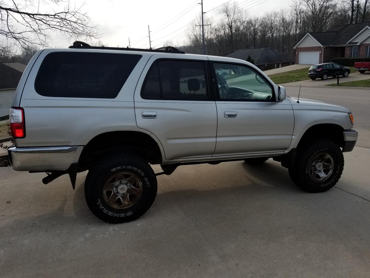

I just picked up my first 4runner. It came with a 1 in BL and 883 OME. How long should I expect to get out of the OME? The ride is somewhat rough but I can tolerate it since I'll eventually be weighing it down with bumpers. It still has stock UCA. Should I be in a hurry to change anything out? Thanks for any help. And yes I have already searched for these answers but nothing seemed clear for my scenario.
