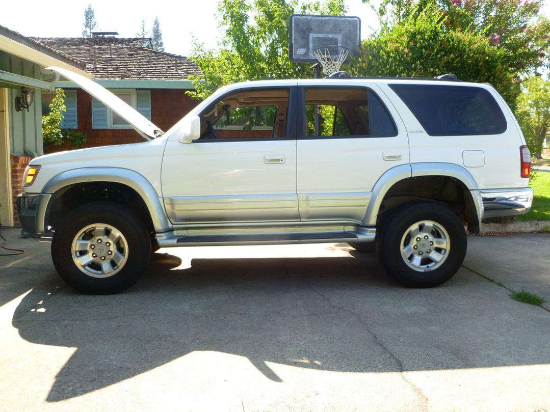

I paid $5,700 for a 96 Limited 4x4 with 250k on it a few months ago. It was cosmetically excellent, leather, sunroof, everything works, and has that great white paint. Since buying it, I have put about $4,000 into it, doing most of the work myself. But now it runs like a top, rides like a dream, and is a thing of beauty to look at. I may be naive, but I don't think I got ripped off at all. I'm happy with my 4Runner for the price I ultimately paid for it. Sounds like you may be in a similar situation.
