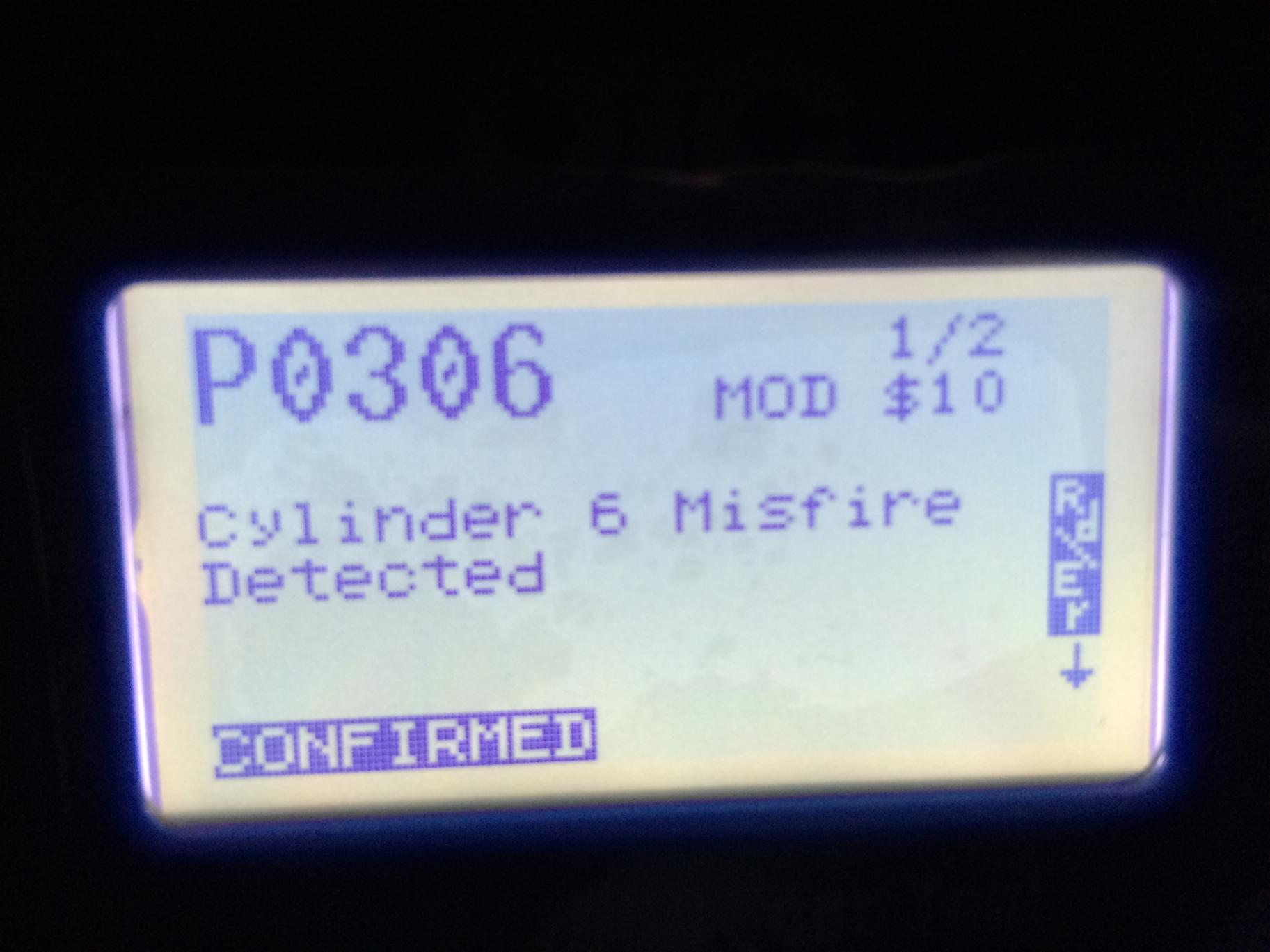

Running out of ideas here and hoping someone cane help. I have a misfire in cylinder 6. What I have done:
1) Replaced plugs with NGK platinums.
2) Replaced coil packs.
3) Replaced fuel injector on cylinder 6.
After all this, i'm still getting a misfire from cylinder 6. Anyone have any experience with this issue? Any suggestions? I did have a cracked radiator back in early October that caused an overheat.
Suggestions I have already gotten that I would like feedback on as well:
1) Change oil.
2) Change head gasket.
3) Change valve.
3) Change fuel filter, clean system with fuel injector, fill up with premium.
Thank you for your ideas and suggestions.

One relatively easy thing you could do, just to eliminate a potential cause, would be to switch spark plug wires to see if the code moves with the wire.
I had a similar misfire, and before I changed the injector, I switched the spark plug from that cylinder, then switched coil packs, and then switched spark plug wires. The code never moved each time I changed something, so then I assumed it was an injector, and luckily it was. You've done most of that from what I saw in your post.
I would just switch it with one of your existing wires, reset the code, and see if the check engine light code pops up misfiring on a different cylinder.

southsidewaterman, great point and very simple to do. I'll probably tackle that first. Thanks.
I did all of this and it was just a wire. Make sure you get NGK wires... Those Bosch ones are crap. If that still doesn't fix it, I'd start with a compression test, then leak down test.

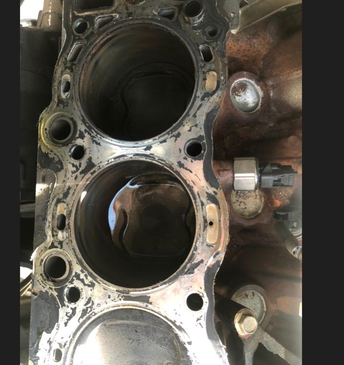

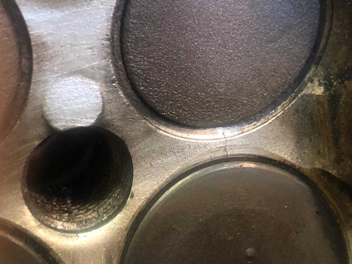

Thanks for the response. The verdict is a hairline crack in the head, based on scoping the cylinders. They didn't see it, but the shape of the carbon buildup indicates it, as well as the engine behavior. All the other replacements and tricks (switch injectors, etc) didn't change a thing. The cost to replace is stupid expensive now. Hoping that impending "recession" will change the costs.

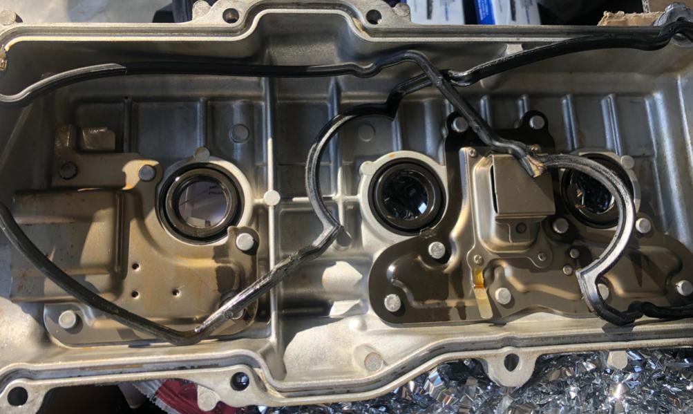

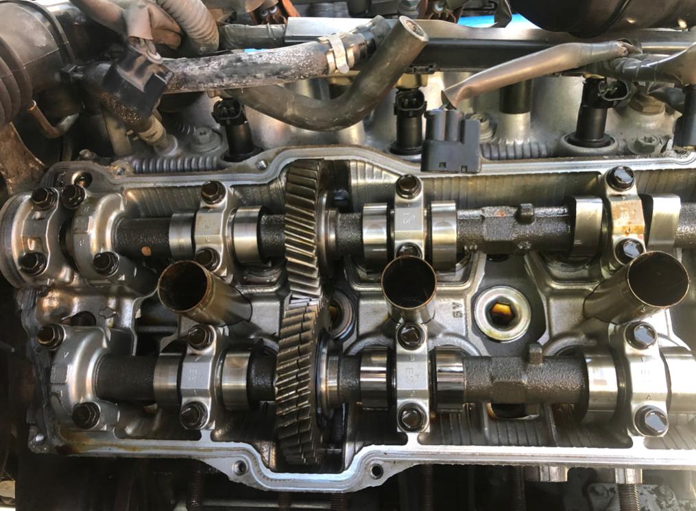

I'm in the middle of replacing both heads now. As Tim suggested, that video series is a great reference, as are Tim's videos on Timing Belt Replacement, Valve Cover Gasket Replacement, and knock sensor replacement - these are all invaluable resources and are truly "gifts" for those of us that want to tackle this project. Thanks Tim.
My experience so far: A timing belt replacement is the bulk of the work - if you can do that, you'll have all of the specialty tools required. Everything else just requires standard tools.
Fortunately for me, I live in Southern California and rust is not an issue. This made removal of the Exhaust Manifolds easy. Once the nuts are removed from both and the crossover pipe, you can use a pry bar to push the crossover back and free the manifolds.
The most tedious part so far is setting the valve lash - even with the heads on my bench. Something to point out: When you remove the cams from the RH head, you match up the "two dots" identified easily with factory match marks. On the LH head, you match up "one dots" also easily identified with a match mark. However, when you set lash, you match "one dots" - so keep this in mind with the RH head.
Also, setting the lash requires you to remove and replace the cams - several times over the course of the process. Be sure to oil the cam bearing bolts as they are going in and out of aluminum, and despite my best efforts (using a torque driver and A LOT of care, I stripped one of the holes).
Otherwise, this is not really a complicated job. Just take your time be methodical.
I've attached some pictures - one of cylinder #3 with a nice puddle of coolant on the piston, and one of the crack in the head (which looks identical BTW to the crack depicted in the video series except his was Cylinder #4). Also two of what the head and valve cover looked like - a testament to regular oil changes and Mobil 1.
Good luck!
