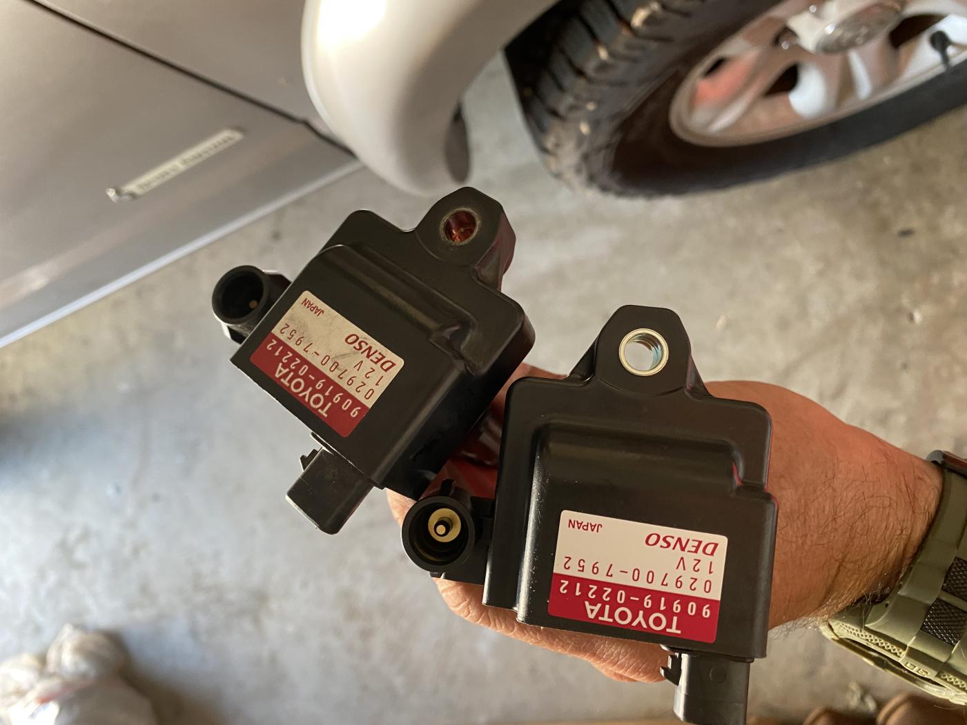

Quick update: misfire fixed!
After replaced the spark plugs and wires, still had a codes P0300, P0305, P0100 and P0110(before P0305 I had P0301, I moved the coil at cylinder 1 to cylinder 5 and the misfire code follow the bad coil).
I bought an OEM ignition coil and replaced, I had driven the past week and no codes showed anymore.
Next step is timing belt replace.
Thank you guys for the help
