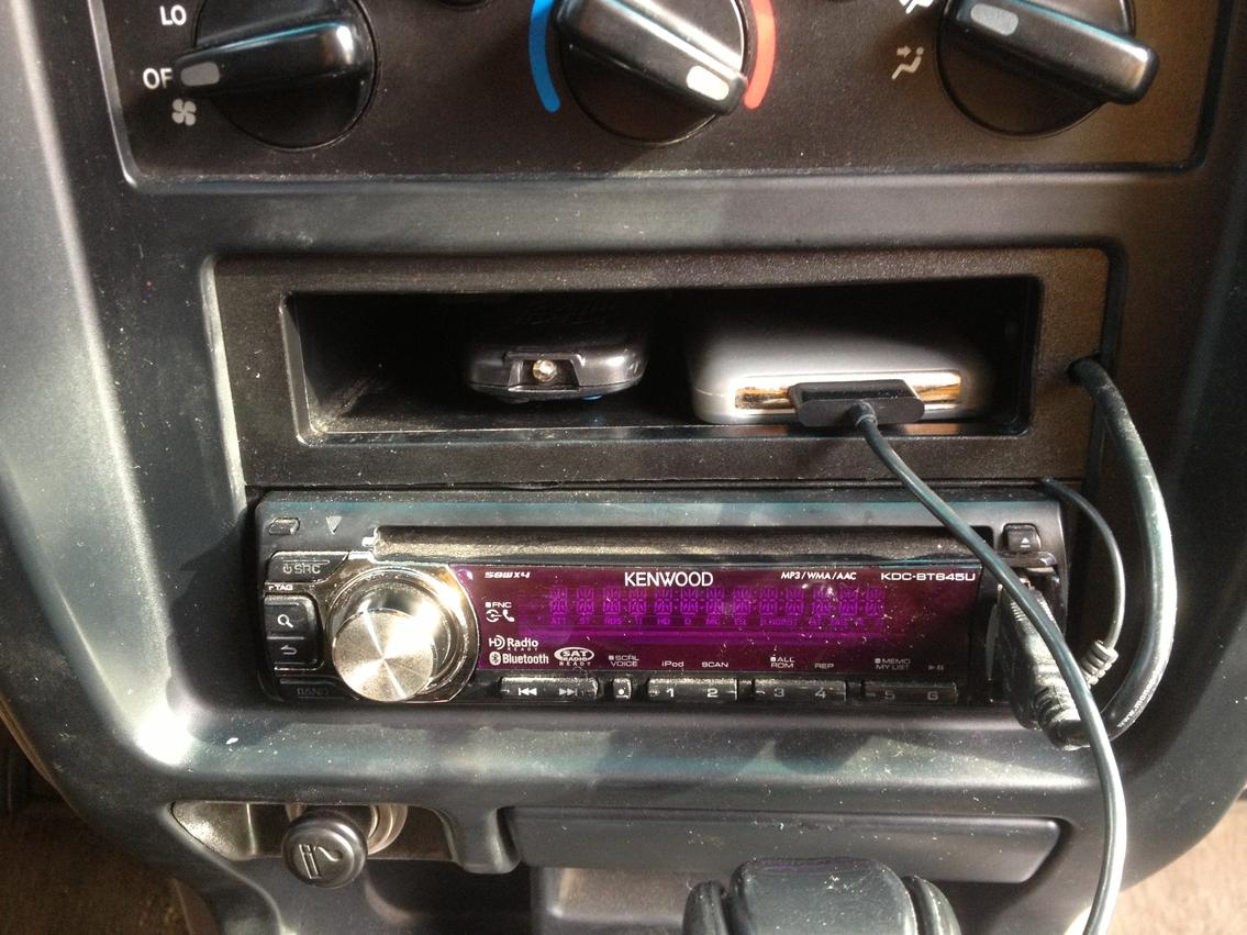

this is how I installed mine with the pocket on the top. You can mount it either way. Use the small face plate on the pocket to make it flush.

If you're installing a single din

yes, but no need for a kit of your installing a double din. The OE bolt holes will line up with the HU.
I just put a Kenwood HU in my 99 LTD. Crutchfield shipped me the pocket for free. The HU used the factory radio brackets to mount into the dash. The factory brackets screw into the new HU. You don't use the slide in mount.
Crutchfield also included the wiring harness and full instructions free. Major score with them.
