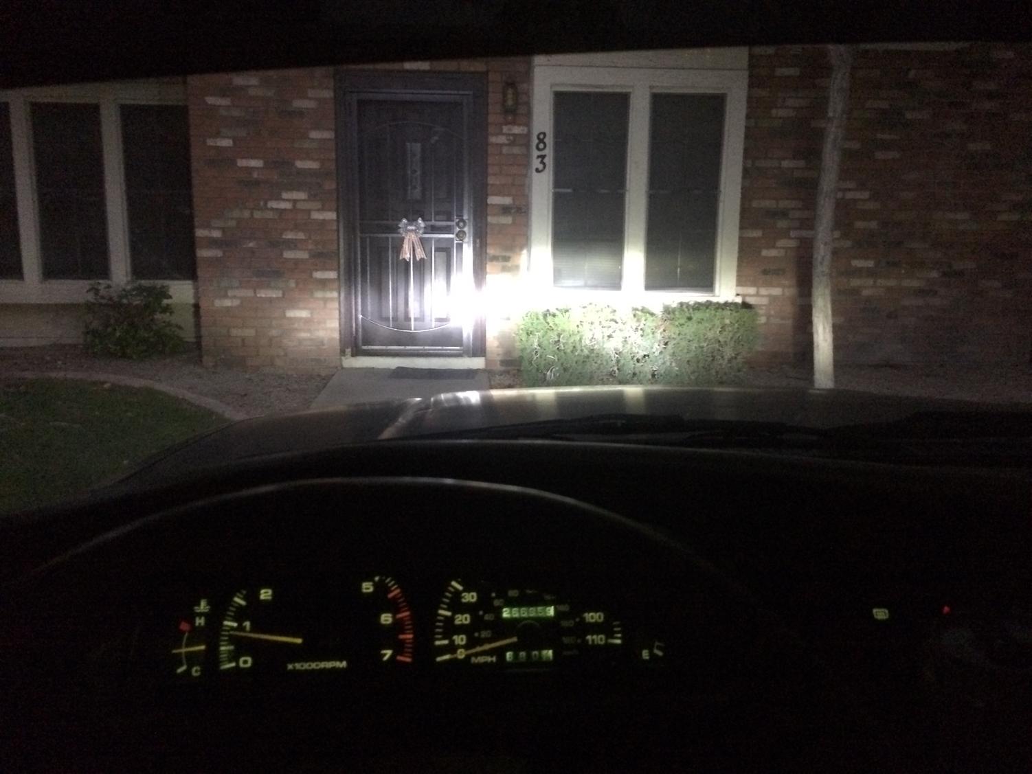

The low beams are worlds better than the stock halogen. The high beams could be brighter, but are still better than stock.
They're not going to make the sun hide but so far I'm impressed. They have the wonderful crisp on/off we've come to expect from LED. You also have to factor in the longevity of LED. I've had my lightbar for years and it's still bright as heck! These seem to be just as bright if not brighter than my HID and I don't miss that warm up period common with HID. $45 for one so you need to order 2. Not for everyone but just fine for me! I'll take another pic at night. BTW my windshield is tinted.
Seems bright than halogen. Can you get a picture in a road? Like to see how light scatter around the road.
Thanks
Sorry guys been lazy on the pics.. I'm currently building my off road trailer so that's taking most of my time. The LEDs seem to work well, they put more light on the road than HID but don't seem to push out as far. Overall I am pleased with them.
Why are you expecting a cutoff? It's a LED bulb, not a projector.
Exactly.
Halogen bulbs don't have a clear defined cutoff either (compared to projectors) when placed in our reflector housing. My LED headlights do not glare oncoming traffic anymore than my standard halogens did. Tested this out driving my wife's Honda Civic. Putting an HID bulb in our stock reflector housing will scatter and glare because the bulb is not designed for the housing. The LED bulb on the other hand is designed so that the LEDs are placed in the same staggered location that the 9003 halogen filaments are located, thus utilizing the reflector housing as it was intended and not scattering light all over the place.
They are not bright to oncoming drivers. I have already checked that. I'm not a rude person like that to blind people at the expense of more light. There is no cutoff, they are not projectors. I have had them for a few now and thoroughly enjoy them.
Thanks for taking the time to give us feedback. They're pretty cheap, may just give 'em a shot when my piaas go south which can't be too long, lol!
So this is just bulbs ? Take old ones out pop these ones In? They seem to shine pretty good by looking at the pic above. However, I woulsnt want to blind on coming traffic. I know how that feels.
