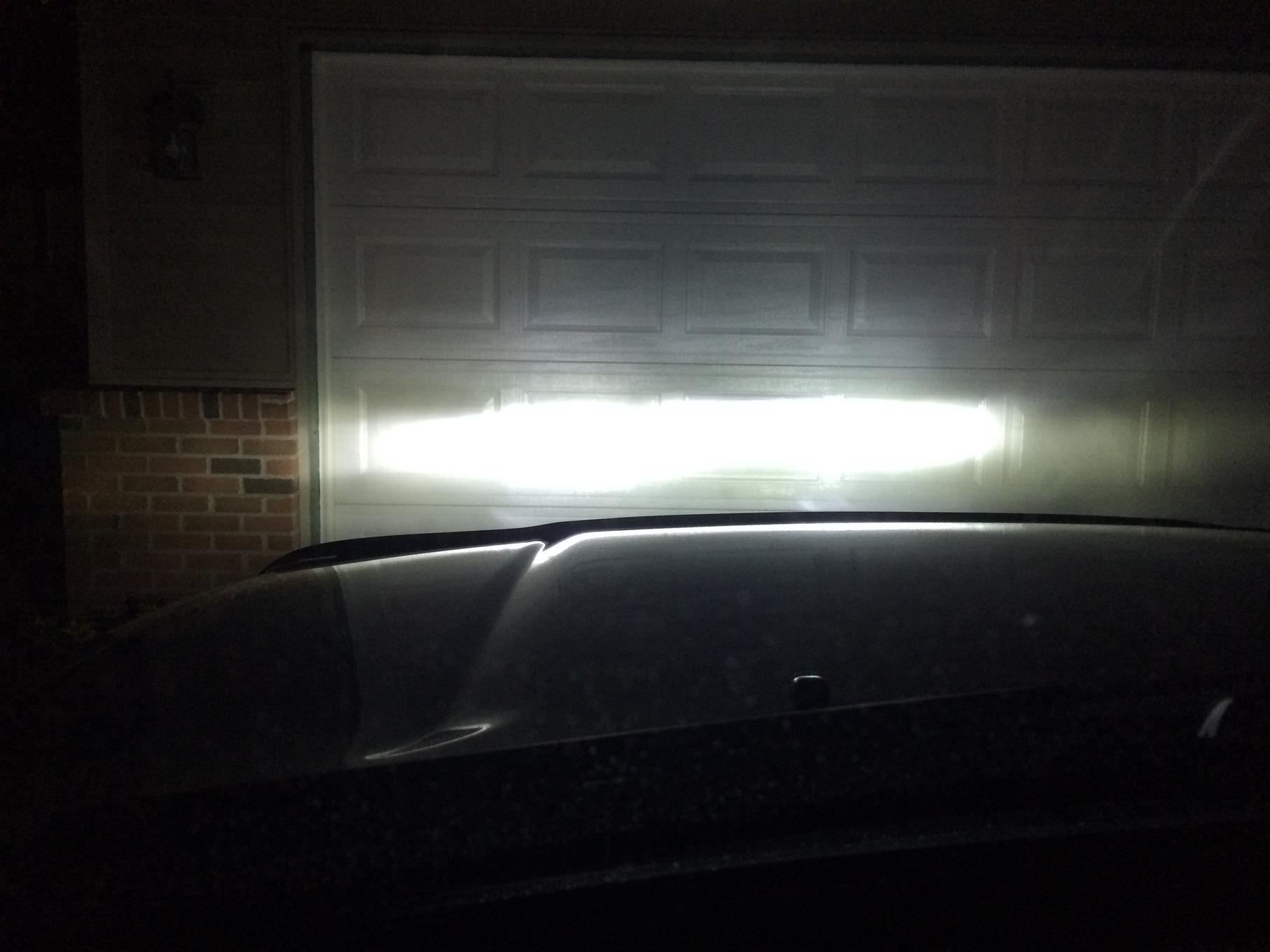

Here's the output

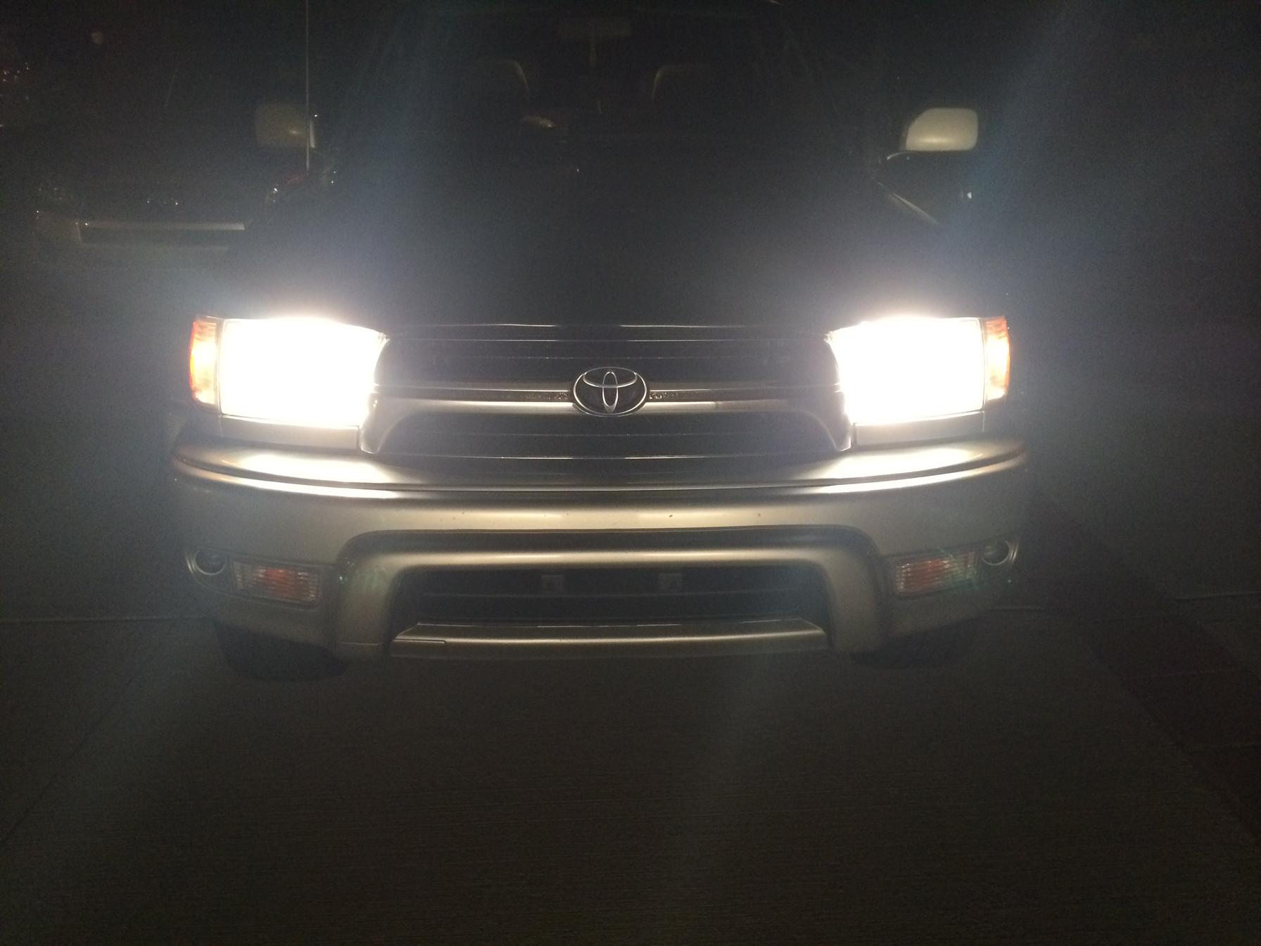

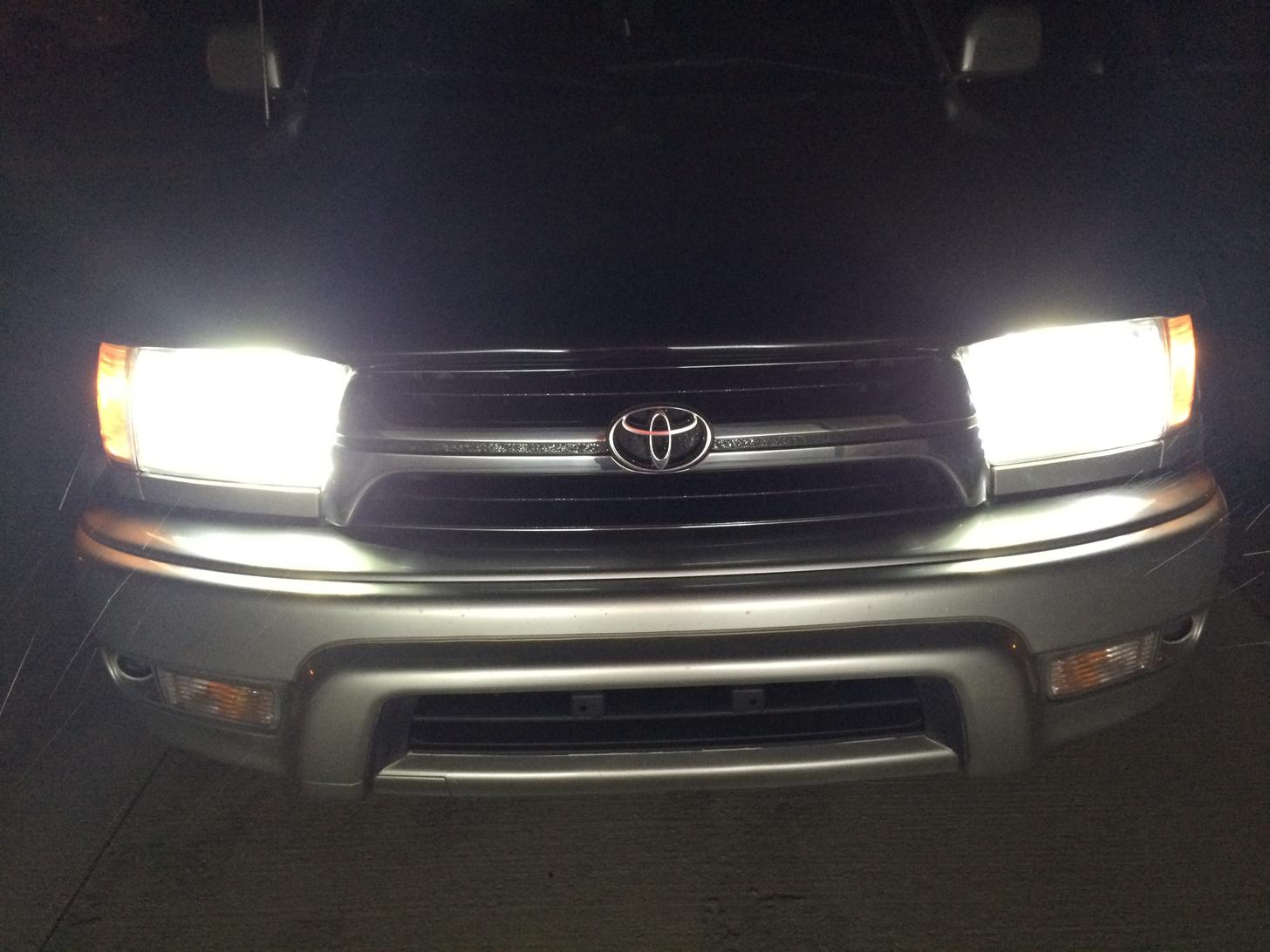

Here's looking at the rig. It's brighter in the pic than in person. Couldn't get rid of the glare on the camera.

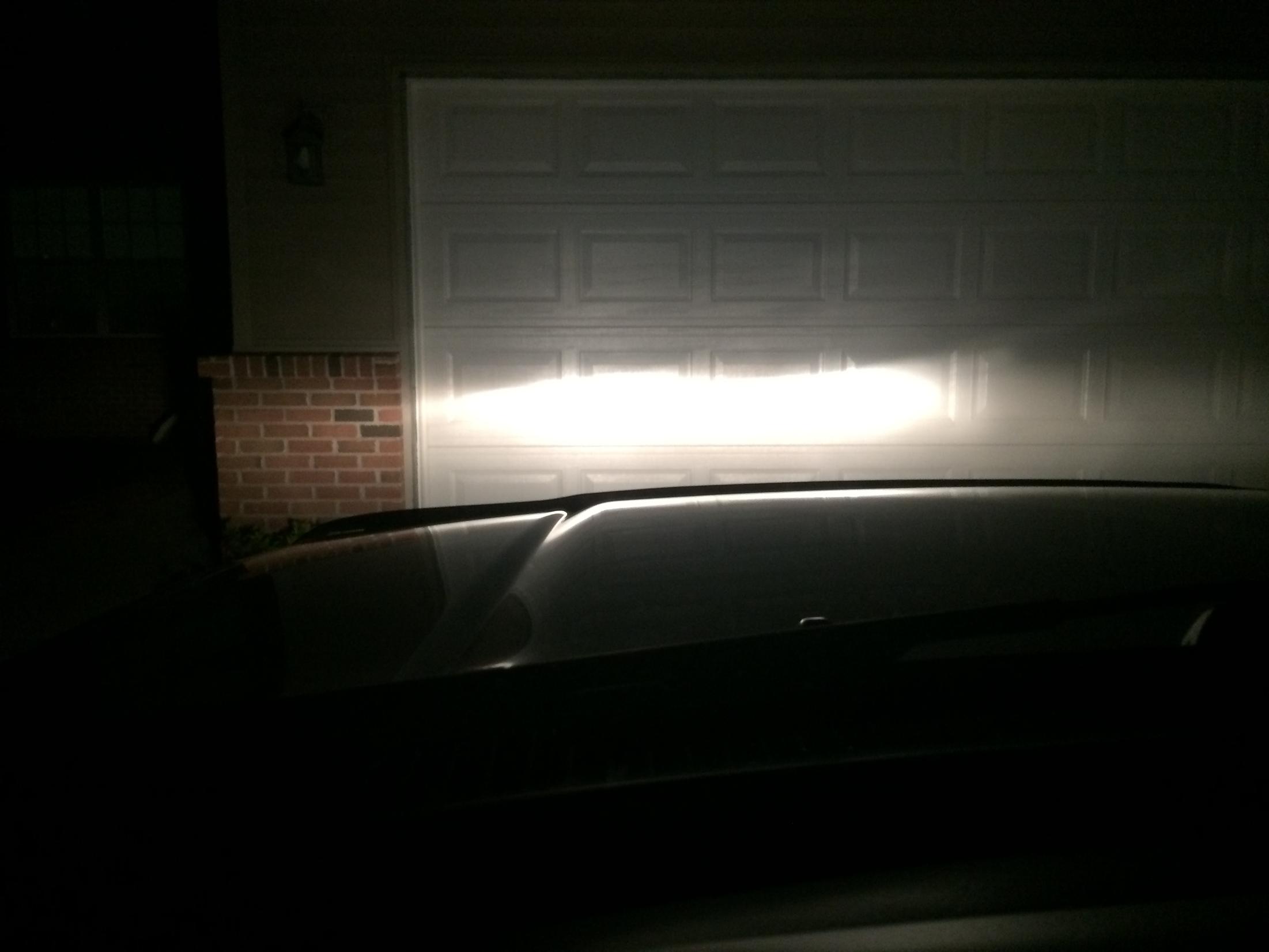

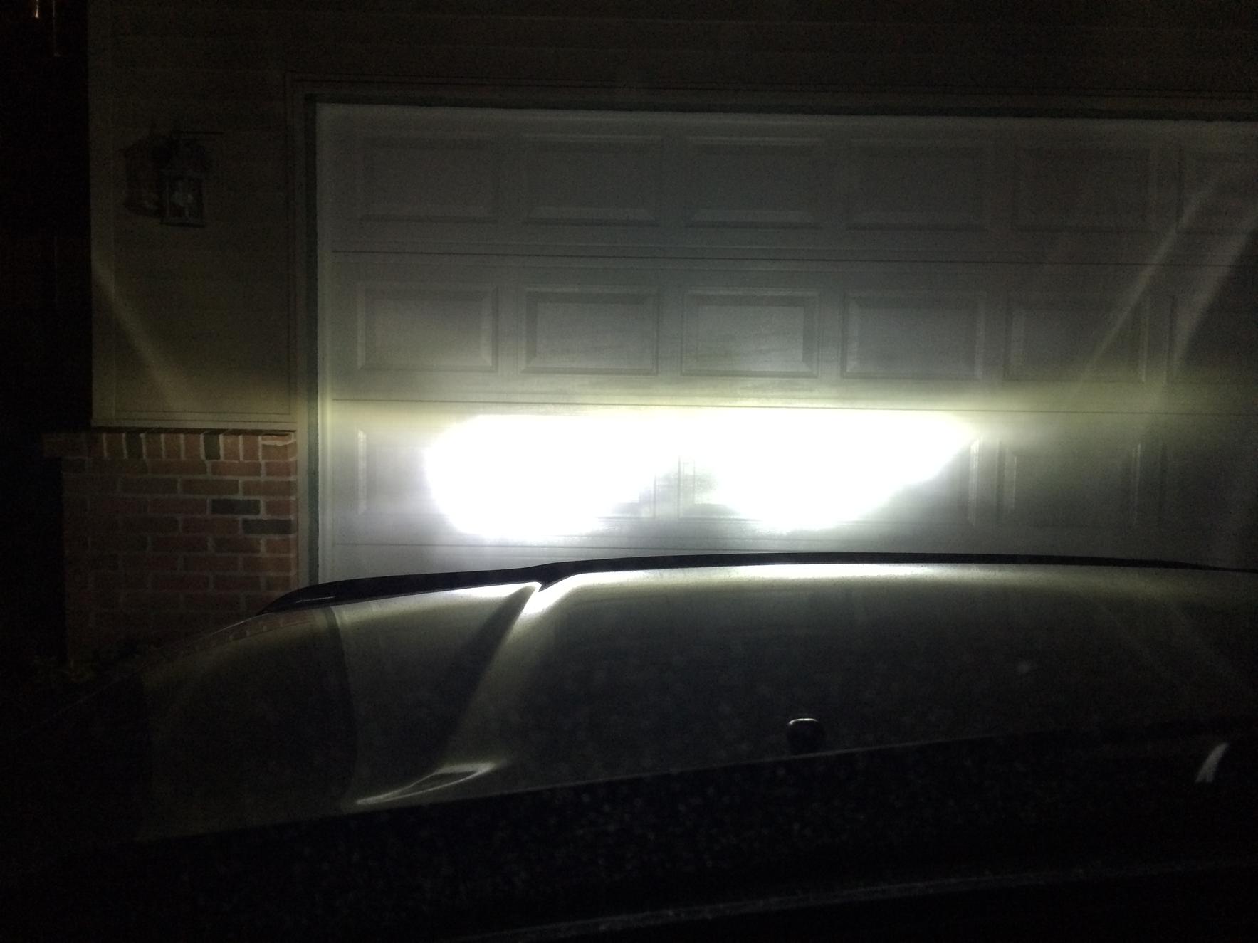

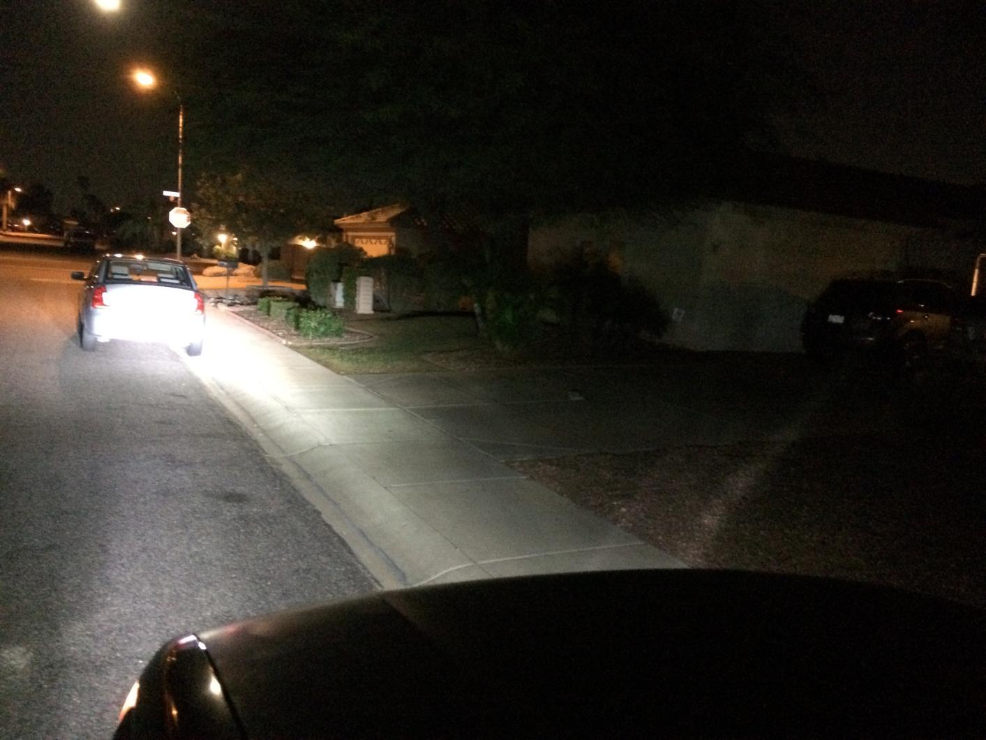

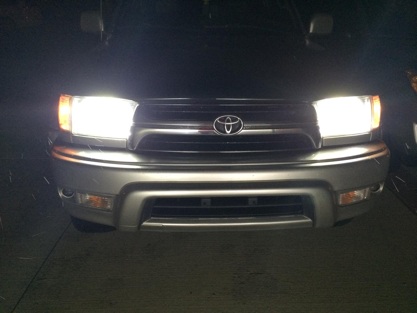

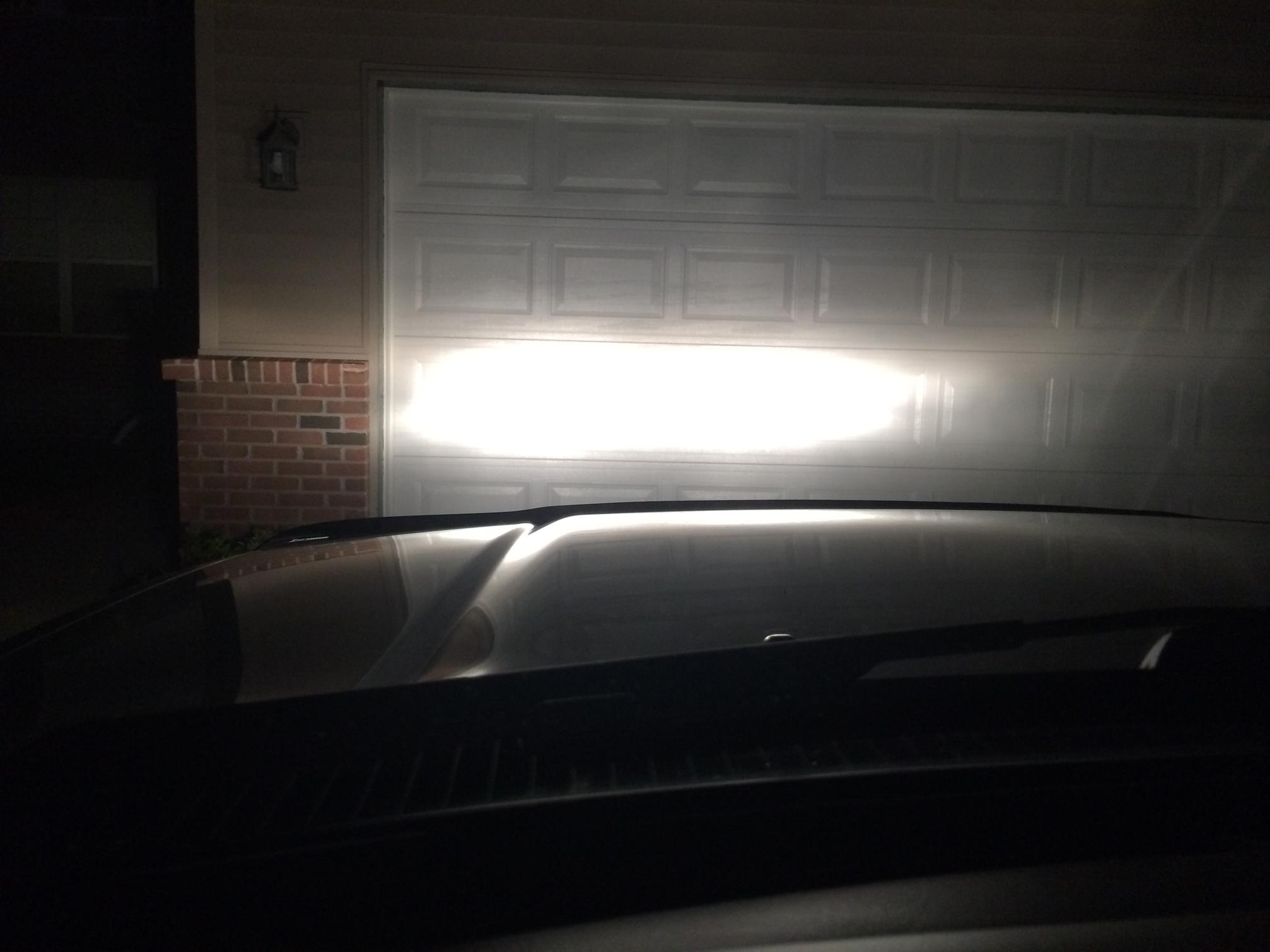

Anyways, I just got off my night class and going home I felt so much better because these headlights are a lot brighter than my Philips Xtreme bulbs.

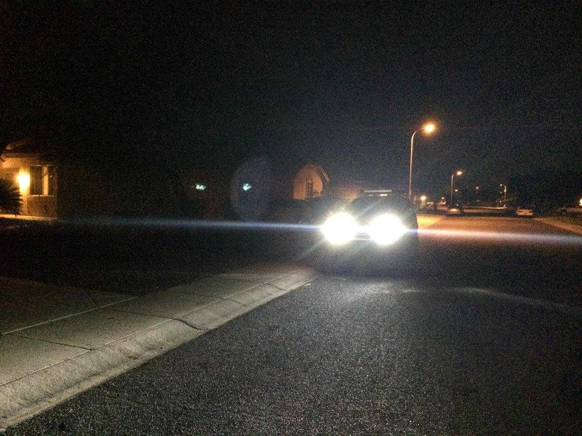

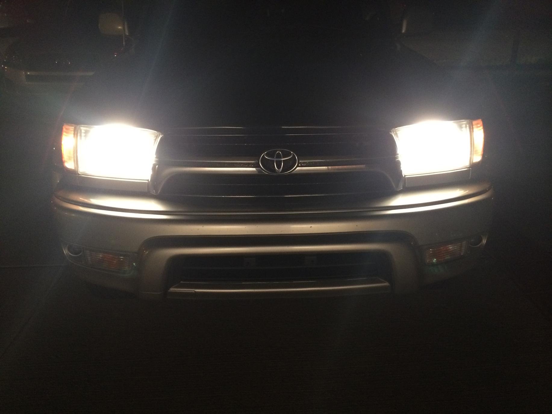

Pictures go from Old, New, Old, New and so on.
I didn't get pictures on the road cuz I was too lazy to stop lol. And, I forgot to take pics using my old ones so there wouldn't be any comparison.
I wish there was an easier way of making the pics side by side: Old vs new
so you could see the difference better.
I bookmarked this thread so I can also update how long these will last.
