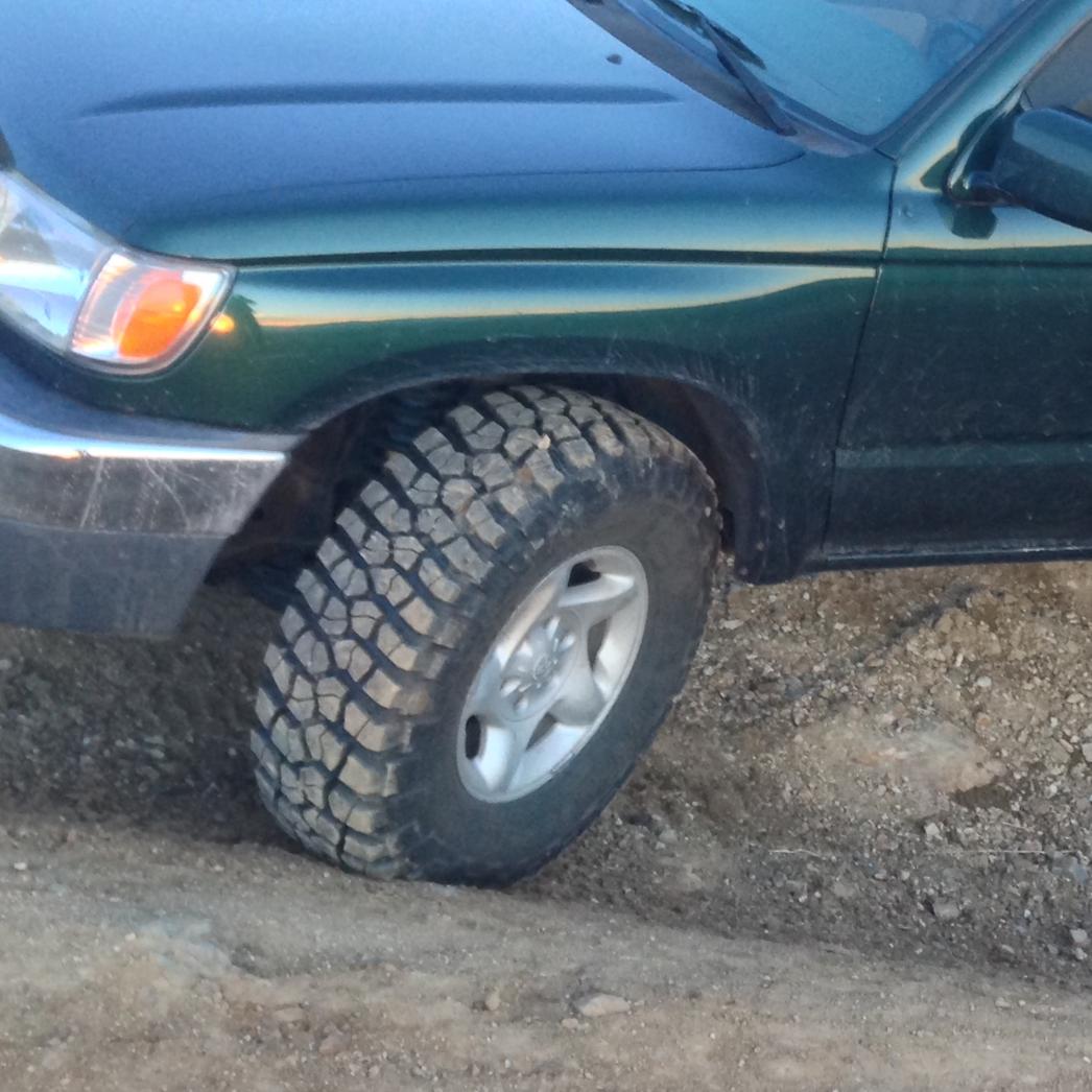

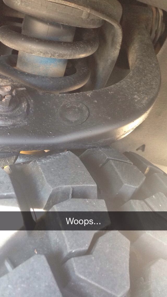

So after lots of tests the only problem I have encountered is backspacing. When the wheel is fully turned under flex/droop the lugs barely rub. Turning fully locked is bad anyways so I do not do it. Other than that I've only rubbed my mud flaps which has done nothing. I have pro comps coming in the mail with 3.75" of backspacing which will fix my rubbing problems.
I know it is not flexed very much but this is the only photo I have, but there is plenty of room in there. It has grazed to plastic in the fender well which hasn't done anything more than make noise. So far I've only rubbed plastic and the upper control arms, so I'd say possible with no lift but with proper wheels.

IMO I wheel hard enough to get sufficient articulation that would cause rub. I have encountered situations in which I have to turn the wheel to fully locked and it had very minor rub on the UCA.
