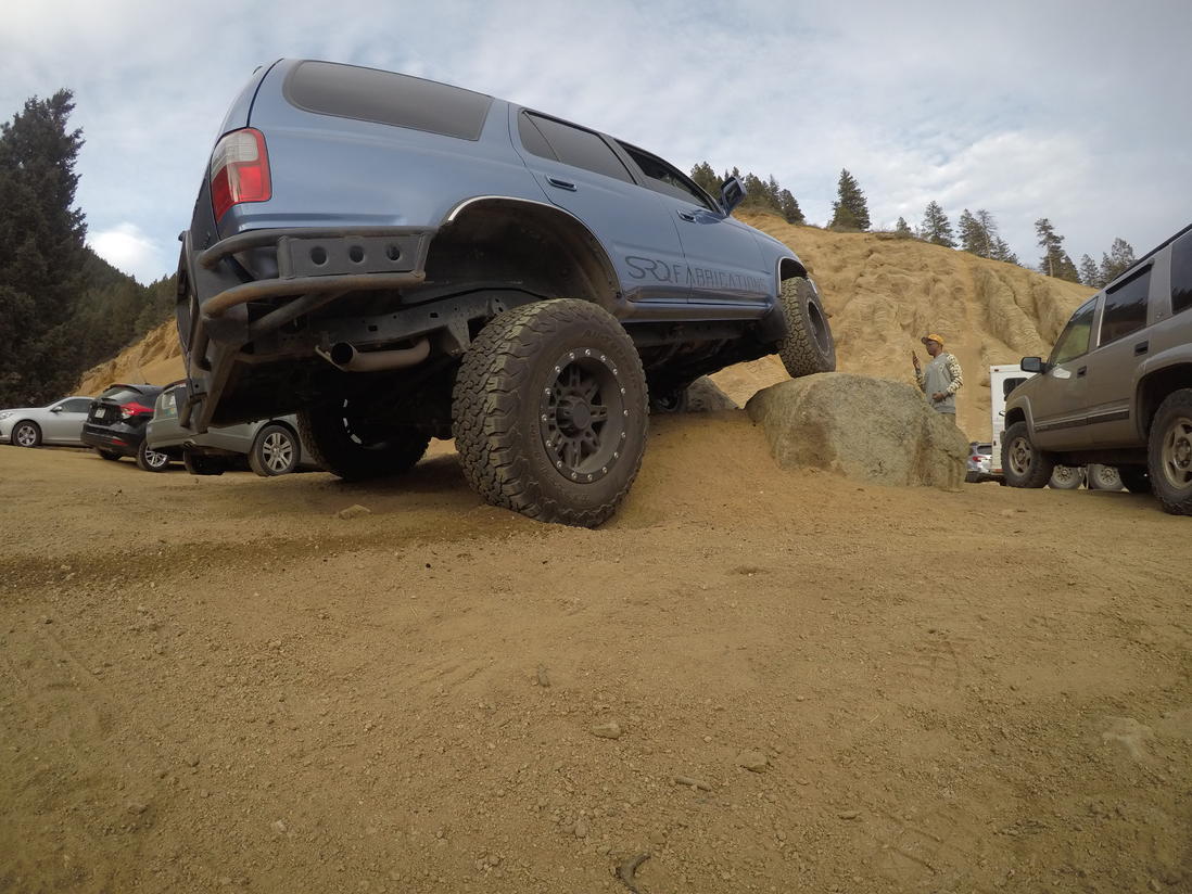

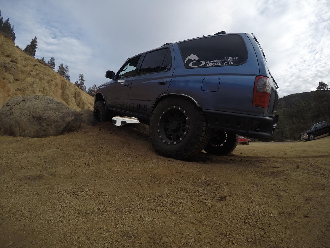

and for kicks, I'll add more to this dead thread with flex pics with 33s before lifts
