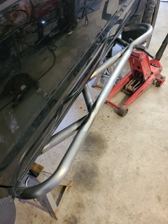

My Trail Gear sliders

It all depends on how you mount them, if they're turned upwards they'll be at a steeper angle closer to the body. I use mine to reach the roof rack, and as extra body armor to avoid pesky root wads of tree stumps....
Did you ask for extended legs or is that standard with them mounted flat?

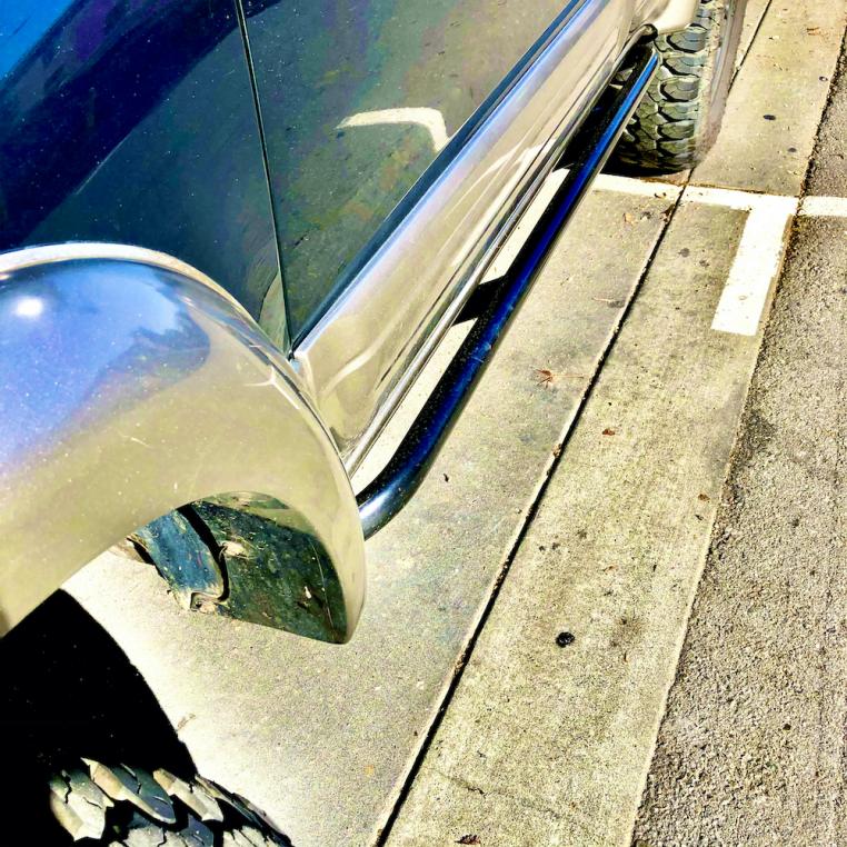

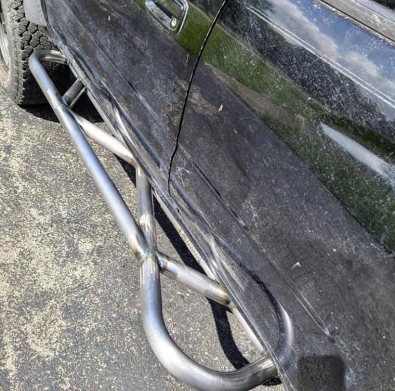

Just had this set of sliders built for the black pearl! Really happy with the design and the way they turned out!

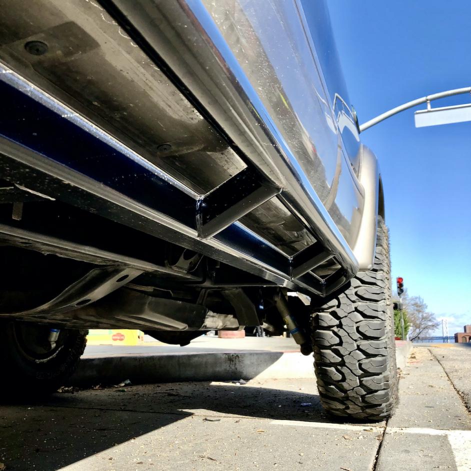

Some better pics of my new sliders
Holy old thread bump lol. They look good, but man that rear hole is a broken leg in the making.
Also to add, anyone know what happened to Stubbs welding? Hope he didn't close shop for good.

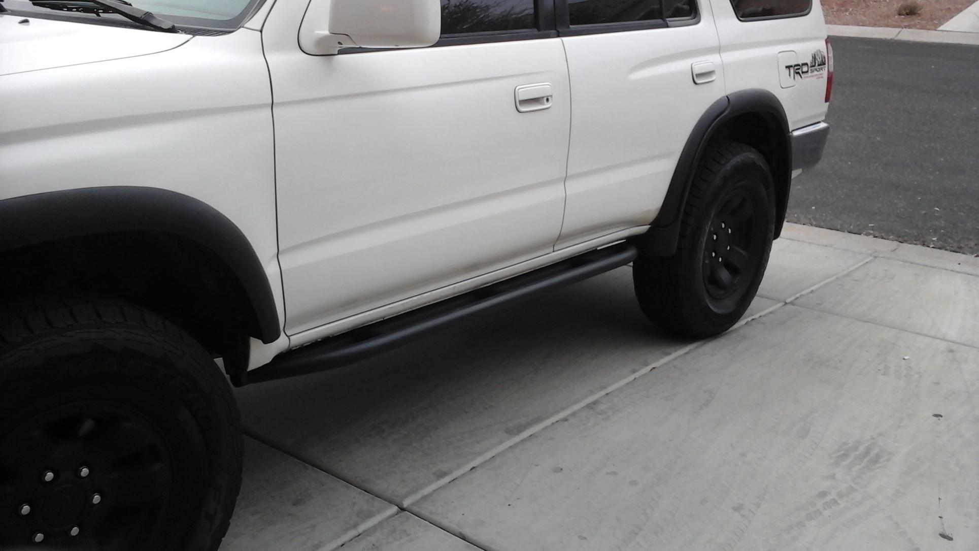

I like the 90 degree bends in front. I saw in your other post that you used 2 inch DOM? I wanted to use 2" tubing when I had mine built but only had access to 1.75" tube bender dies.
The 2in is definitely beefy, and also gives me a better platform to step on when I want to reach the roof rack. The sliders will be rhino lined and have skateboard grip tape in certain spots to keep them from being too slick. Still debating on tacking on some top covers
I say yes if you're considering it. Provides a little more surface area for a step and gives some protection from road debris.
Did your fabricator already have a 2 inch tube bending die? Mine didn't. I thought about buying one for him but later decided to just go with the standard 1.75".
Yes he already had the bender. He builds all sorts of different things for off-road vehicles so he was equipped to knock it out.
We talked about putting covers on with drain holes kind of like a perforated piece so water and debris drains off.

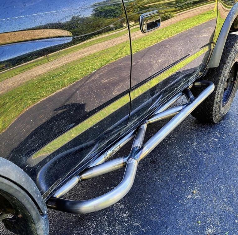

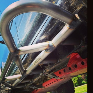

Seems like most sliders are straight out or slightly kicked up. When I did my 4XInnovation sliders I tacked the tubing straight out from the frame about 3/16" bellow the body seam. I then used jack stands to kick the slider up to an angle I liked. That happened to be about 5 degrees. Doesn't sound like much but it's definitely noticeable.
The Shrockworks are angled up at 30 degrees. Very tucked up into the body but nearly useless as a step. I wasn't after more steps - just protection. Naturally, a guy pulled away from the curb without looking and we made contact while my sliders were being still shipped to me. I drove up over him and tore off most of his minivan's plastic nose cone and only got some cladding scrapes and a dent in the front 1/4 panel. Wish I'd had the sliders - would have been golden . He was an older hood-geezer without any insurance (or license?) and we called it a wash. Urban struggle.....
