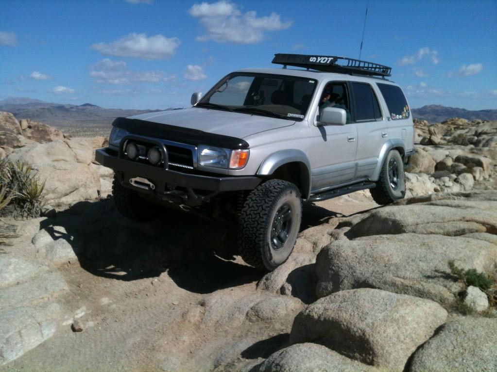

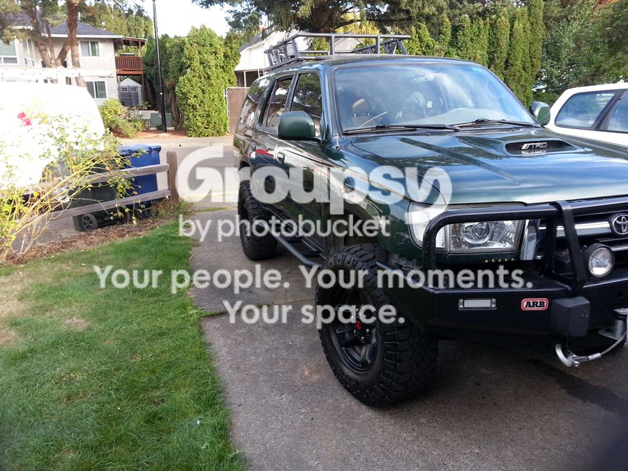

I have my trail gear sliders tucked up and in about as much as I can, with the angle on the outer bar sort of filling in the gap a bit. You'd have to know that there were originally running boards there to notice them missing.
IMG_00000552_zps49e811b4.jpg~original
IMG_00000551_zps7f2ba10a.jpg~original
Looks like you got some rub there in the front. Mine are out further to help push the vehicle away from obstructions. They are still inside my wheellbase. I run 1.5inch spacers on my wheels as well..helps with rub..

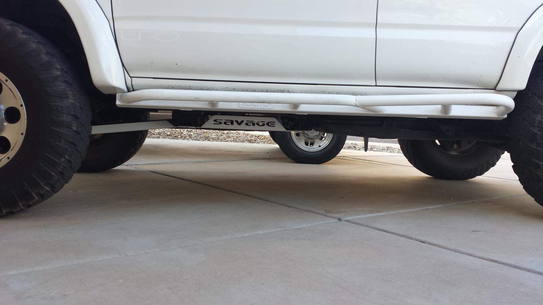

Look at the overall length of whichever brand you are interested in and then measure it out on your truck and you will know for sure. Savage for example builds his 68" and that will go basically the full length of the rockers. Most other brands are shorter.

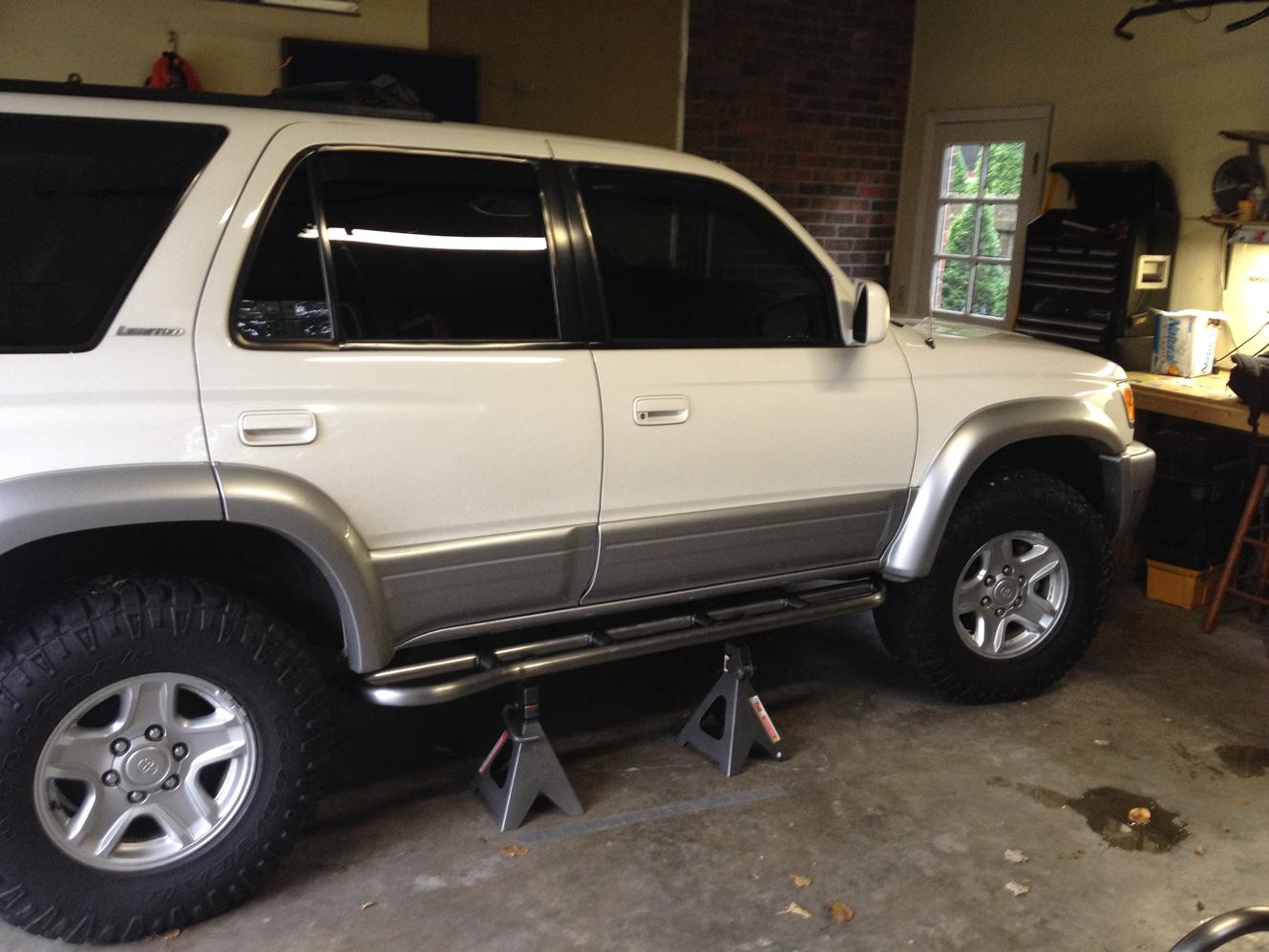

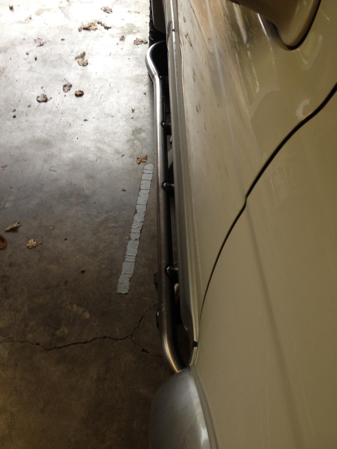

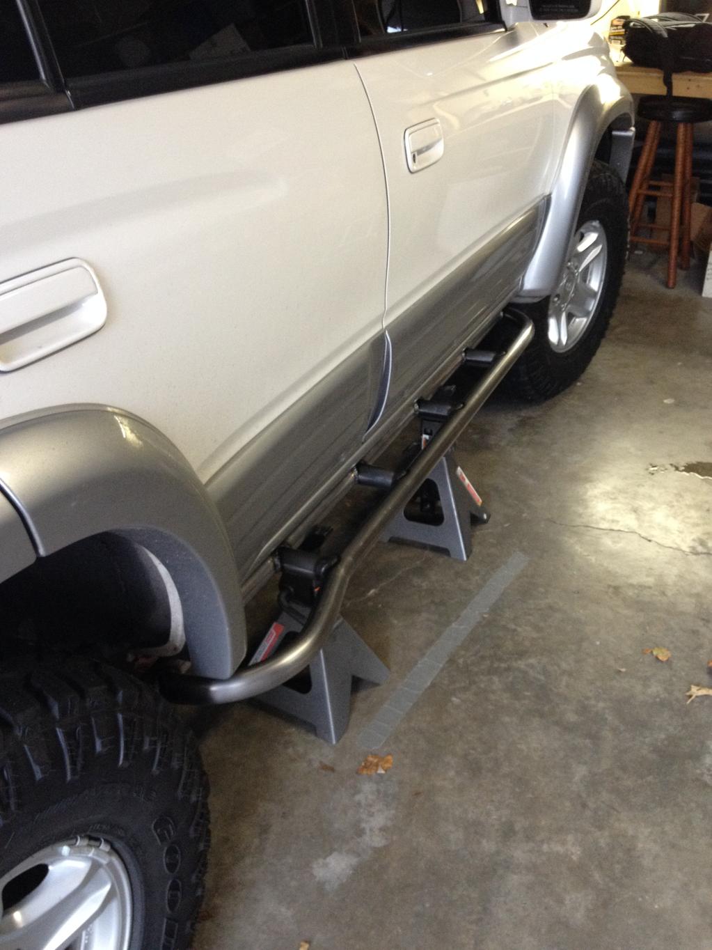

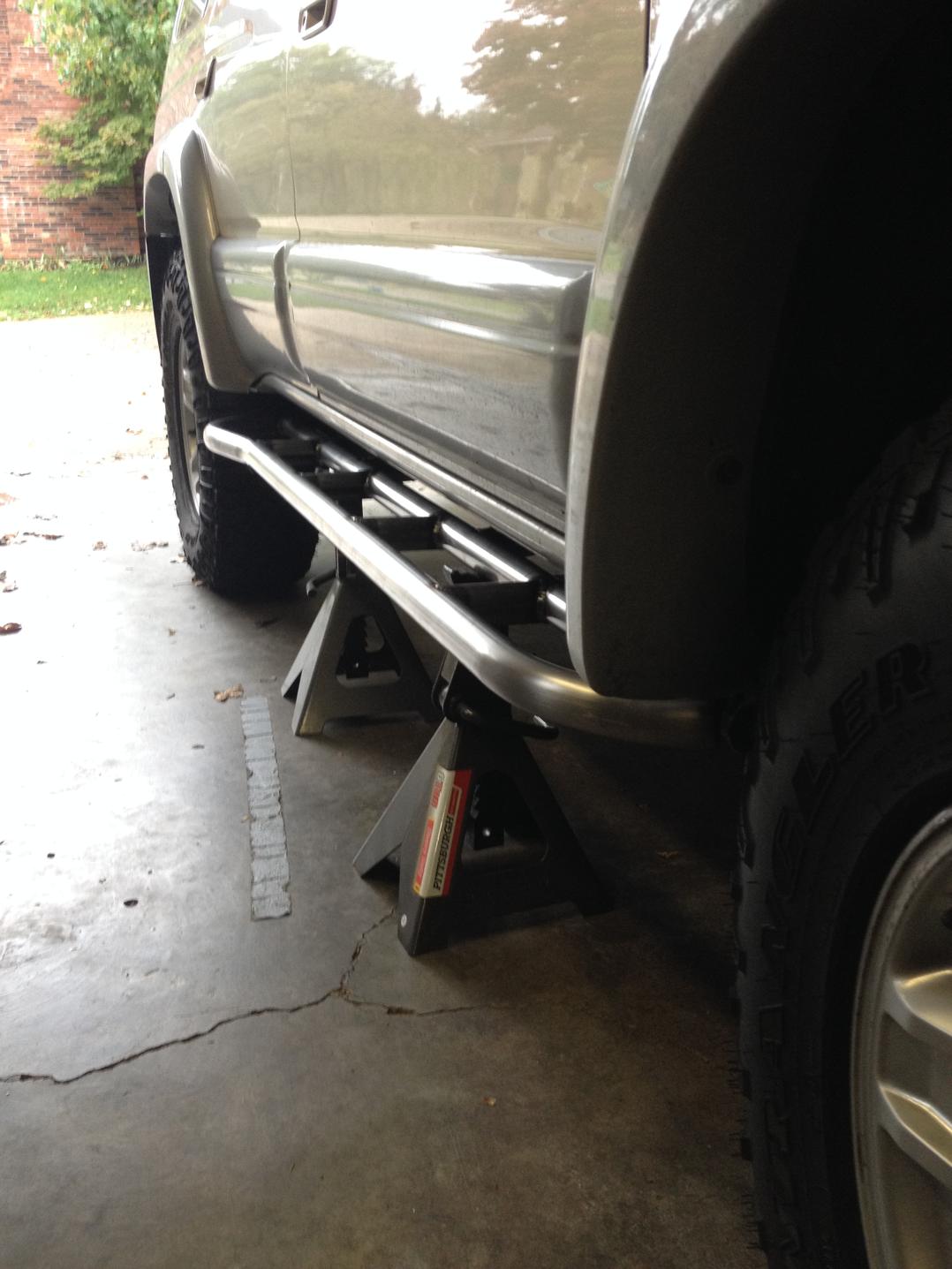

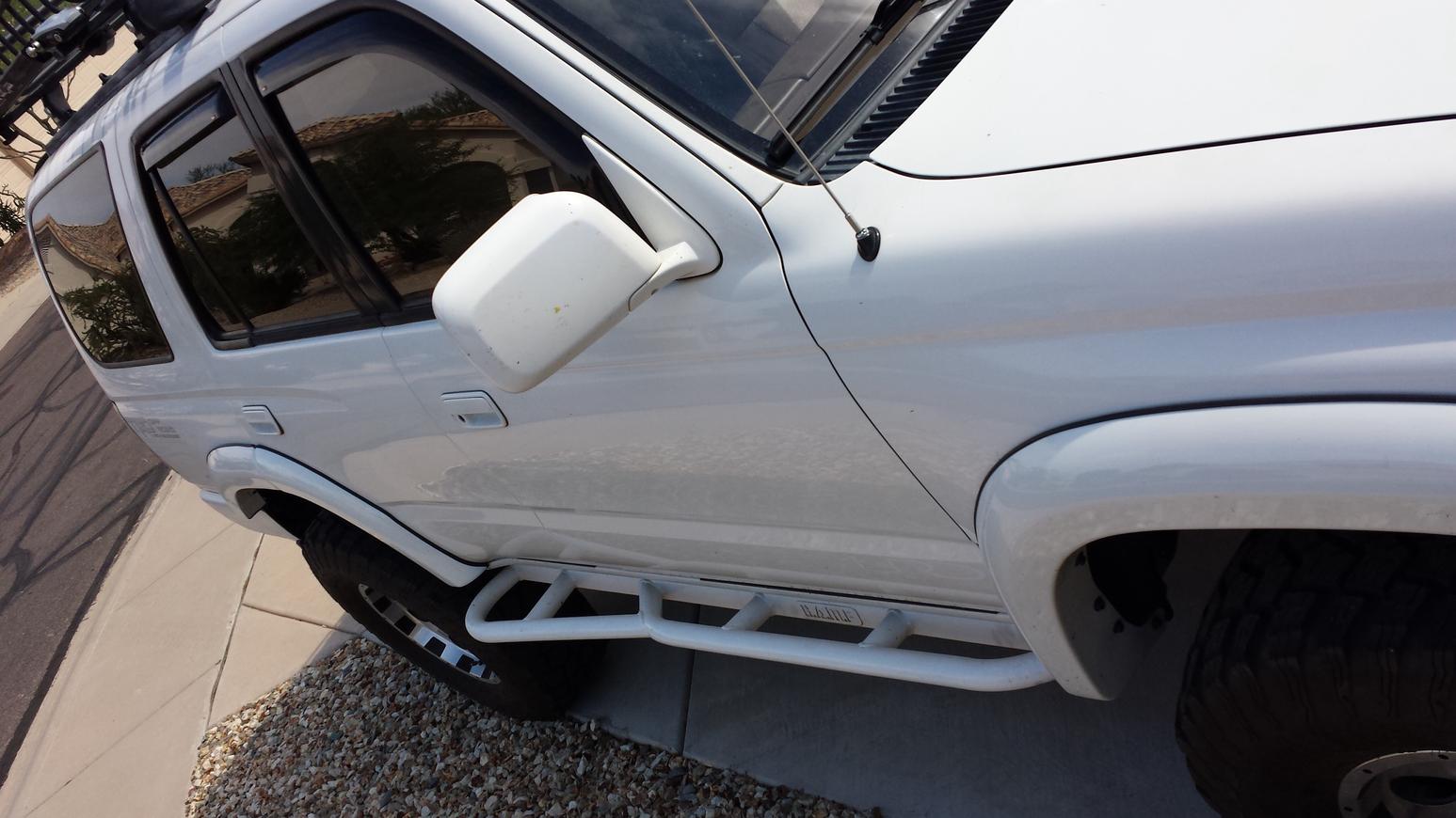

I received my Savage sliders with kickout yesterday. Here are a few mock up pics I took today on my 99 Limited. I might be able to get them up another 1/2" - 3/4". They do not stick out as far as the old running boards. Probably about 1" in.

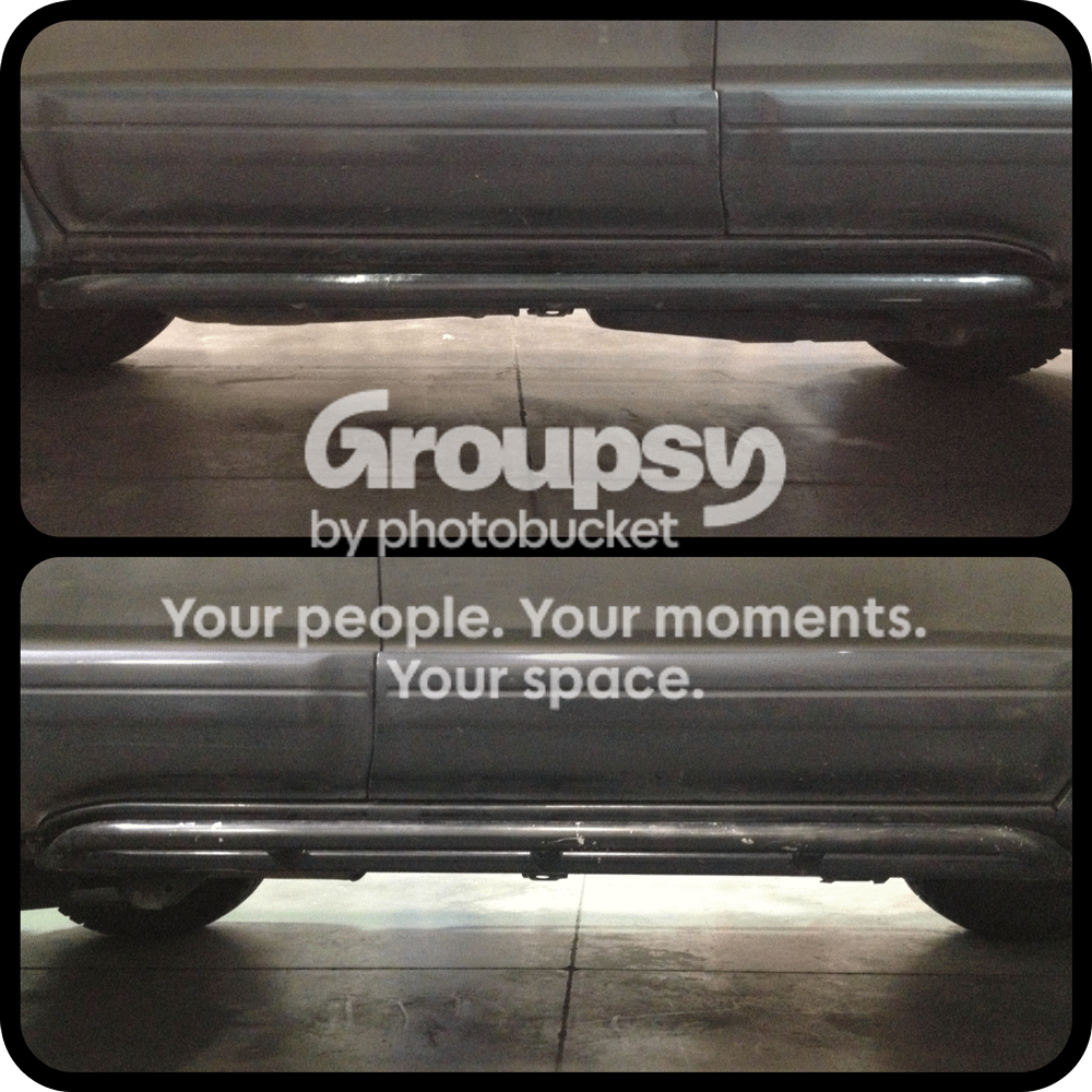

I originally built mine with a little more "step" than "slider"...I then decided to tuck them better.
Around here, there is not a ton of call for kicking-out, so I'm happy with their final design and location.
a couple B&A shots:
IMG_3349_zps22292b20.png~original
IMG_3348_zpsda9ea690.png~original

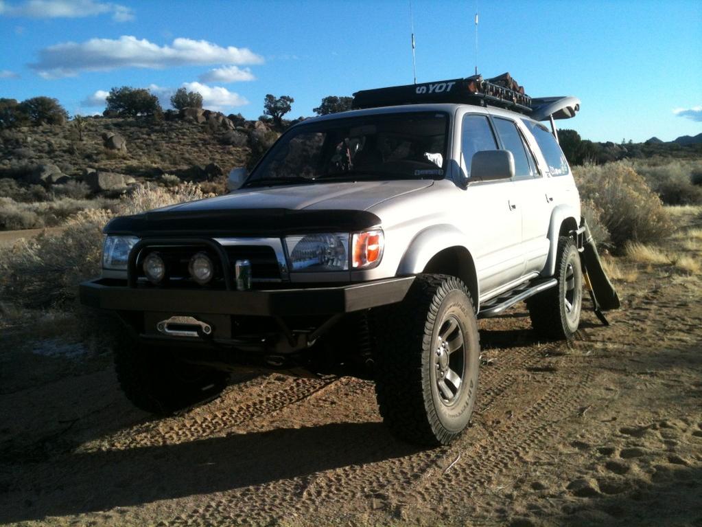

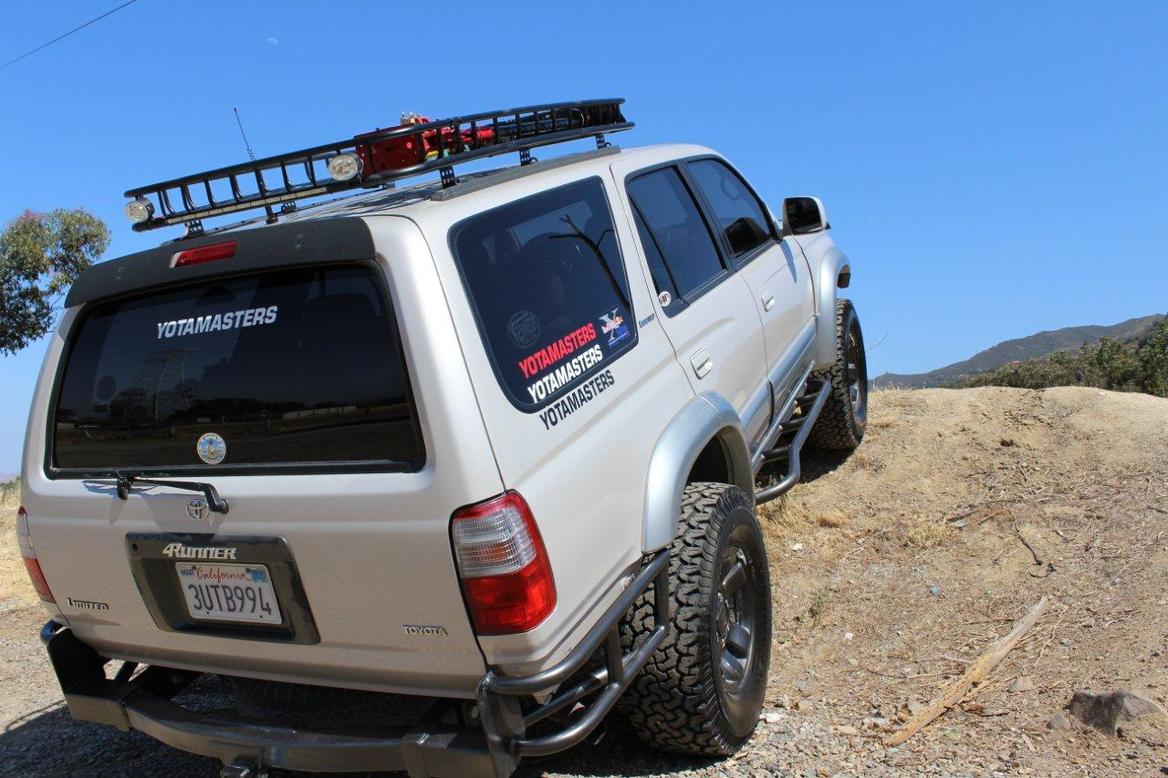

It all depends on how you mount them, if they're turned upwards they'll be at a steeper angle closer to the body. I use mine to reach the roof rack, and as extra body armor to avoid pesky root wads of tree stumps....
4x Innovations:
20141010_161515_zps10959f38.jpg~original
