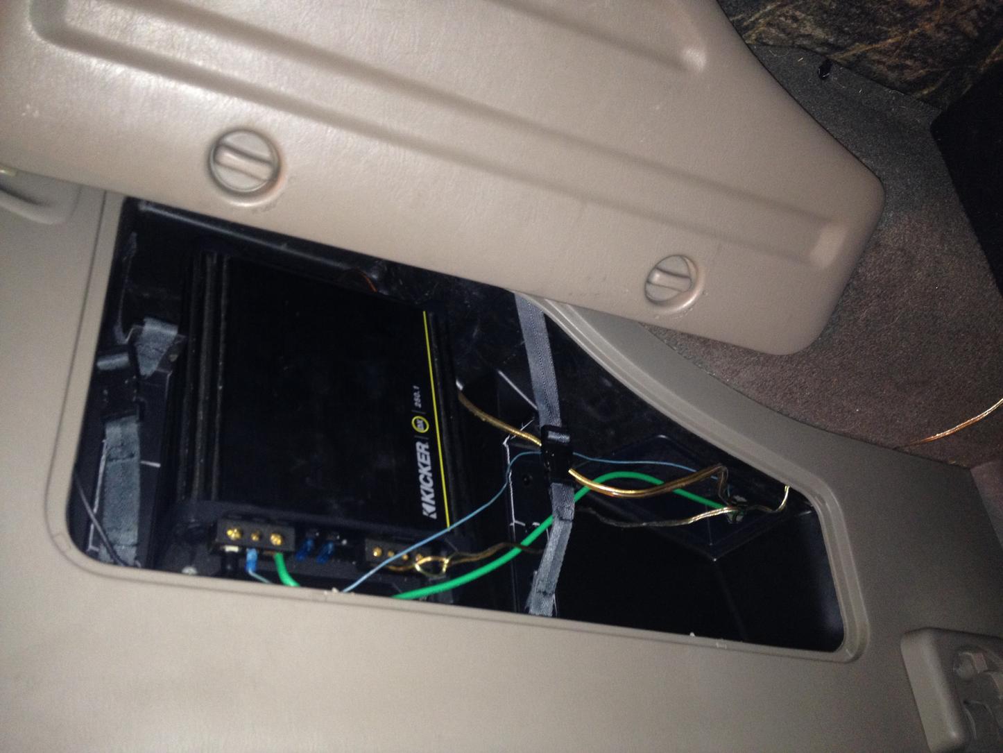

I've got 1 12" kicker in the back, it's enough for me and I've got the kicker amp in storage area at the right of the trunk

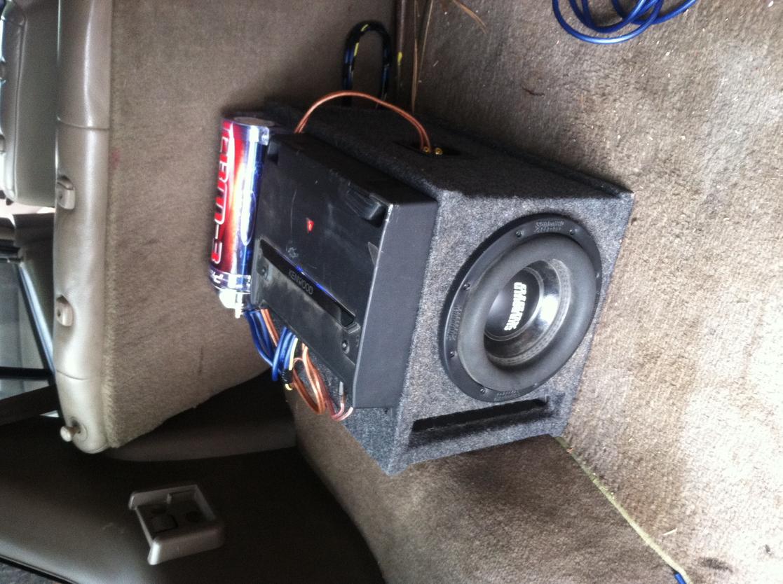

8" Sundown Audio 1000w DVC in a 'Labyrinth' ported enclosure. It's pretty small. 0.8 cu ft. It sounds like I have a 12" In there, no joke. And amp/capacitor are mounted on the enclosure, along with an extra 6' of neatly wrapped extra lead. So I can move it anywhere in the vehicle as a unit. I put it in the front seat when it's time to crash out on the back, without unhooking anything.
