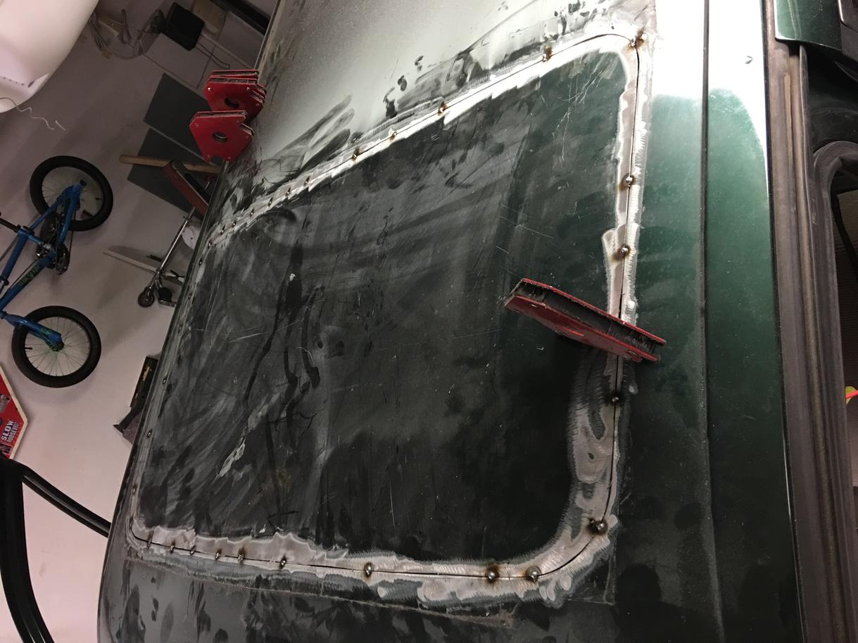

IDK Tim, that seems like a lot of work. Caulking might work better
