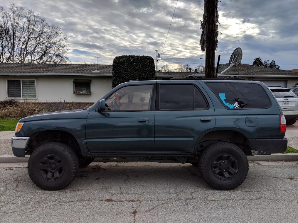

Tim, your videos are great! With the help of them I have just completed the following repairs to my 3rd Gen:
Front Suspension
Replaced upper and lower ball joints
Replaced the upper and lower control arm bushings
Replaced the steering rack and sway bar bushings
Replaced the CV axles with remans
Replaced the front differential oil seals
Installed new Bilstein 5100 shocks, giving the truck a ~2" lift
Rear Suspension
Replace the upper and lower control arm bushings
Installed Bilstein 5100 shocks and Old Man Emu 2906 coils
Next up will be the timing belt/water pump, and probably the Tundra brake upgrade. Thanks to you and Sean for the very helpful and informative videos, which has turned a non-mechanic into someone who really enjoys working on their truck!
