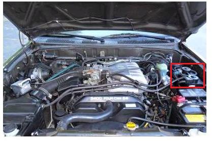

I believe this is what your looking for. It's right under your battery.
I think on the 96-00 it's actually this which is located behind the battery outlined in red (not my picture).

I'll add that the 96-00 canisters like to crack around the base. Almost impossible to see the crack(s) but super easy to repair with some RTV.
I fixed mine up just fine. I did notice once though that after I tried to wedge an old oil rag between the EVAP canister and the fuse box (always checking my fluids and like to keep a shop rag under the hood) I got an EVAP code 45 minutes later. I pulled the rag out and cleared the code; it never came back after that. I think the pressure from the wedged rag allowed a crack to be exposed again.
