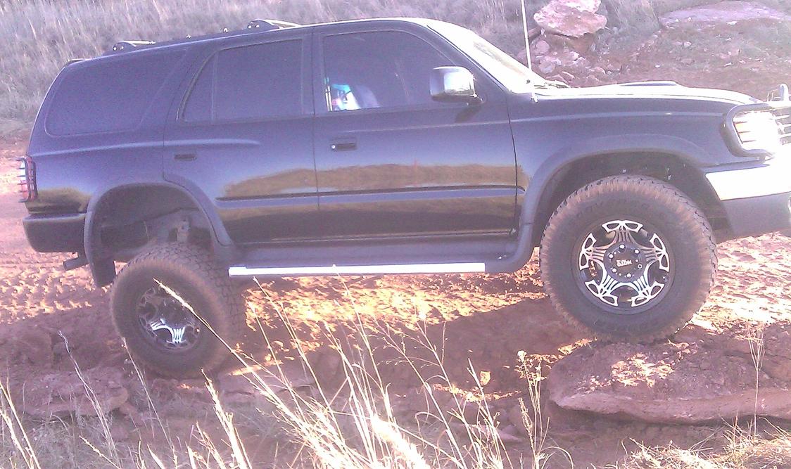

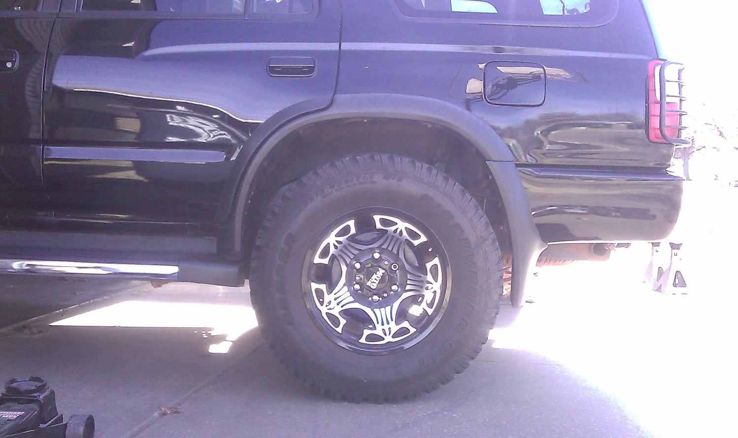

there is a pic of rear stock and and other of it lifted but thats about what it will be on front or maybe a lil less clearance
and not sure if it helps but i bought the rims for the tires and truck and they are -16mm offset from the center of the rim
