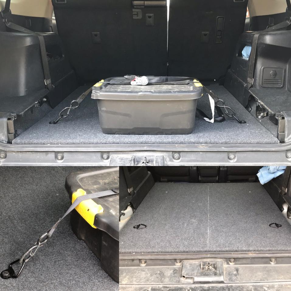

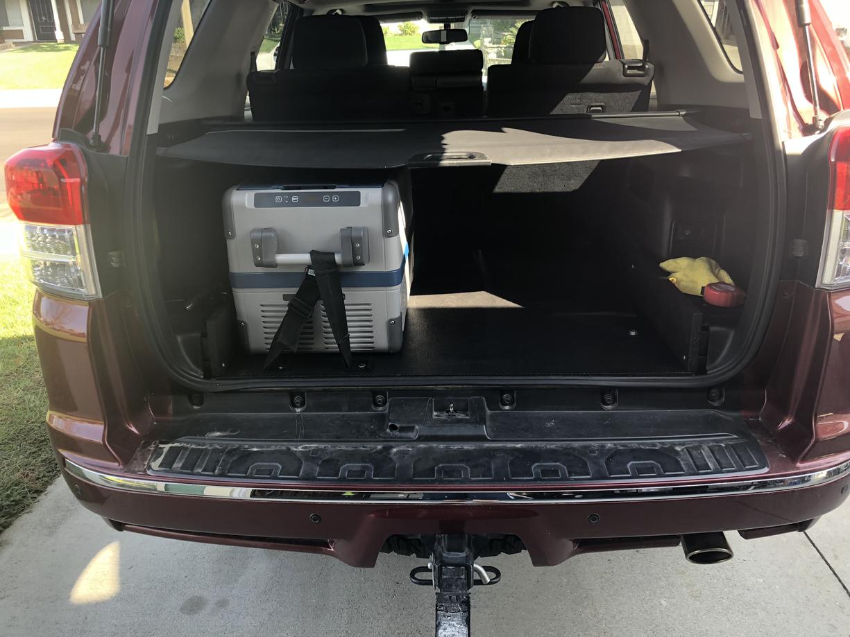

Deleted 3rd row makes more space I made this bottom platform got the idea from goose gear but they sell there’s for $500 I paid maybe like $70 and it selves the same purpose

Thanks. That’s exactly what I had in mind. I wonder if there is a different solution to the vertical side boards.
Is the base perfectly square? Or rectangular I guess?

Look up GEAR GOOSE BASE PLATE for 3rd row seat delete I made it the sale way with side looks a little funny but if going to put drawer you won’t even notice

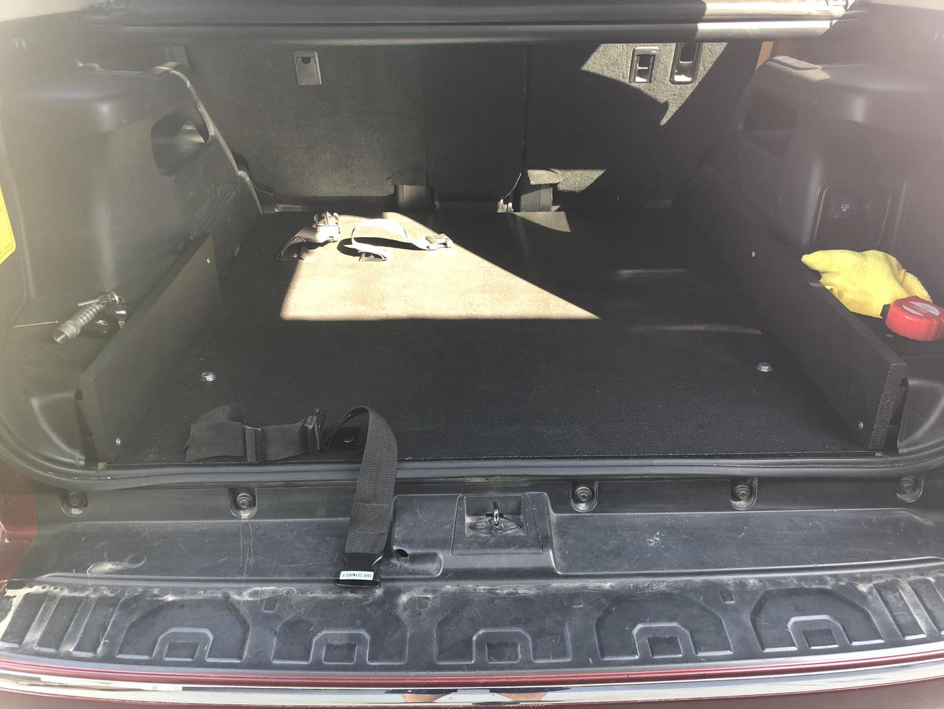

Not my best work but it will do for better cargo handling. I need to do something better for the sides though.

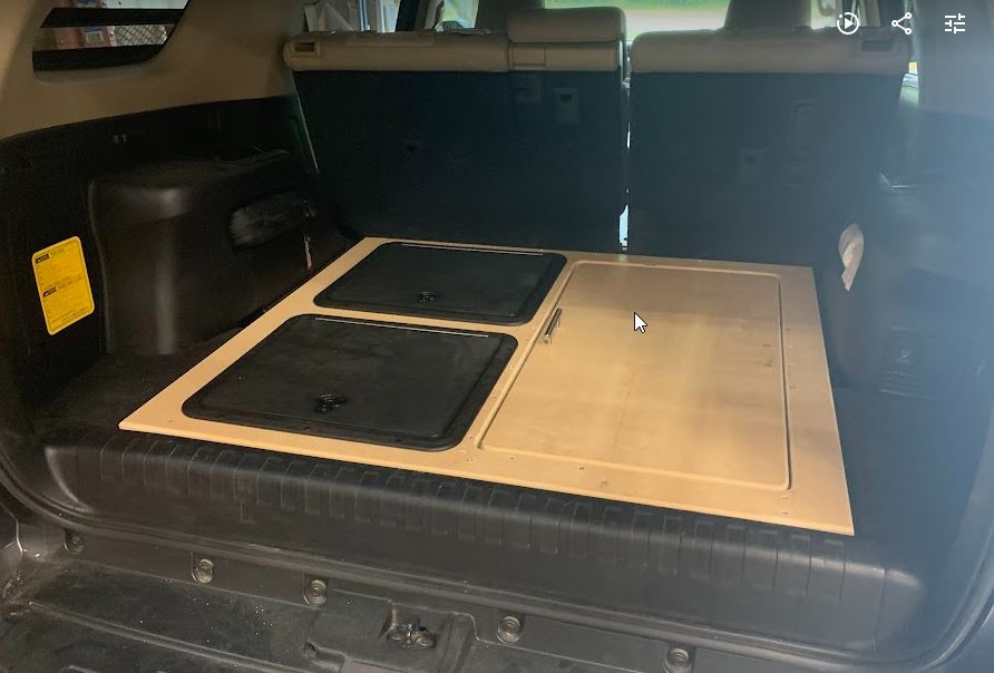

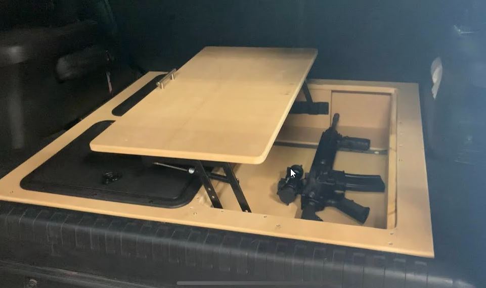

I think this is a new idea but I have not searched everywhere

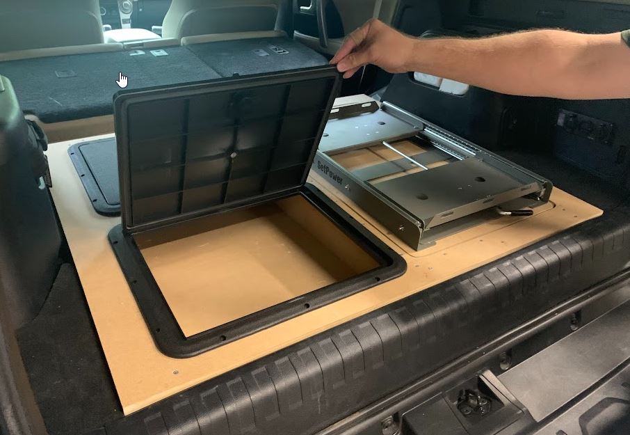

Still a work in progress. Goal was to remove the seats and use the space without cutting the stock pieces at the rear. Adding carpet this week and mounting the fridge slide. Fridge is a smallish SetPower AJ40 and will actually lift easily while attached to the moving platform. Foam cutouts for the rifle are in process as well, but of course, you can place whatever you want in that space.

[MENTION=655191]trailracing[/MENTION] that is flippin' amazing -- clean, useful, and just what I was thinking about for my 3rd row storage! Bumping an old thread to ask: can you give us a little more info on materials/construction for that mod?
in the pics that trailracing posted above, what are those two plastic door/port things called on the left side of his platform? i think i might try a simplified version of this but i'm having a hard time figuring out what to search for. keeping the surrounding factory trim looks great too.

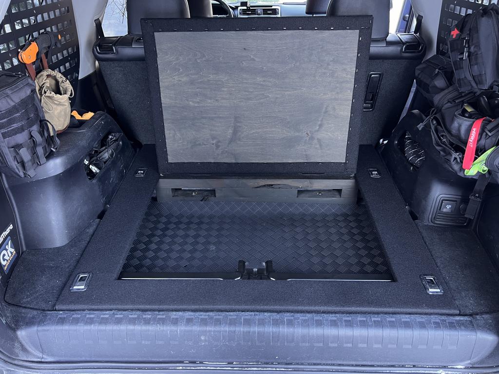

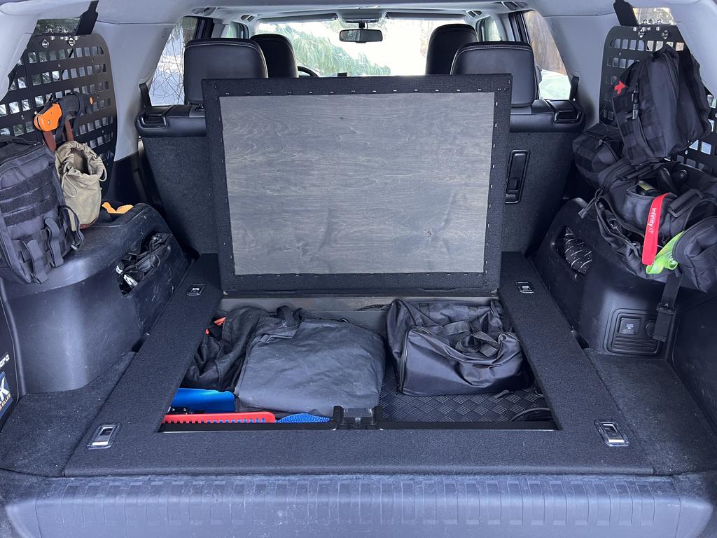

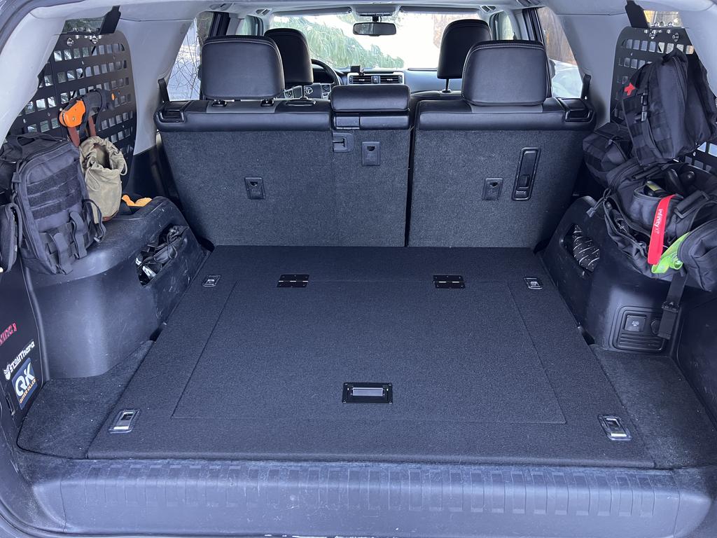

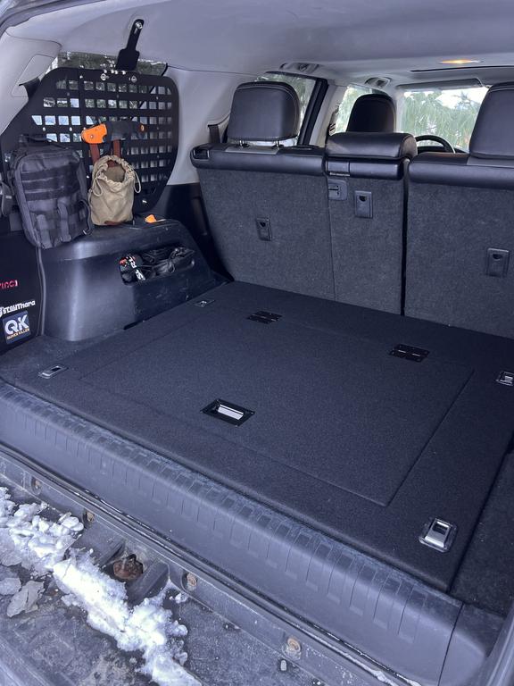

3rd row delete to hidden storage compartment - factory look
Here's my project completed. The goal was to keep the original height, keep as much OEM parts as possible and a factory look. Here's my parts/material list (purchased in Canada). Took way more time then I expected, but I'm happy with the end result. Cheers!
Parts/Material List
Aspen Plywood ¾ - Home Depot
Carpet Fabric– Amazon
Rectangular Mat – Home Depot
Sounds Deadener – Amazon
Colle 3M Spray 77 – Home Depot
Wire Loom – Home Depot
Door Hinges 3 ½” – Home Depot
Flush mount Handle - Amazon
2 x M10 Bolts with Washers to bolt frame to floor
2 x M10 rivet nuts
2 x Lag Screws for front mounting points
1 x M6 bolts for rear mounting points
oh I like that shelf / storage option. that's very nice. I went with aspen when I did mine as well. 3/4" definitely much better. was a bit concerned aspen wasn't as hard as birch or oak/ maple etc. but overall it has held up well. I have a waterproof carpet laid out on top of it, a moving blanket and a rubber floor liner that doesn't quite cover it fully, hence the moving blanket. and so far all good after a couple years

Holy hell that looks factory! Amazing work, I've always wanted to do something like this with my useless 100 lb third row

I can't PM you, but I appreciate the materials list. Do you have any dimensions or measurements of your build or writeup? I would love to try and do something like this. Thanks!
