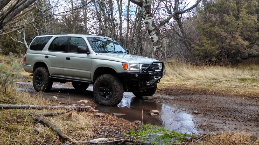

[MENTION=123439]panda4r[/MENTION], I have the exact same 4runner. It had 225/75r15's on it when I bought it. I have since installed a 3" lift, AOR front bumper with Warn m8000s winch, Stubbs sliders, and Shrockworks skids (full set)...so quit a bit of extra lbs for the little 2.7. When I installed the lift, I installed a new set of 235/85r16 Duratrac's on stock Toyota rims. I like the tall skinny tires, but I can tell you, there is no way I would run 33's without regearing. In fact the next mod I make will be a regear (to 4.88's) and ARB rear locker. Stashing $$$'s currently.
My rig dogs up any incline on the road, and I have to use 4 low too often (I feel), when off road. I love this little 4Runner, and plan on keeping it a long time, but I do want 4.88's.
Hope this helps.
Durwin
Hope this helps.
Durwin
