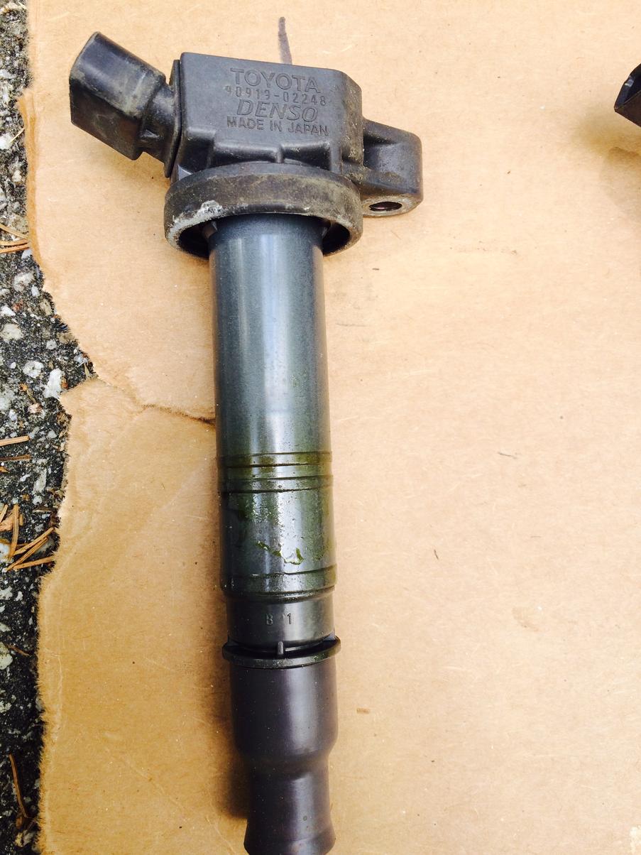

I know this is an old thread but I am hoping you guys can help.
I changed my spark plugs this weekend on my 2004 Sport V6 with 133k and I noticed that there was a small amount of oil on each of the coils, about half way up the plastic part (see pic below). I am thinking that this is due to a leaky valve cover gasket like the OP was experiencing. I check the oil regularly and have never noticed any significant loss of oil between oil changes.
1. Would you guys agree that this is likely due to a leaky valve cover gasket?
2. How urgent is it that I get this fixed immediately? Will this cause significant damage to other parts of the engine, etc.?
Assuming it is the valve cover gasket, I would like to try to do the repair myself to save the money. I am pretty confident I can handle it with the help/advise of some of the forum members here. The only thing that makes me hesitant is that I am sure that some of the bolts are gonna have significant rust. I bought the car used with 91k and had the spark plugs changed at 100k by a mechanic because the six bolts holding on the spark plug coils were very rusty and I didn't want to break them off. I had my mechanic replace those bolts but I have a feeling some of the other bolts on valve cover are going to be pretty rusty.
Thanks for reading, any and all advise is welcomed.

After I changed my plugs last night I found the same oil leak. I will be doing this soon. I've already some experience with taking the intake assy off and it wasn't particularly hard. Plan to replace all bolts I can as well.
Yes get inch pound torque wrench and be careful, as stated bolt B is inner 3, bolt A is perimeter bolts. Instructions read " Tighten the bolts and nuts uniformly in several steps."

WHOA! Hold it! You will break those valve cover bolts. I'm trying to send you the FSM page but that 137 Kb limit is way too small. "Bolt B" are the 3 bolts in the middle. You are supposed to put "seal packing" on the timing cover joint also. I assume that is an RTV or gasket maker.
Torque: For bolt A
10 N*m (102 kgf*cm, 7 ft.*lbf)
For bolt B
9.0 N*m (92 kgf*cm, 80 in.*lbf)
For nut
