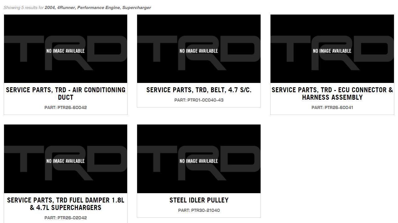

TRD Supercharger Brothers. Needed a new belt and just found out toyota part # ptr30-17433 is no longer available.
What are you guys doing or getting equivalent belt from?

I purchased mine from TRD shown in the first picture. You're correct, 70mm is 2.75 inches. I would bet the length is closer to 2,630 mm.
Please post when you get yours measured.

Reviving my old thread - still chasing this issue of getting a belt. Dealer is of no help, Found few online options to purchase, but order gets canceled day or two after placing it.
the belt I bought at 2616MM which was supposed to be a match is too short.
Any one out there have any intel.
Thanks
