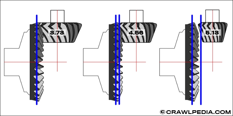

The only consideration for 4.88's vs 5.29's is that the 4.88 gears are going to be stronger since the ring gear doesn't have to be cut as thin to fit more teeth.
The 5.29's have more teeth engaged. Show me one scientific test that proves 4.88's are stronger then 5.29's. It's been an age old wives tale that no one has ever verified to my knowledge. I looked a few years ago and couldn't find anything other than message board arguments with no evidence either way. lol
Size Matters | RANDYS Worldwide
This article seems to say that 5.29's have less teeth engaged compared to something smaller.
This one says:
"Unfortunately, the trade-off is that numerically higher ratios become thicker and therefore heavier. As the ring gear gets thicker, it becomes stiffer, and therefore deflects less. But as the ratio gets numerically higher, the pinion becomes the weakest link anyway, as it becomes smaller in size. This is why most vehicle manufacturers use a stronger grade of steel for the pinion as com-pared to the ring gear."

It's more the depth of cut and than the thickness of the tooth from my understanding. You start with the same thickness of metal for either sized ring gear. Then, the ring gear teeth are cut deeper, since logically they would have to be in order to fit less teeth on the larger 5.29's. For instance, Nitro gears have 37/7 on their 5.29 and 39/8 on the 4.88 (ring/pinion). Since the angles of the teeth are generally going to be the same this would mean to space them properly you would have to cut deeper on the 5.29's.
