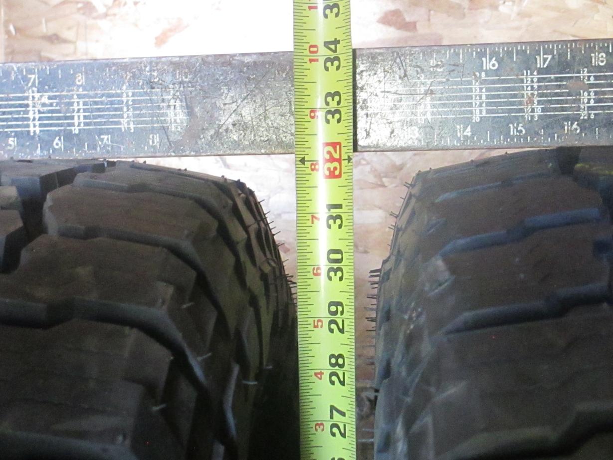

You just can't trust tire manufacture specs anymore . Here's a set of brand new ,unmounted Falken 285/75R16s . Apparently 33s are the new 32s. falken tires.jpg For what its worth my maxxis 255/85s were 33 1/8" tall when new and those Toyos are supposed to be 33 1/2'' .
That implies you could trust them up too a few year ago. Not the case. You can dig up articles from the 80's about tire size being a little small. Like I said upthread, there in no standard to adhere to in the industry. Change that and it will level the playing field. Not enough people actually care to do anything to affect that change though. lol

Yeah, I remember BFG's old 33x9.5 was just a little over 32" tall.

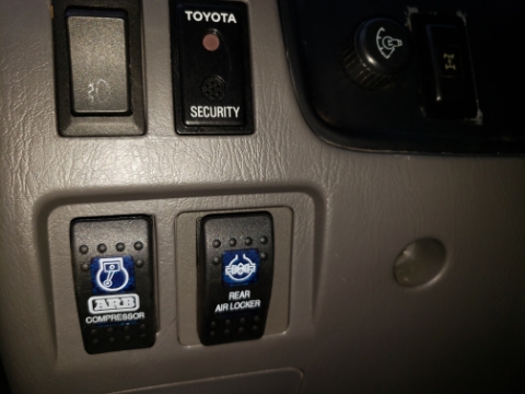

Well... I have had it for about an hour now. LOL. 4.88s with rear ARB. I am pretty stoked. I am about 55 miles into my 500 mile break in.

No burnouts yet. LOL. I went to a local guy, Nils Bull, here in Washington that just does diffs and was an ARB tech for around six years for them before starting Bull Built Differentials. He knows his stuff and is passionate about his work. He was happy to go into great detail the difference between getting it done, and getting it done right. Besides using solid steel spacers, he also utilizes upgraded shims to ensure to ensure the best possible job is done. He also stands behind his labor for 5 years. Two of my other friends have had their gears and locker done through Bull Built and are happy with his work.
He did a great job plumbing the airlines from inside to out and everything looks top notch.
