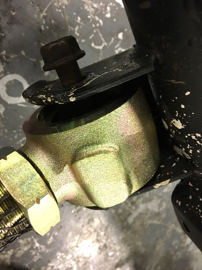

Here’s the upper joint; the factory mount is almost wide enough to allow it to flex, but way too shallow. Without clearancing/removing the rear wall, any flex just stretches & eventually tears the rubber center of the joint.

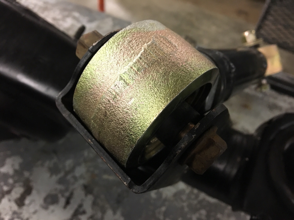

And here’s the lower; the factory mount is almost deep enough (needs to be clearanced, as above) but it is really 6mm too narrow to make full use of the joint. - which may not matter with the stock setup, possibly..
Interesting tidbit: I realized mid-way through drawing the upper link tower that the joints actually need a 3mm spacer on either side to realize their full range of travel...!
