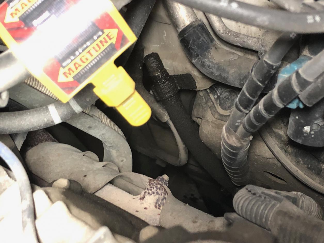

Little chilly today driving home and Mr. Hilux was stiff as well. Did an inspection this evening and noticed some gear oil (2 tbsp worth) on the ground and on my LCA's. Followed it up to my engine bay and noticed my breather is full of oil.
First time this happened, Anything I have to worry about, should I replace anything?
Thanks folks!

Ruling out moisture or water contamination of the gear oil.May be the extreme cold froze the internal seals of the diff breather plug causing pressure and the leak. As a precaution I would change the gear oil and the diff plug when possible.

At the temps you guys are experiencing it's possible that not only moisture/water can freeze in the diffs, but if you're running old, low cost brand gear oil it's likely not operating correctly. Could explain any sluggish feeling in the mornings as well as cause the oil out the breather.
Additionally, if you know what brand gear oil you are using it might be worth while to go look at it's normal operating specs.
Theorizing here. I believe gear oil can get very thick at those temps, almost gel-like. So I'm wondering if a glob got slung up into the breather hole early (especially if you didn't start out slowly), then as the diff warmed up, the heat/pressure pushed it up the tube and out? I remember seeing pics many years ago when a can (yes, that long ago) of 20W50 was opened after sitting in -60 or so temps, and the oil sort of slid out of the can in a chunk. Maybe -40 does the same thing to 80W-90W gear oil.

looks like this has been going on for a while since it has dirt on the gear oil vent . I have had this happen .. when in 4wd in snow storms driving for 20-30 miles I had this happen.
drive the vehicle for several miles then check the gear oil ..
I check it when the vehicle has operated ... gear oil does expand when heated.

This has come up a few times in the past. I've had it once too.
Common theme seems to be you do a front diff drain and fill, then the first time driving for an extended period in 4wd this happens. In my case it was a couple hours in 4wd at 50mph. Only happened the once and never again.
May not be the same in your case, just rehashing what came up before. Consensus seems to be just to wipe it up and drive on.
