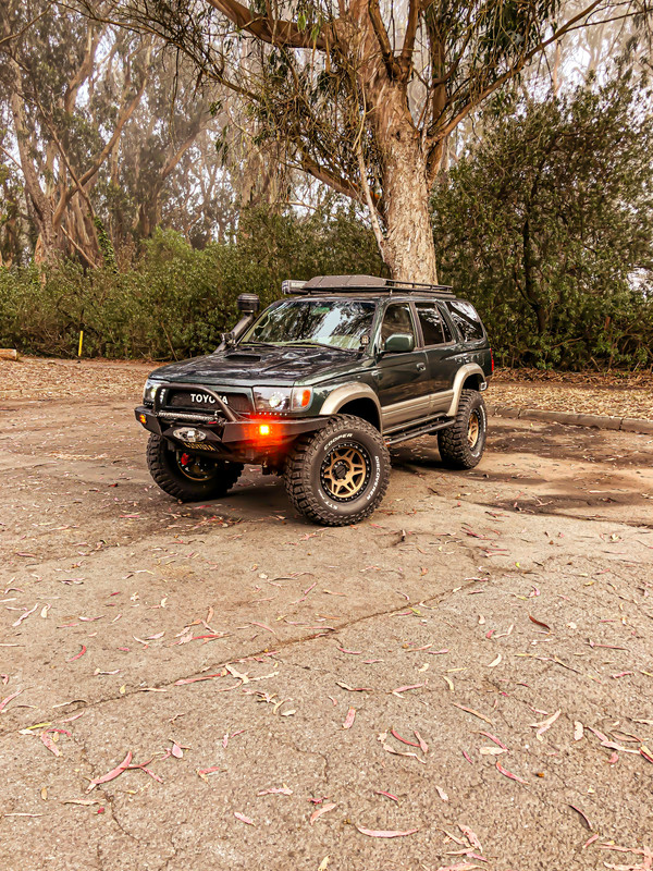

How it sits today(185k):

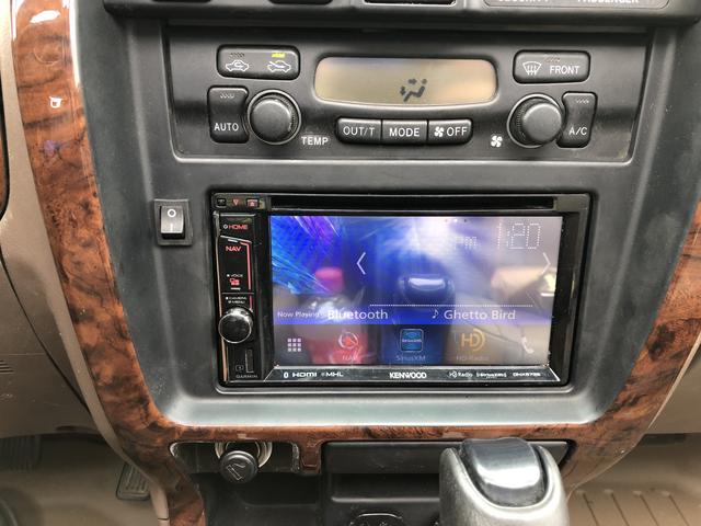

Changed all the gear oil to redline today. Finally finished installing the LBJs, UBJs, OTRs, CV’s, wheel spacers, and steering rack bushings today as well..
Tomorrow I’m going to finish installing my radio and take it to get smogged.

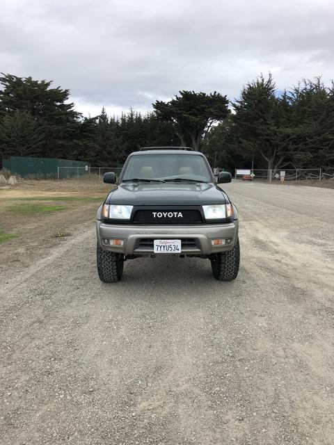

Welp just got the smog done, thought I was going to have to come back because I had the battery disconnected. Got a couple pics real quick while driving it around. When installing the radio I installed a switch for my antenna (I never use the radio..)

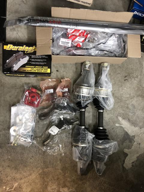

Got a few things in the mail, also a few things that I’ve already installed.

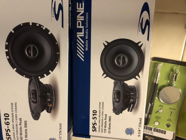

Not going to install an amp, stock speakers suck..

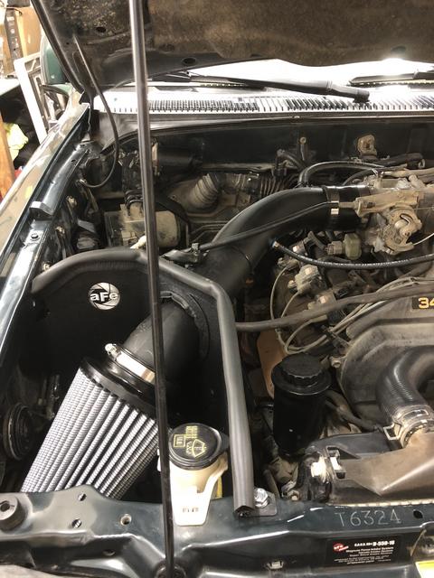

AFE intake.. might switch to the air raid tube with stock filter box, not sure..

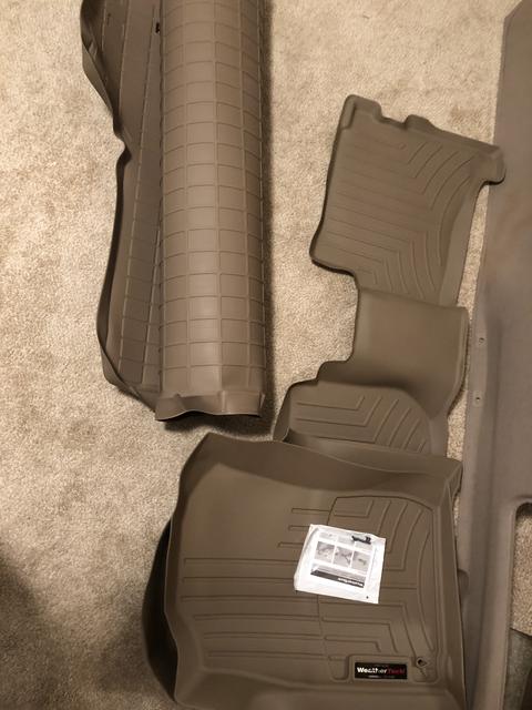

Gotta love weather techs, have them in all of my vehicles..

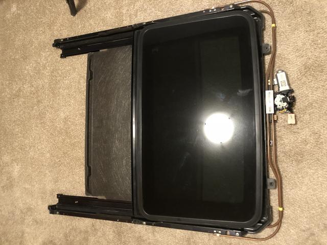

Moonroof out of a 97 limited part out..(works great!)

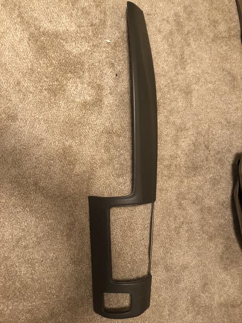

Dash ‘crash pad’ out of that same 97 part out..

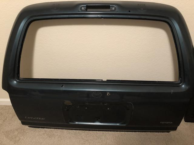

Rear hatch out of same 97..
