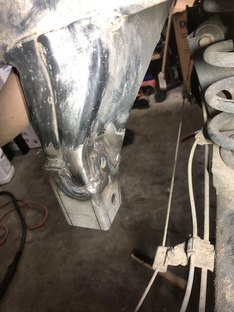

Installed my eimkeith pck brackets yesterday, definitely makes a huge difference in drivability. Welding wasn’t perfect but it’ll hold on there nicely.. Also started installing my ARB breather kit. For now I’m just going to connect my rear differential but eventually I will connect the front diff, transmission, and transfercase breathers as well.

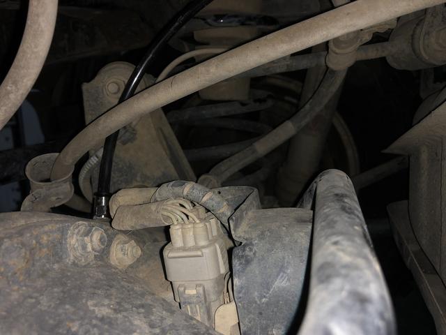

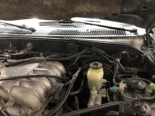

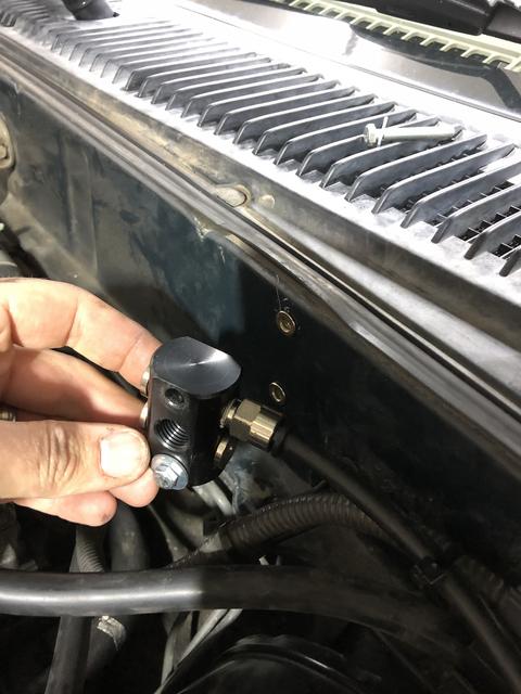

Here’s the ARB diff breather, it has 4 ports so you can run up to 4 breathers to it. Took a lot of thought of exactly where I wanted it before I ended up putting it there.
I followed the parking brake cable with the line until it disappeared into the cab then I followed the fuel lines up around the master brake cylinder. I tried to leave a semi decent amount of slack where I could. It’s definitely a really nice kit, especially if you plan on doing the other breathers too..

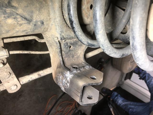

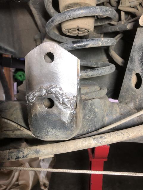

Eimkeith brackets with welding by none other than T4topher himself.
Only weld I ended up grinding down.. it was ugly AF lol.

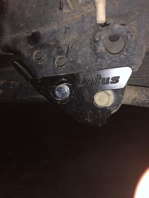

Lotus rear LCA skids

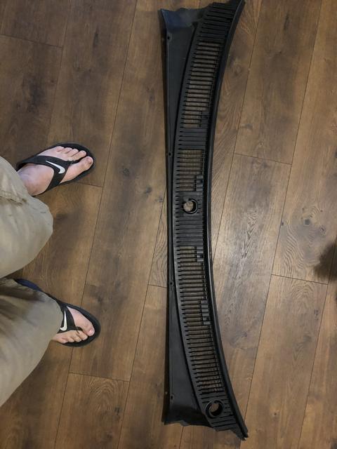

Well I decided to rivnut the arb breather and remove the sheet metal screws for a more ‘factory’ look. Also mounted the bracket for my fuse box today (yes with rivnuts). Restored the windshield plastic piece with my heat gun, came out great except the small plastic grid melted so I just cut it out.. I think it actually looks better without the grid.
Before
After
