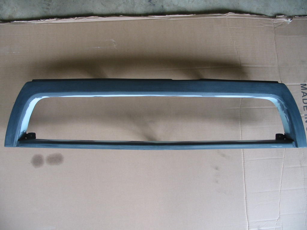

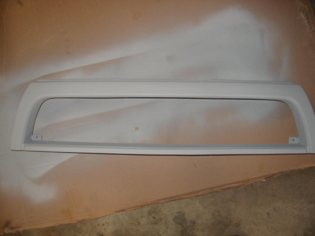

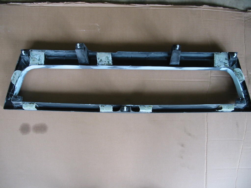

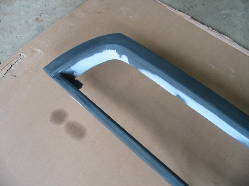

Got more done on the grill, sorry for the crappy pics. I need a new camera

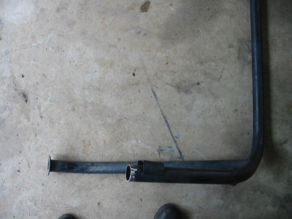

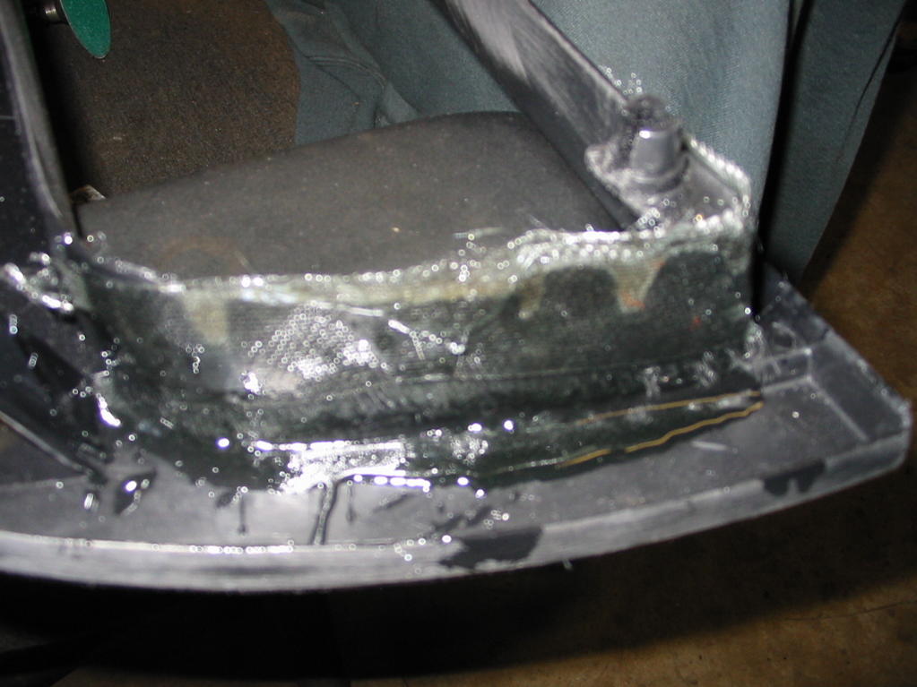

Started on the roll bar as well, picked up a tool box from craftsman that I'll add to it.

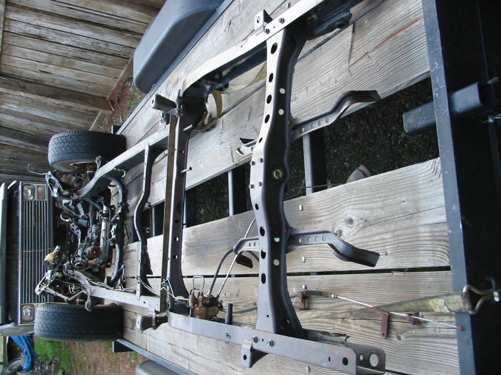

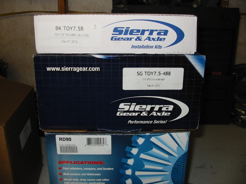

Also picked up a few more parts, front and rear ARB's, 4:88's, and a tacoma frame and front susp. I'll take the 3rd out of it and send that in to get the gears and lockers put in.

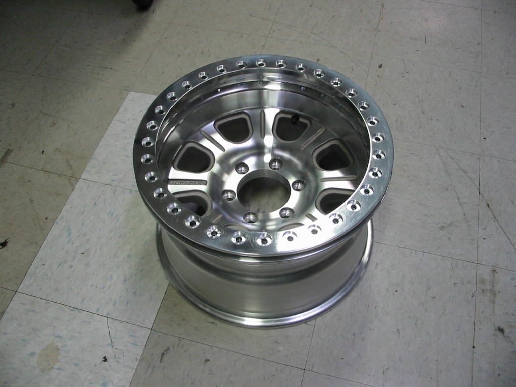

More parts showed up today, I hope they fit...:naughty:

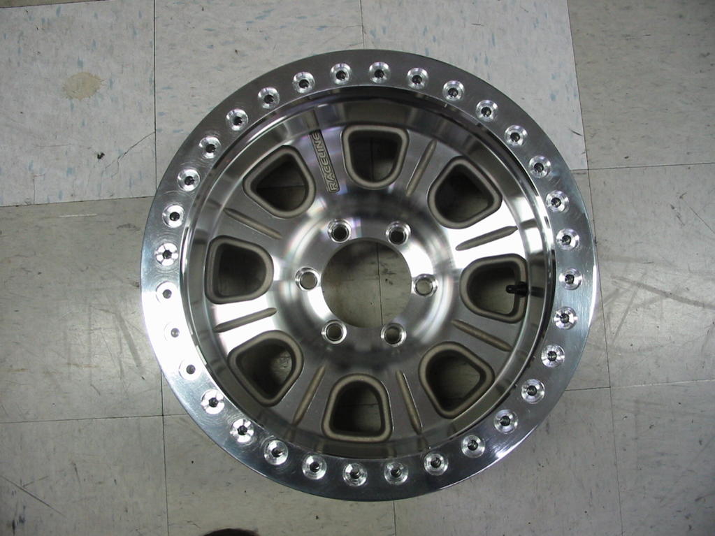

What are the specs on the wheels 17x9.5 with 4.5" backspacing? I really like mine so far.
They are 17x9.5 with 4" backspace. I'm not sure if they're going to work. I read your build and I like the way yours look, I think these might be to wide. Yours are 8.5 wide, correct?
Yes. I had originally ordered mine not powder coated (like yours) but apparently the mold for these wheels in our bolt pattern and 8.5" wide is out of commission and will be for a long time to come. I got the last peace'd together set of these wheels in our bolt pattern and 8.5" wide. They offered to get me the 9.5" wide ones but I just didn't feel that would give any bulge to the side wall. Either way they make a great product and I hope they end up working out for you.
Keep up the good work I can tell I'm going to dig this rig.
Well that sucks, I was going to check into getting a set of 8.5's. I'll make these work. I got such a screaming deal I couldn't pass them up.
Your running 35x12.50's?
My Camburg UCAs should be here today....Or at the latest tomorrow. Thanks to Dan at Wheelers offroad.
Unless the 3rd out of a Taco is a TRD, you're not going to fit it into the 4Runner.
Tacoma's use 8.4" thirds, and 4Runners use 8".
Ask me how I know....
(Look at my build thread.......)
8.4 In the front?:confused:
Guess I misunderstood. Thought you were taking the rear third out and putting it in. I've always heard the "3rd" as the back diff. the front has been the "front diff."
The front diff will be the same. Sorry. I'll shut up now. :embarassed::frusty::rockon:
No worries, Ya had me going for a minute there...
Yea, I picked up a taco frame and front susp. So I'm going to re-gear the taco front diff to minimize down time.
Picking up my front ARB and gears tomorrow. I'll drop both diffs on Friday and hopefully next week I'll get both front and rear back done. I'll add those to the pile of parts. So just a few more things and we'll get this party started.
I can't blame you. You won't be disappointed. And yeah I'm running 35x12.50's.

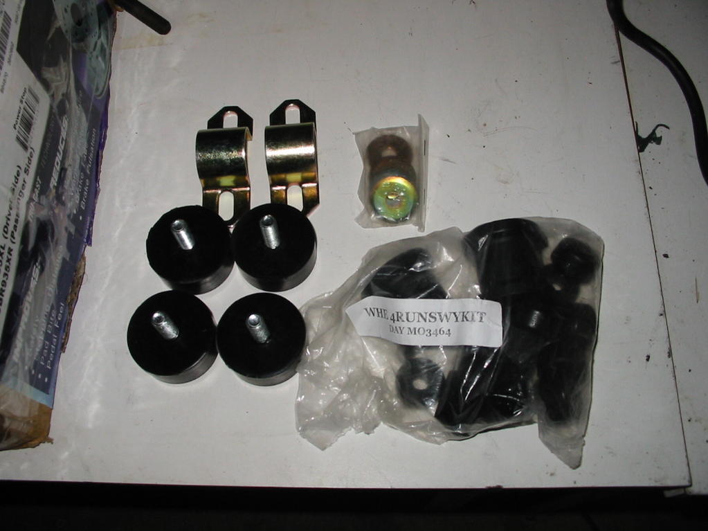

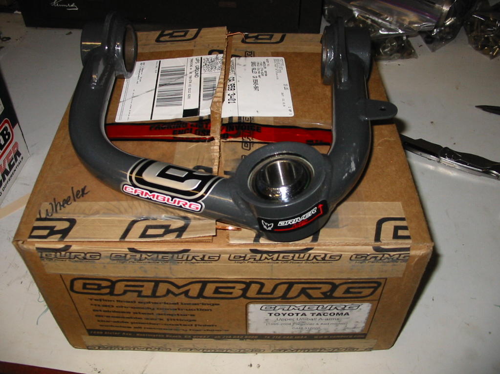

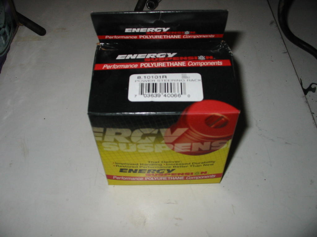

More parts....Picked up my front ARB and gears, sway bar bushings, rack bushings, and UCA's

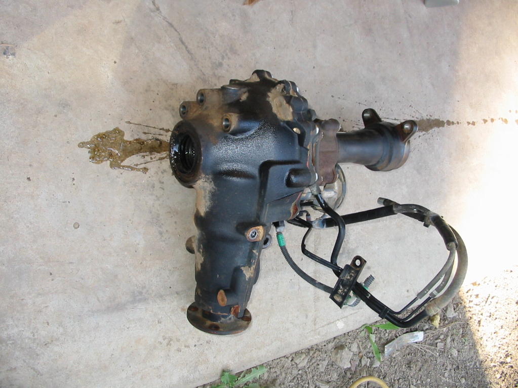

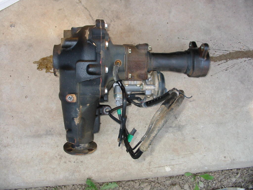

Got the front diff ready to go to the shop to get gears and the ARB installed.

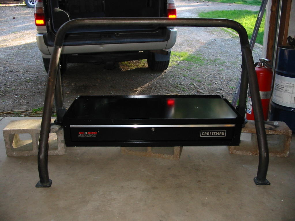

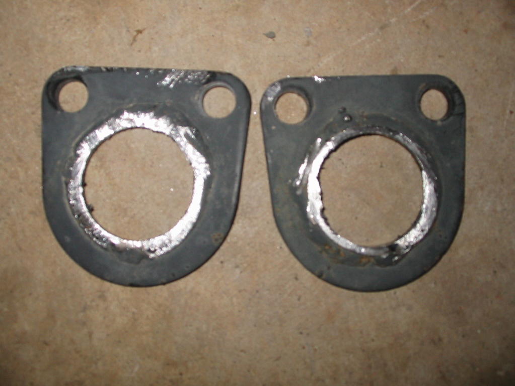

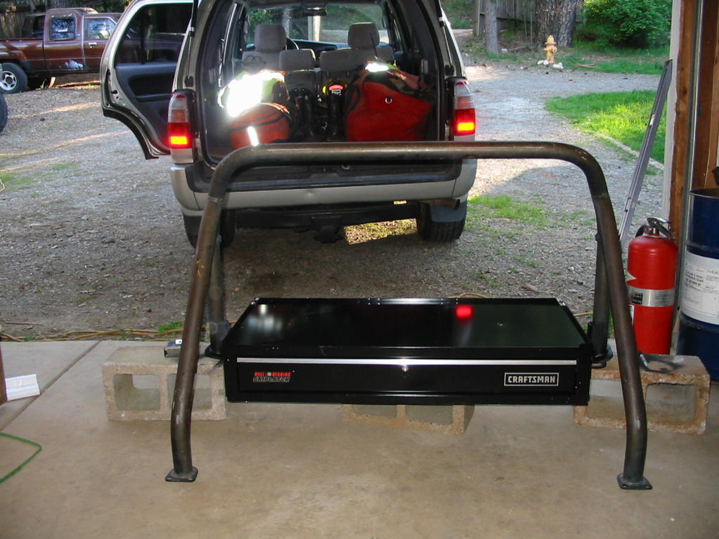

So I spent a little time the other night on my rollbar. I got new mounting plates made, and welded on. I started to mock up the location for the tool box. It's a few inches low in the pictures. It'll come up 3-4 inches. That will give me enough to build a storage basket on top.
That's a good sized box for the back of a truck. I'm sick of breaking all of my handheld boxes in the back of my truck. Mind if I ask what model it is?
Looks good man, waiting to see your basket.
