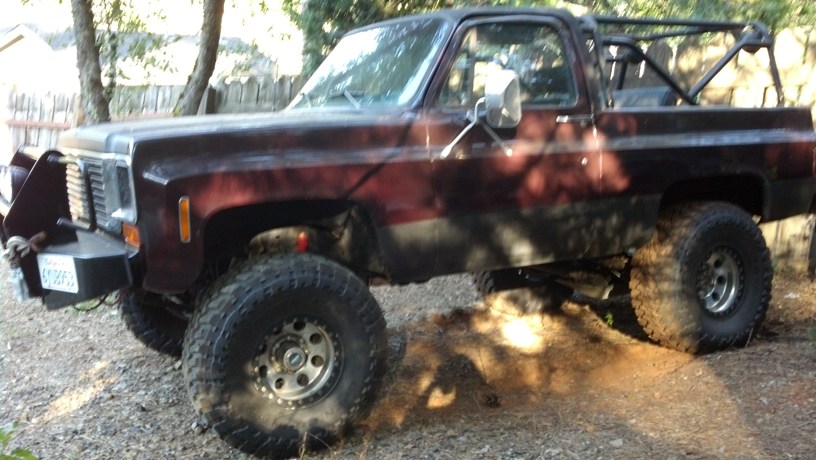

LOVE the old Chevy. A '74 K20?
77 K5 Blazer, 502 BBC,Th400,205. Dana 60 4:10 ARB, 14B disc brakes Detroit.
12k warn winch, OBA, OB welder, 43 gal fuel cell, 38" toyo's on Champion bead locks. Rancho 9000 adjustable shocks on all 4 corners.
Did I mention....Its for sale....!

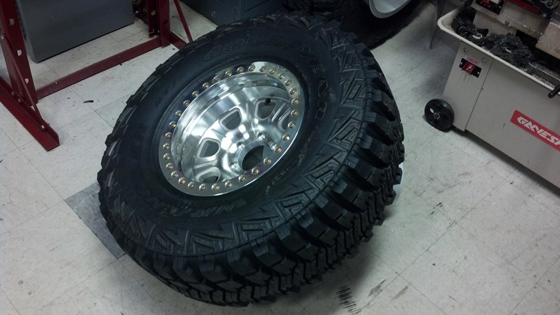

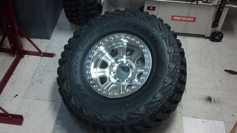

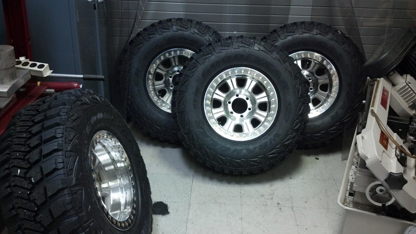

The 35's came in.

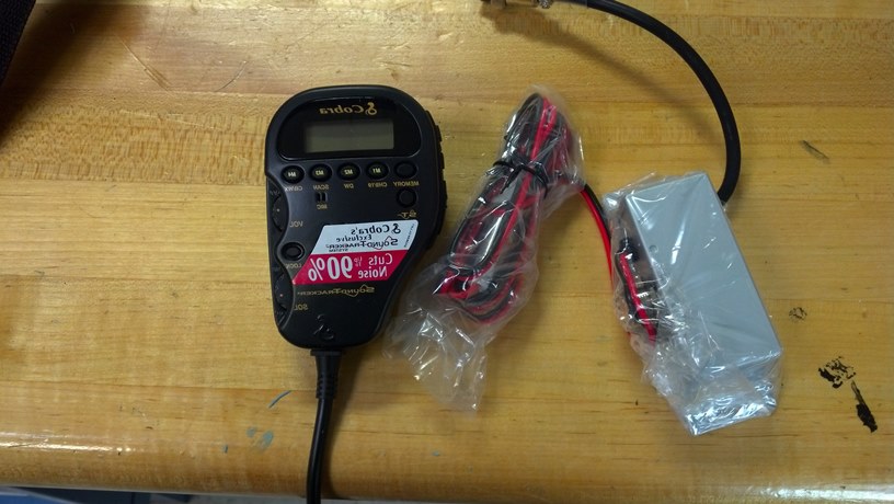

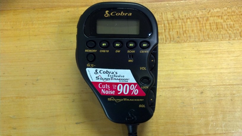

Picked up my CB, I thought it was neat... no head unit it's all contained in the mic. All you have is that small little box to mount somewhere

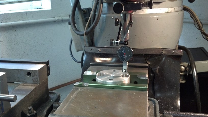

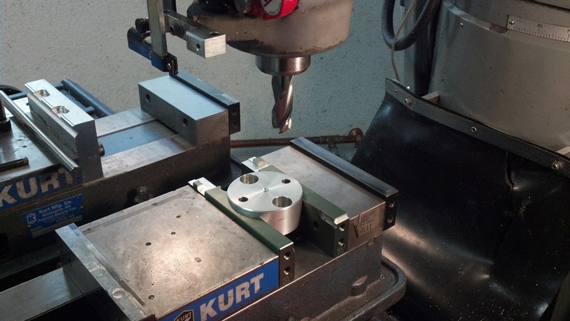

Had to do a little machine work on the steering shaft extension, it wouldn't fit flush.

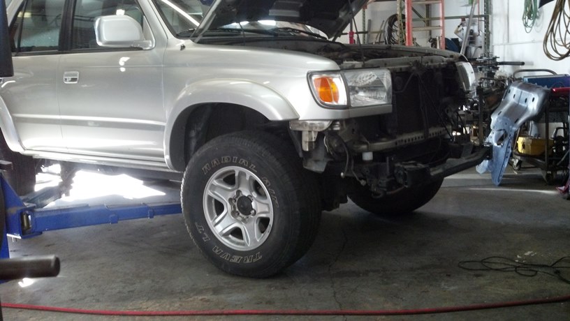

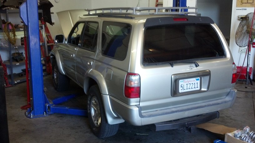

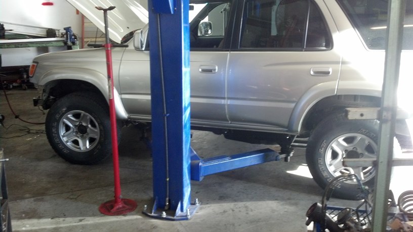

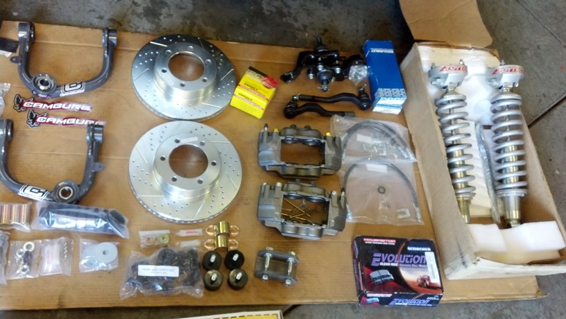

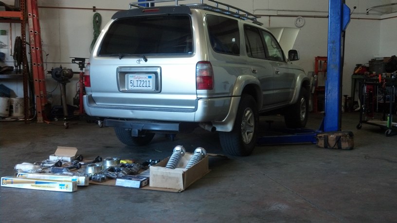

So this was the weekend to get things really started. Thanks to my brother in-law Ben who owns NC4x4 (Nevada County 4x4) for letting me use his shop. Also a big thanks to Nate for putting in a lot of hours with me to make this come together.
We started on Friday afternoon with a pile of parts. And a stock rig

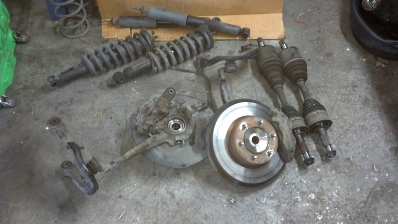

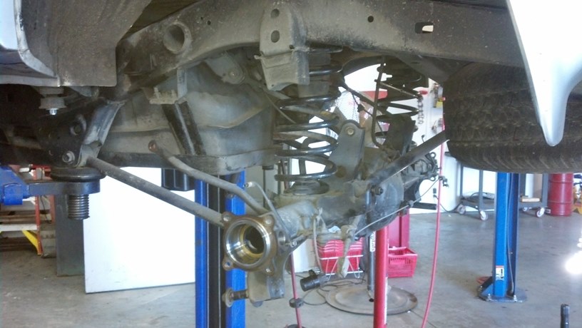

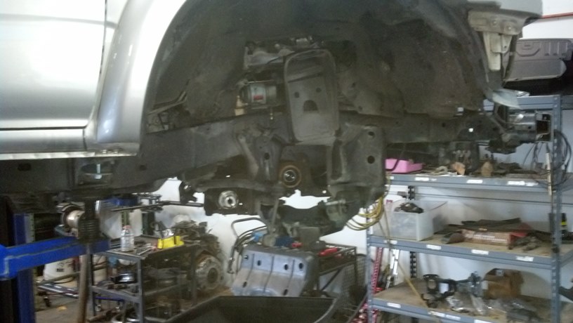

From there we tore off all the stock parts

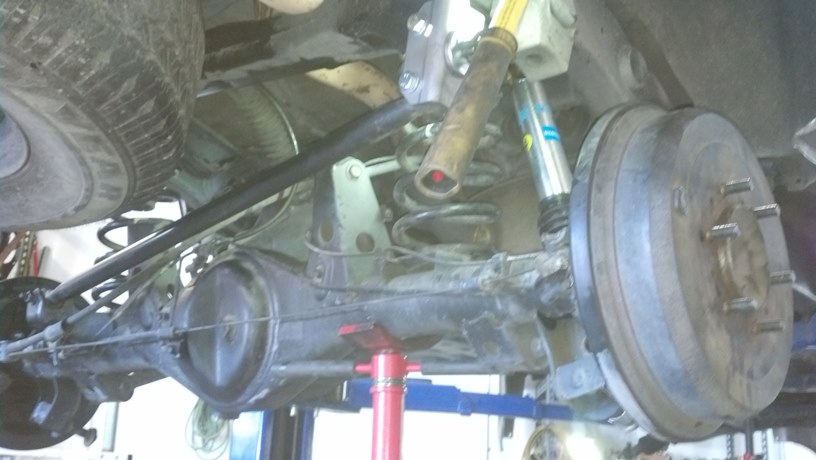

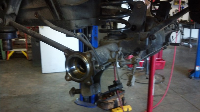

Got the rear springs, pan hard drop bracket, new seals, and shocks, brake like on

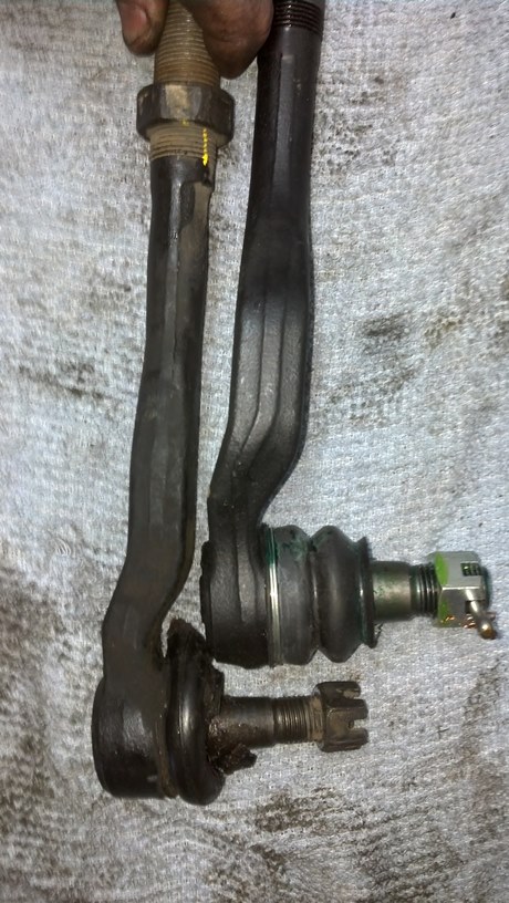

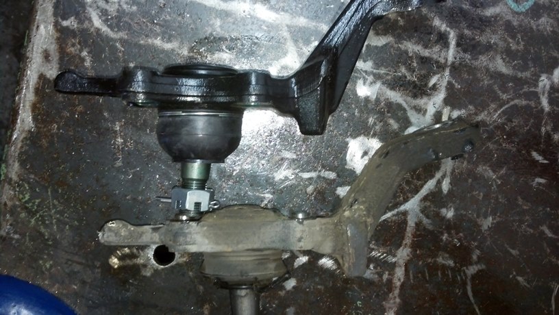

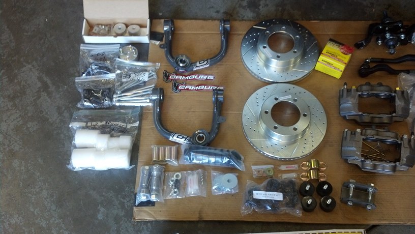

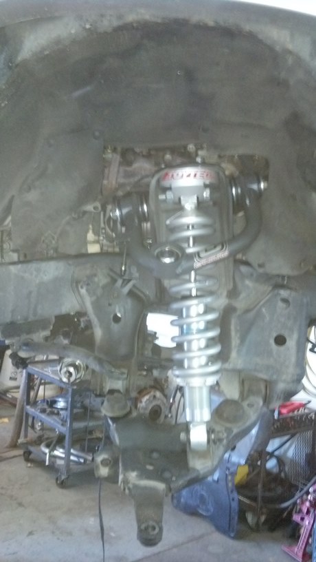

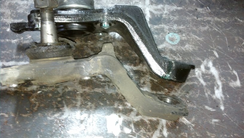

Started assembly on the front. I ordered lower ball joints and outer tie rods for a Tacoma...Look at the size difference. The taco parts are quite a bit bigger. The tie rod shank is surprisingly bigger.

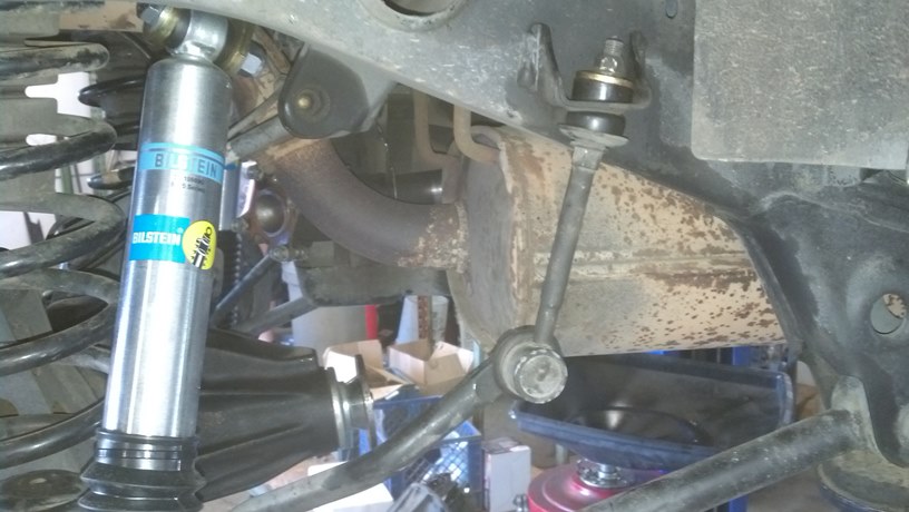

Once the front susp was off I took the front sway bar end links off, put new bushings on and moved them to the back.
